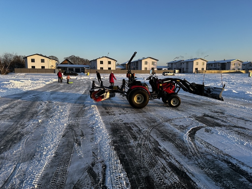

I have the same tractor, just 230 h and have not jet done maintenance 😁
We have -20 C / -4 F
No problem at all.
In such cold during warm up it kinda "smokes", but that is just condensed water from warm exhaust gases. In other words - chemtrail :ROFLMAO:
Do you heat glow plugs ?

A broom in snow, that would be perfect for the stuff falling right now.
   / Starting procedure. #7
Yeah. :cool:
Actually now blade works rather bad. Even there is nylon wear part, blade makes creepy noises, there is excessive friction
But broom makes wonders. Even with single pass nothing but bare pavement
