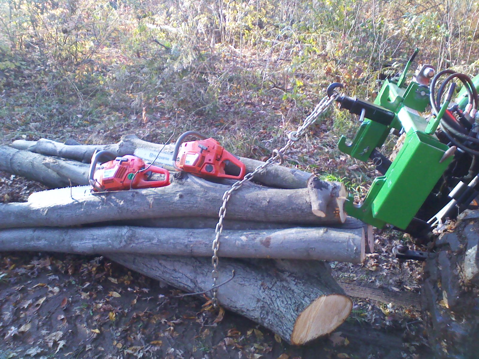

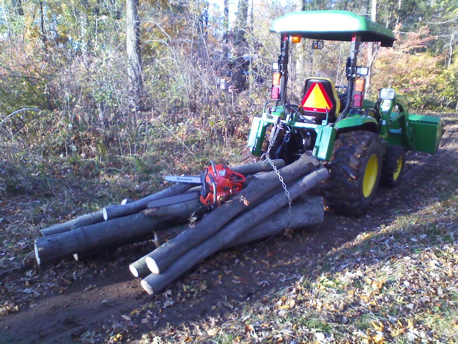

I got it, I think this will do it for you.
Grade 40 Clevis Link w/ 4,400 lb. WLL - 5/16 in. | AW Direct
I've got one on a couple of chains, 3/8" and 5/16" also great for skidding a log as they cinch up tight like a choker.
I'll measure the 5/16" one to see if it will drop on a 2 inch ball.
They call the 5/16" one G40 4400 WLL. but that's only 300 pounds less than G70 5/16 chain.
The 3/8" one will easily fit 5/16" chain and that one has a 6600 WLL and has a bigger throat.
You can see it in action here, this is the 5/16" version.

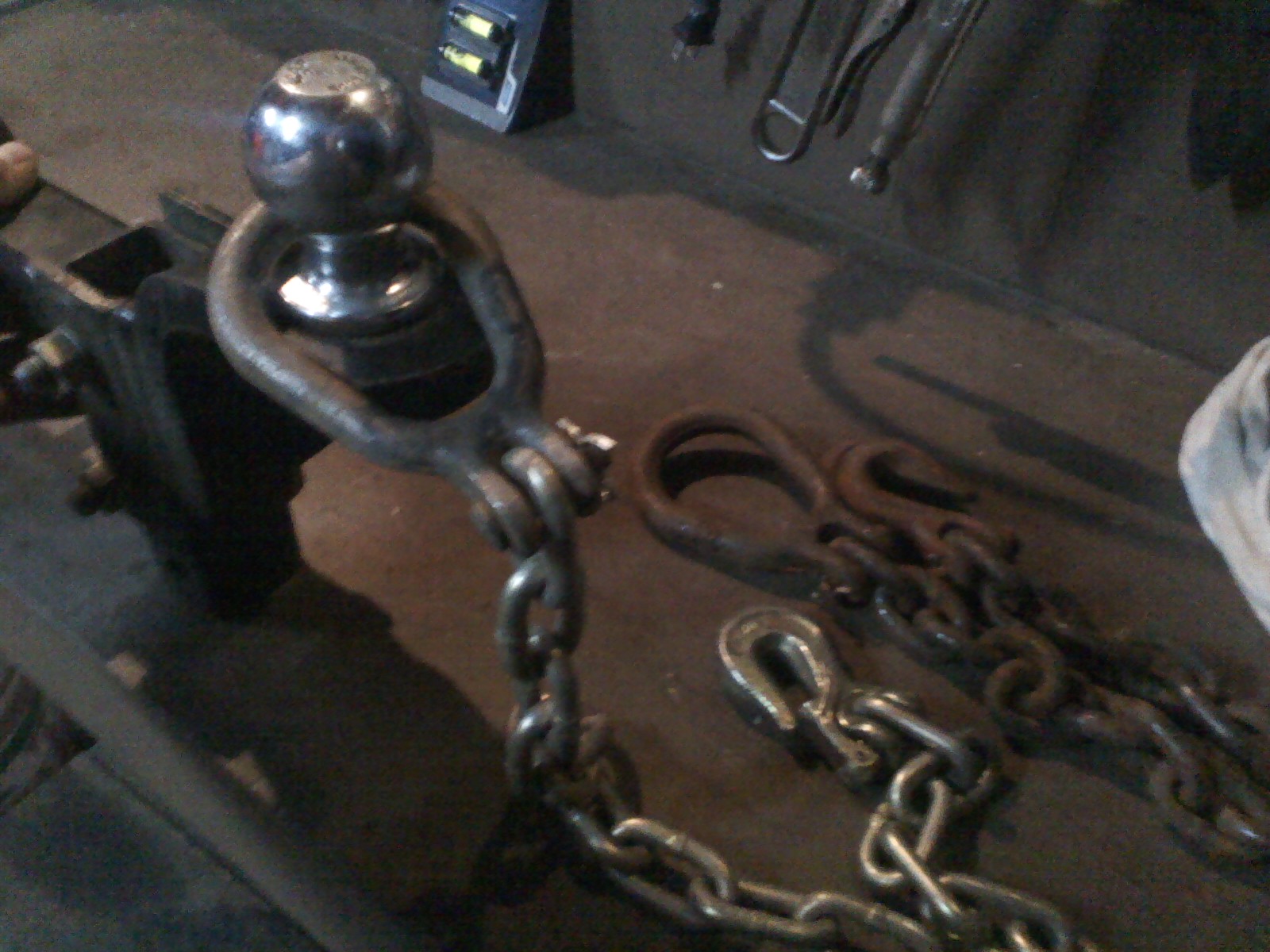

   / Steel loop/hoop for a tow chain; where can I get one? #9
The clevis link slips over a 2" ball easily, but not over a 2-5/16 ball.
The 3/8 and 5/16 are the same size, only thing different is the 3/8 is thicker, I thought it had a bigger opening but it doesn't.
I keep the clevis link chain on the tractor at all times with a grab hook on the other end. you can see a latching grab hook in the pic, also from aw direct.
The clevis link is perfect for tractor pulling tasks.
