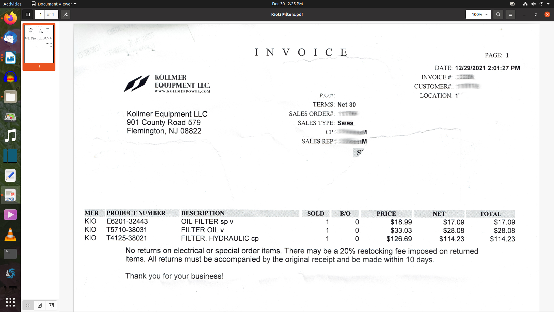

I went internet shopping for the filters for my DK4710. Must have wasted an hour.
I paid way less at my dealer than I saw anywhere online and I didn't pay for shipping.
   / Stupidly convinced I'd get a better deal #2
Painful invoice !
My oil filter is a standard Purolator Ag type. $8.
Hydraulic filter is clean and reusable $0
Air filter is a tad pricey at $26.10 (cleanable for up to 5 years, then replace)
Now here's a HUGE tip. DO NOT SHOP around using a Smarty Pants Phone. It's all smoke and mirrors getting you to keep looking and to PAY MORE. I went back to the laptop and can reach many other sites at great prices plus free shipping to avoid the games used on smart phones.

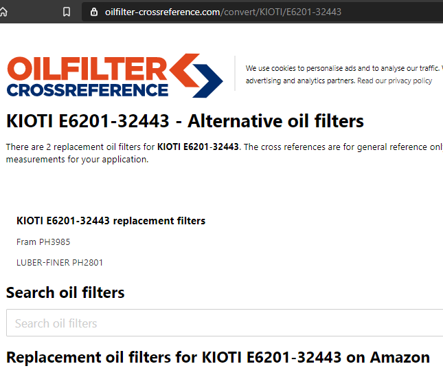

hmmmm
So, I went to oil filter cross reference website, keyed in the first oil filter and got this.
Basically it's the SAME filter used in my minivan and truck. About $6 to $12 depending what store in town you have.
Can't find the 2nd one other than a mention of the p/n replaced 3 of the Cub Cadets that used the SAME filter on the SAME engines. I wonder if that is a CLUE for WIX, DONALDSON, FRAM and other big brands that do cross reference over. Seems Kioti is keeping the number from cross referencing to keep the markup cost high.
Here's the Cub Cadet p/n's
dd-t4620-38031
dd-t4620-38032
dd-t4620-38033
Take the dd- off and search. ;)

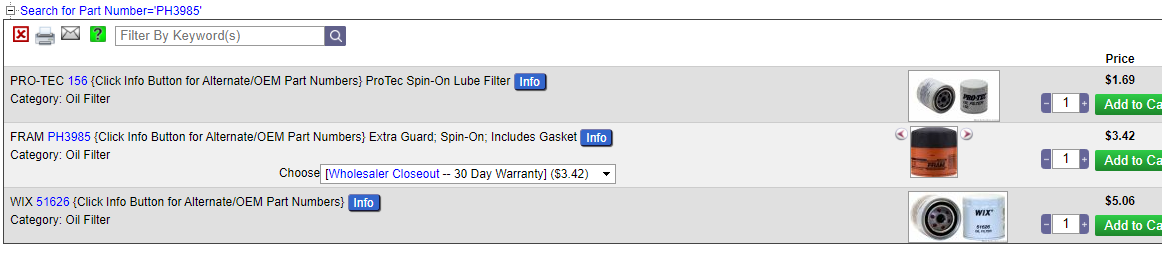

So, going to Rockauto.com let's look at that PH3985 and see how well of a cross reference we get for your
E6201-32443.
Pro-Tec is owned by WIX. We can look at all of them. Just click on the blue [INFO] icon.

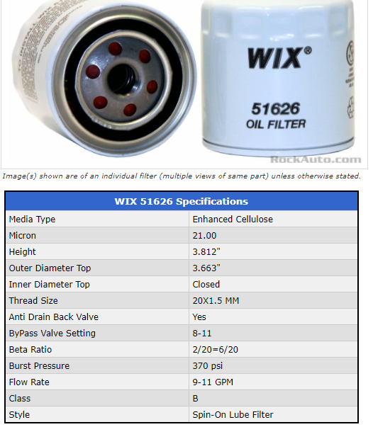

And the WIX

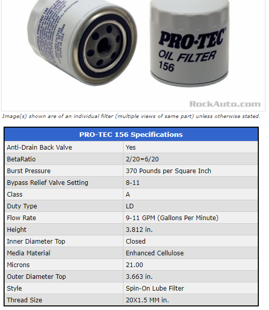

And the WIX rebranded Pro-Tech

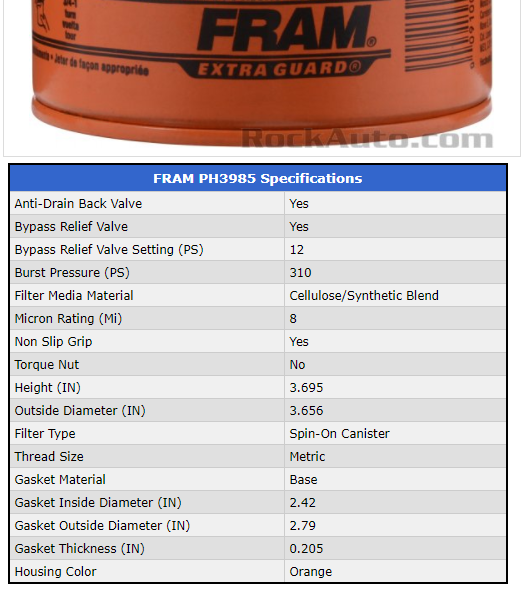

With all the details above, the FRAM is a no-no because the micron rating is too fine and the flow will be much slower in the engine. The engine will starve for oil circulation.
The WIX is class-B (Better) and the Pro-Tech Class-A (Best). So, Pro-Tech is your best all around great replacement as the E6201-32443. :)
