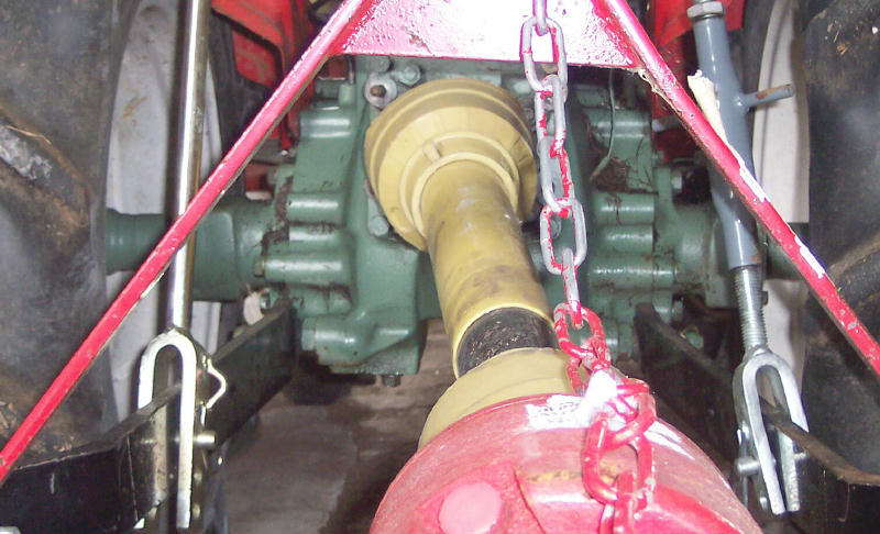

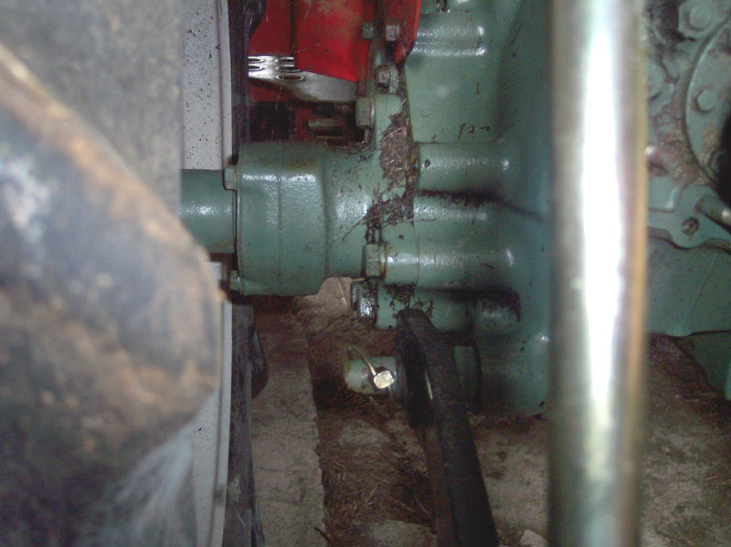

Hi, I have a Yanmar YM1510D and need sway chains on my 3ph. Without them implements sometimes hit or even get stuck in my rear tires. Apparently there is nowhere to attach them on the 1510. Hoye tractor used to sell adapters for this model for sway chains but does not know when he will make more. So I'm kind of stuck here (literally sometimes!) I'm really not sure how to go about attaching them on my tractor. I know one end attaches to the 3ph, but where and how should I attach the other end to my tractor? I am hoping one of you innovative people can help me out. No one on the Yanmar forum has responded with how they got them on their 1510.

Take a look at this picture and see if it might help, it looks different from yours but there maybe something I'm not seeing.3 point hitch
   / sway chains
Yep, I don't have those places to attach the chains to my tractor. I don't have a drawbar either. I have discovered the 1510 is something of an oddity in the Yanmar line. I bookmarked that page though to see if I can make something like that. Thanks for finding it. That's the best picture I've seen of the 3ph on a Yannie.

Can't really tell from your photo but it looks like there is a flat mounting surface on the bottom of the rear housing. If so a couple of pieces of flat stock bolted on them with a mounting hole for the chains would be an easy fix. Or just a chain mounted to a bolt under there.
   / sway chains
I'm not sure I can bolt anything to the rear housing. If I were to drill and tap for bolts, wouldn't I penetrate too far and have diff/trans fluid coming out? I wonder if a drawbar could be welded on?

   / sway chains #7
Roxy, I think you need to crawl under your tractor and see if there isn't already four holes drilled and tapped into the housing. I'm guessing there is a bracket that can be added to install a fixed drawbar sticking out the back like most tractors have. I'm including a picture to show what I mean about a fixed drawbar. Anyway, you could use those existing holes to do as Barry said and have a bracket made with a drilled tab sticking out the back on each side to fasten a chain to. Then fasten the other end to the lift arm of course.

If I were doing it, I'd want to pick up at least two bolt holes with a plate, then hook a chain to the plate. I think you'd put a lot of stress on one bolt in the diff housing if you just attached to one bolt.
Likely, it would be ok, but I'd not want to chance tearing out the differential.

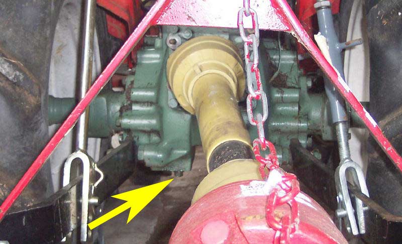

What is the Bolt with the Yellow Arrow pointing too??
If there is a Matching bolt on the other Side , or better yet , 4 Bolts down there to have a plate made. For Both Sway chain attachment and a Drawbar.

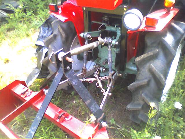

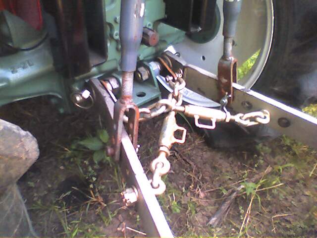

My 1602D is very similar, here's how I did it..........
