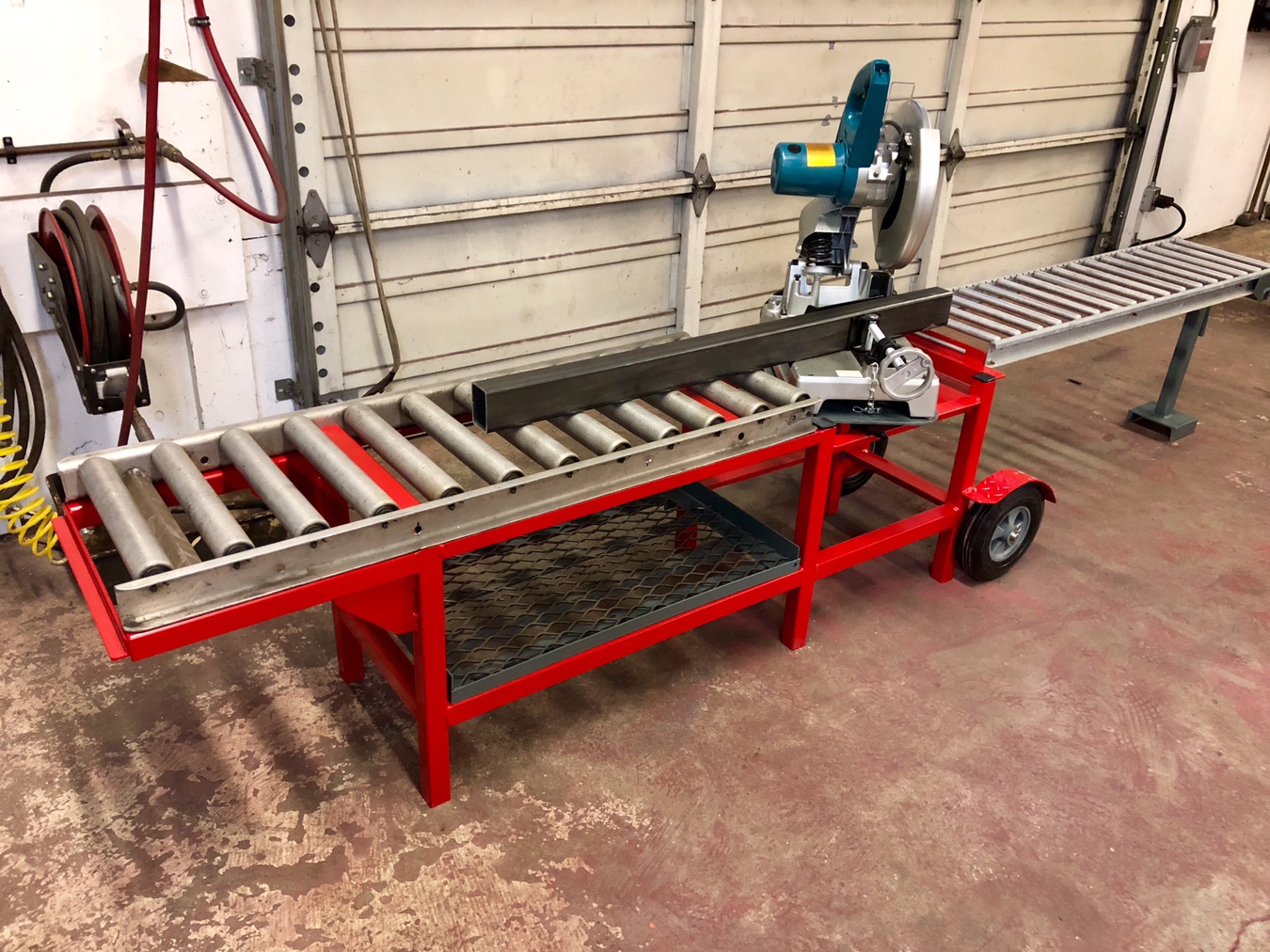

I managed to get a little shop time in this past week to build a mobile bench for my Makita dry cut saw with a swivel base to keep long stock parallel on the infeed and outfeed roller tables.
The outfeed table detaches and the remaining unit is moved easily “wheelbarrow” style.

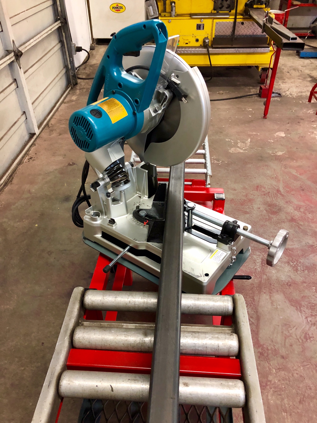

Wow lot of good looking work done in a short time.
Curious how you tie down the back of the dry cut saw. There are two bolt holes in front but the back is not obvious.

Seriously impressive. Where do you find those roller tables?

The back of that Makita has provision of one bolt in the left rear corner( inside the blade wrench “well”).
The front left bolt is missing in the picture as I realized I need to face an eighth inch off the bolt head in order for it to clear the swivel handle for the base’s swivel. I was going to chuck it in the lathe tomorrow but I think I’ll just take a grinder to it.
Thanks!

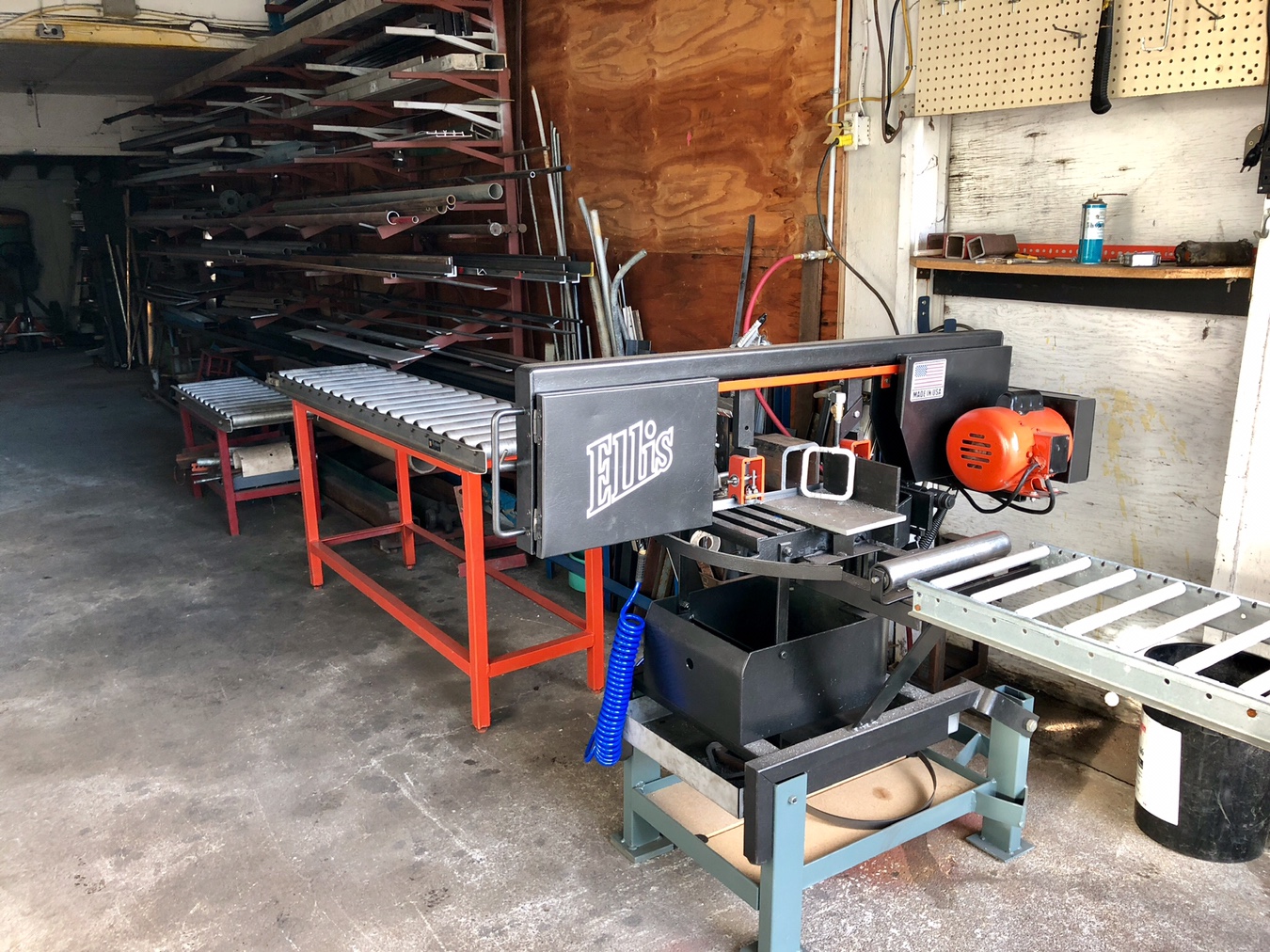

I was fortunate to find used sections locally several years ago. I’ve also use a few sections for my horizontal bandsaw.

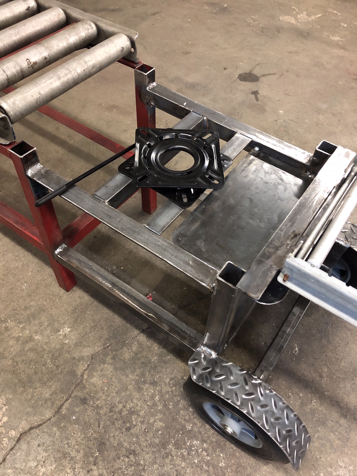

Seriously nice setup Terry, and timely enough so I can "steel" parts of it for the one I need to do for my new dry cut saw :laughing:
Any chance you got pics of how you did the swivel, lock, etc, for the table? Or, did you just let the table find its own "happy place" by the vise position/ cut piece? (Enquiring minds wanna know, saves brain cells :D )
Again, gorgeous work and thanks for posting... Steve
   / Swivel Base for Dry Cut Saw
#9
Here you go, Steve.
It’s a locking swivel for a boat seat. Found it on Amazon for around 25 bucks.
