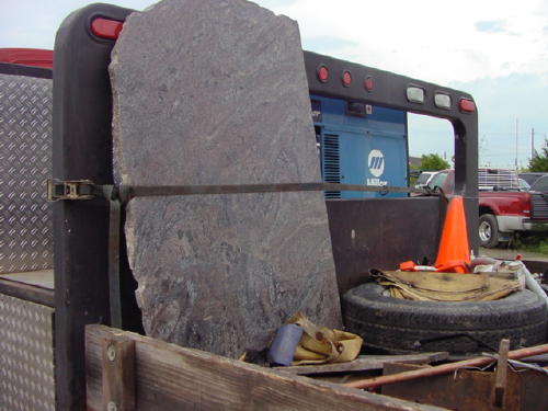

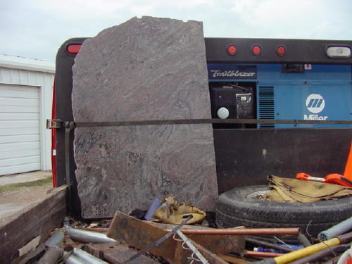

Yesterday I went to a bud's granite shop and picked up a rock for a table.
Yesterday I also picked up over a hundred feet of one inch schedule forty pipe.
Today between showers I'm going to hopefully start forging the pipe into shape for a small table and two stools.
The rock not only has beautiful grain but the colors match those in the room.
I'm using the pipe instead of solid stock for two reasons. First is it's fun to work with and not many people do. /forums/images/graemlins/blush.gif Second, the table is for a retired weldor who's got Parkinsons in a pretty serious way.
I'm starting off with a vague image in mind that will refine itself as we go along.

When you look at something as beautiful as this rock one has to be blown away by nature's beauty.
I hope we don't have any problems with breaking!

I see you didn't put this one flat on the bed of the truck /forums/images/graemlins/grin.gif

That is a beautiful piece of rock. I was born in Aberdeen, Scotland which is known as the "Granite City" (among other things) because so many of the older buildings were built out of granite. It was all grey granite, occasionally red, but nothing as pretty as your table top.
How are you going to finish it? I couldn't tell from the photo if it is already smoothe or polished.

The rock is a 3cm piece of scrap from a counter top. It's polished on one side. I'll cut it to shape and then have the granite shop polish the edges.
One of the amazing things about granite and marble is the colors and patterns that come out of the ground. The patterns will vary with the cut. Sorta kinda like the difference between quarter sawn and cross cut with lumber.

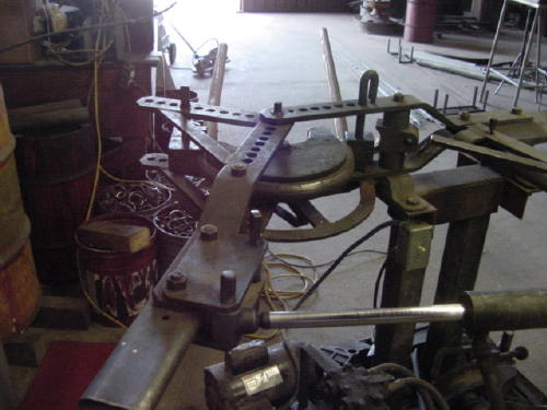

I've just about decided that the most important thing for a dream to have is a bushel basket of flexibility. Sorta kinda like us I guess. /forums/images/graemlins/smirk.gif
Originally I was going to forge the pipe into place. It would be more fun. A lot more work of course. And in the long run more original in design and finish.
But economies of scale grabbed me by one hand and common sense with time frame in mind got me by the other.
So I did some Hossfielding one oh one.

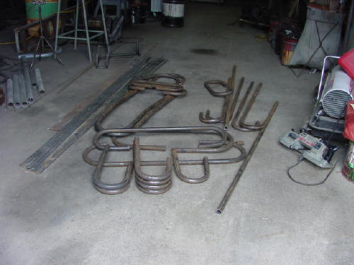

The Hossfield is the best friend a fabricator ever had. This one and me have an agreement. Neither one of us gets crazy and acts up. So far it's worked out fine for both of us. /forums/images/graemlins/grin.gif
Larry, the fella I'm building this for, is a tall man who was a union weldor from Alaska to the gulf and just about everywhere in between. That's the reason the pipe is so interesting and appropriate for me.
He has Parkinsons. It isn't going to get better over time we can reasonably assume. So there's two very serious considerations for the stools and the table. One of course is no sharp edges or rough corners. The other is to have available hand holds so he can manuever easily.
What I did today was bend up a hundred foot of pipe. Tomorrow I'll start assembling. When ironwork is complete I'll take them down to the powder coaters where they'll be sand blasted and then clearcoated.
I think the sandblasted grey will go great with the grays in the granite. The clearcoating will not only keep rust away but give the finish a gloss not unlike that on the granite.
This is all being done by the seat of my pants, no plans, no drawings. What I'm wanting to do is allow the steel and stone guide me.
Here's a hundred foot of pipe with the twisties. /forums/images/graemlins/grin.gif
