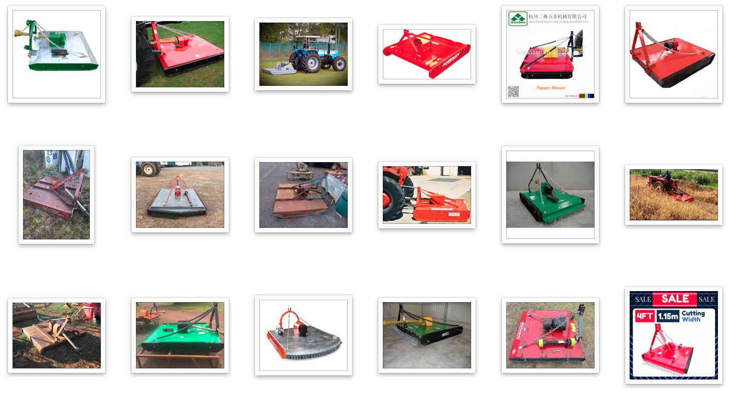

Why do North Americans require tailwheels on their rotary cutters? Much of the rest of the world doesn't.

Yeah, you foreigners have skids instead.

Most of those cutters don't look like they're more than light duty. Might be that most of Europe has already been cleared and there's little need for cutters that are as hefty?

My 'slasher' doesn't have a tailwheel... which is why I don't refer to it as a "Bushhog" on this forum.
It's exactly as the pictures above and I don't know of anyone who uses a tailwheel (here in Aus); unless it's a golf course. You either lower it onto the skids and drag (lifting for a turn) or set it at a height.
