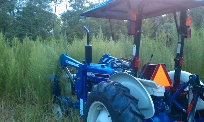

Finished the field today.. figure out that is was tryin g to cut it too short... Once I raised the mower up the grass would not get wrapped around....
Thanks for everyone's help.. here is a picture of the tall grass...
