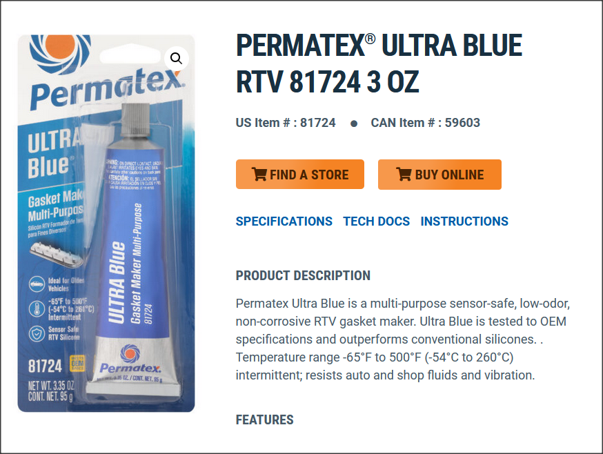

Guthentight will be good. Don't want to damage the gasket being too tight. Put a thin layer of RTV blue on both side of the gasket, let it skin for a few minutes and you will be good.

Actually Kubota 3 Bond works better and any Kubota dealer will have it. Comes in tubes. Either that or Detroit Diesel Anerobic sealant but you will have a hard time buying that even from a DDEC retail dealer as it's a service application chemical.
The issue with 'Blue Glue' is if it gets squeezed out inside the housing, it will flake-break off and wind up in the radiator or foul the thermostat itself.

Three Bond (Japanese) must be better since it costs over twice of Permatex RTV eh
Permatex anerobic flange sealant works well also.

Three Bond (Japanese) must be better since it costs over twice of Permatex RTV eh.
If you are that cheap (which I'm not as a tube of 3 bond is under 5 bucks), then use what makes you happy. RTV has it's place but not in a liquid contact or hydraulic application.

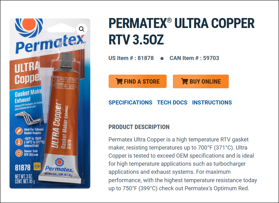

I have used both and they work well, but it's little over $5 for Thee Bond.....
Permatex makes sealants for most all applications.
