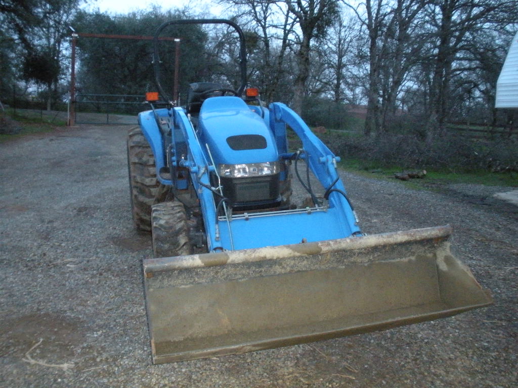

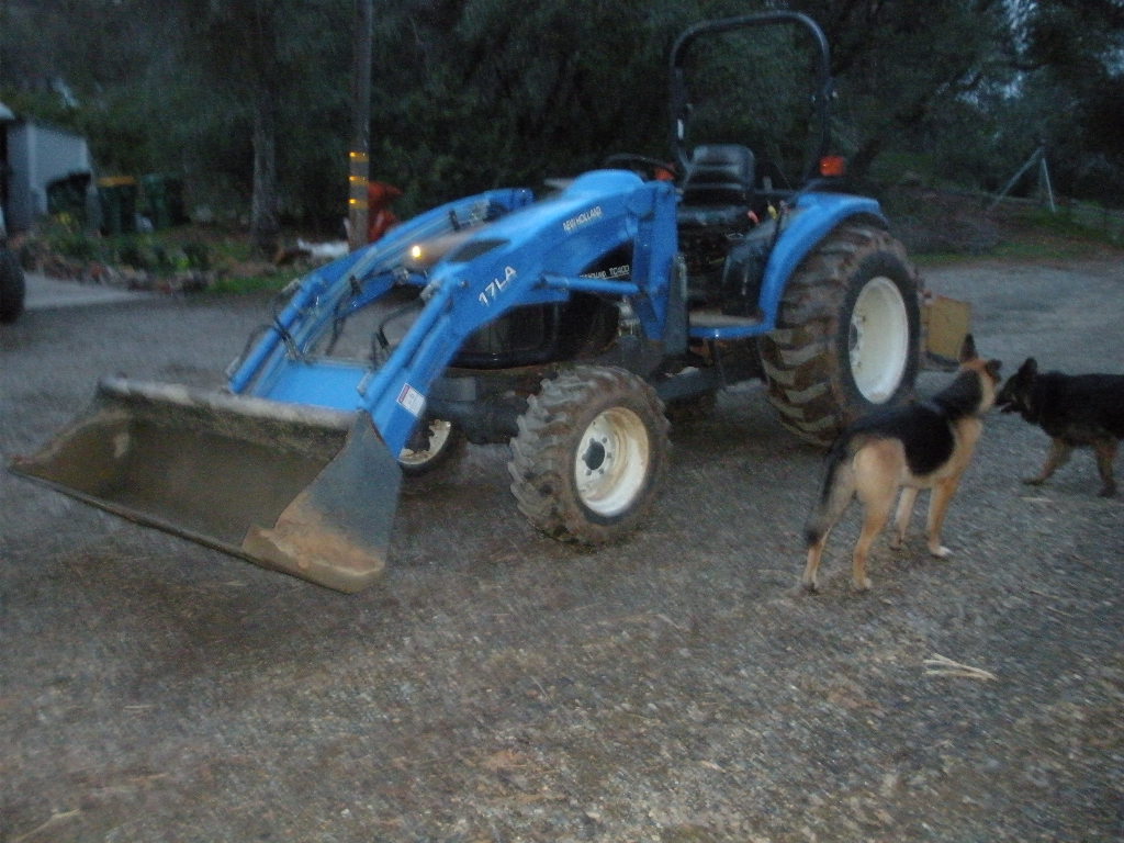

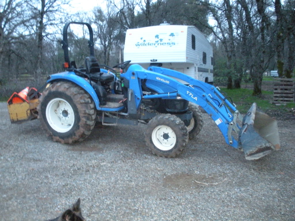

Well, I got some seat time today, mostly shuttling road base for road and driveway maintenance. So far, everything about this tractor is pretty nice. There is some work to do. The seat is stuck in place, ad the 3pt lever is hard to move.
Biggest thing is, I already miss my TnT. I'll set this one up, but it is not in the budget for a while. Same for scraper. Gotta run a 5' for a bit till I save for a 6'.
I think the bucket holds twice what my old one did. Still wanting to go reverse on the HST with my heel like the old tractor. It is very comfortable to operate.

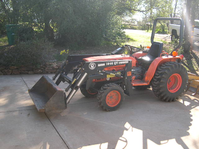

Pics are of old and "new". My old Kubota was a great tractor, but underpowered. Used it for a long time though. It was 19hp. Really a step to a much larger tractor, size and HP.

Wellll have you given her name yet. ;)
Looks comfortable..plenty of leg room.

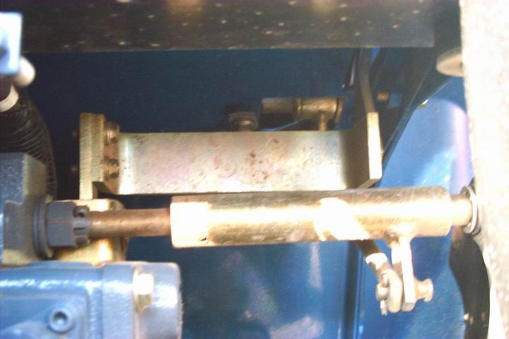

Robert, the seat slides have adjustments you can get to through slots on the outside portion of the slide. I adjusted and lubed mine to make the seat slide very easy.
Your 3PH being stiff requires adjustment of the castle-nut where the rotating shaft enters the lift cover. It's kinda hard to get to and much easier if you remove the right-rear wheel. I replaced the cotter key with a hairpin on my tractor so I could pull it from the rear and make adjustments in the future without removing the wheel.
EDIT: I added a picture of the 3PH castle nut. Yours won't look exactly like this because my picture shows a remote valve installed just below the shaft for the 3PH. The mechanism in front of the shaft is the lever for the 1st remote. You should have a lot more room and might be able to remove the cotter key and turn the castle nut without removing the wheel.
