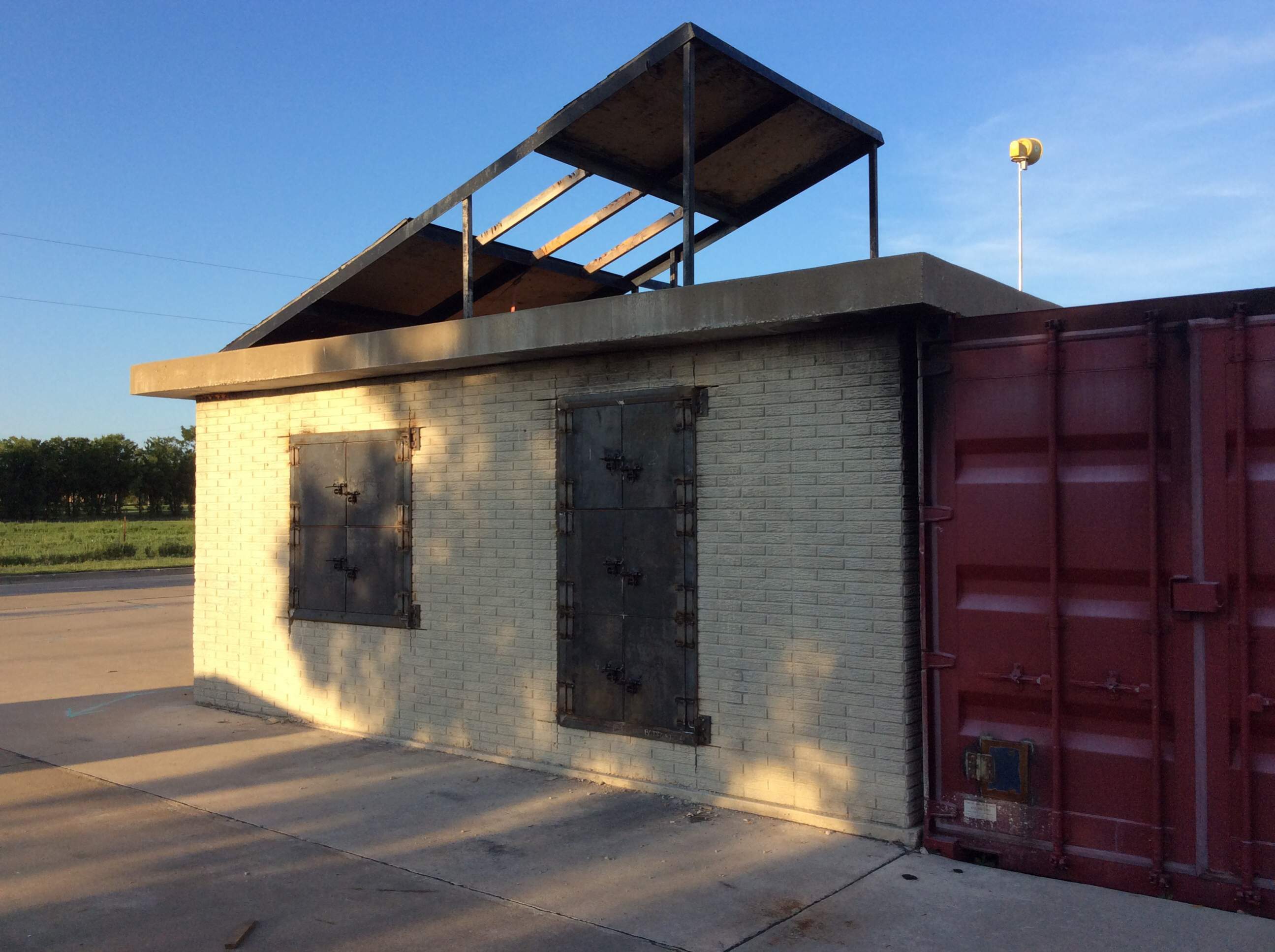

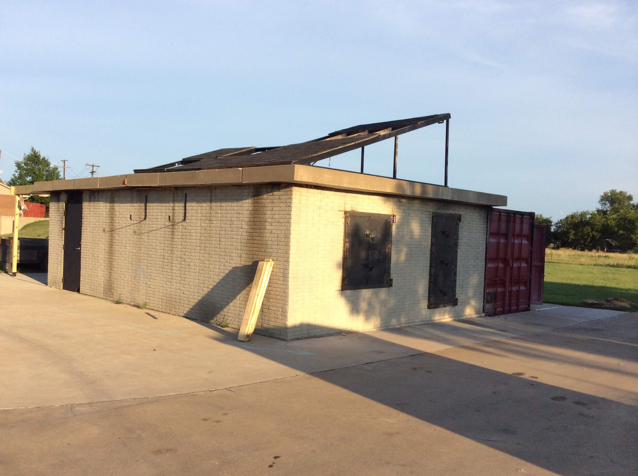

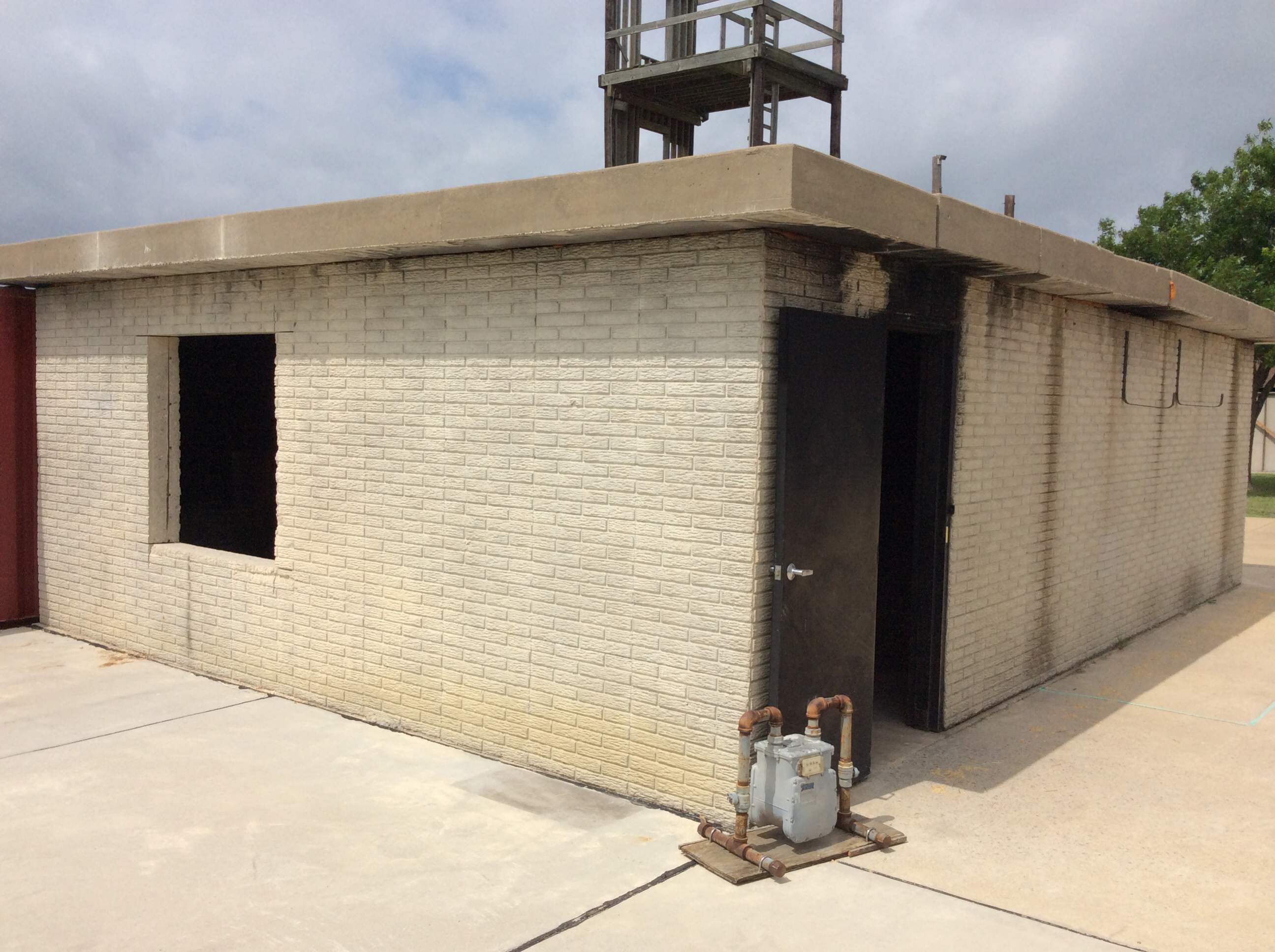

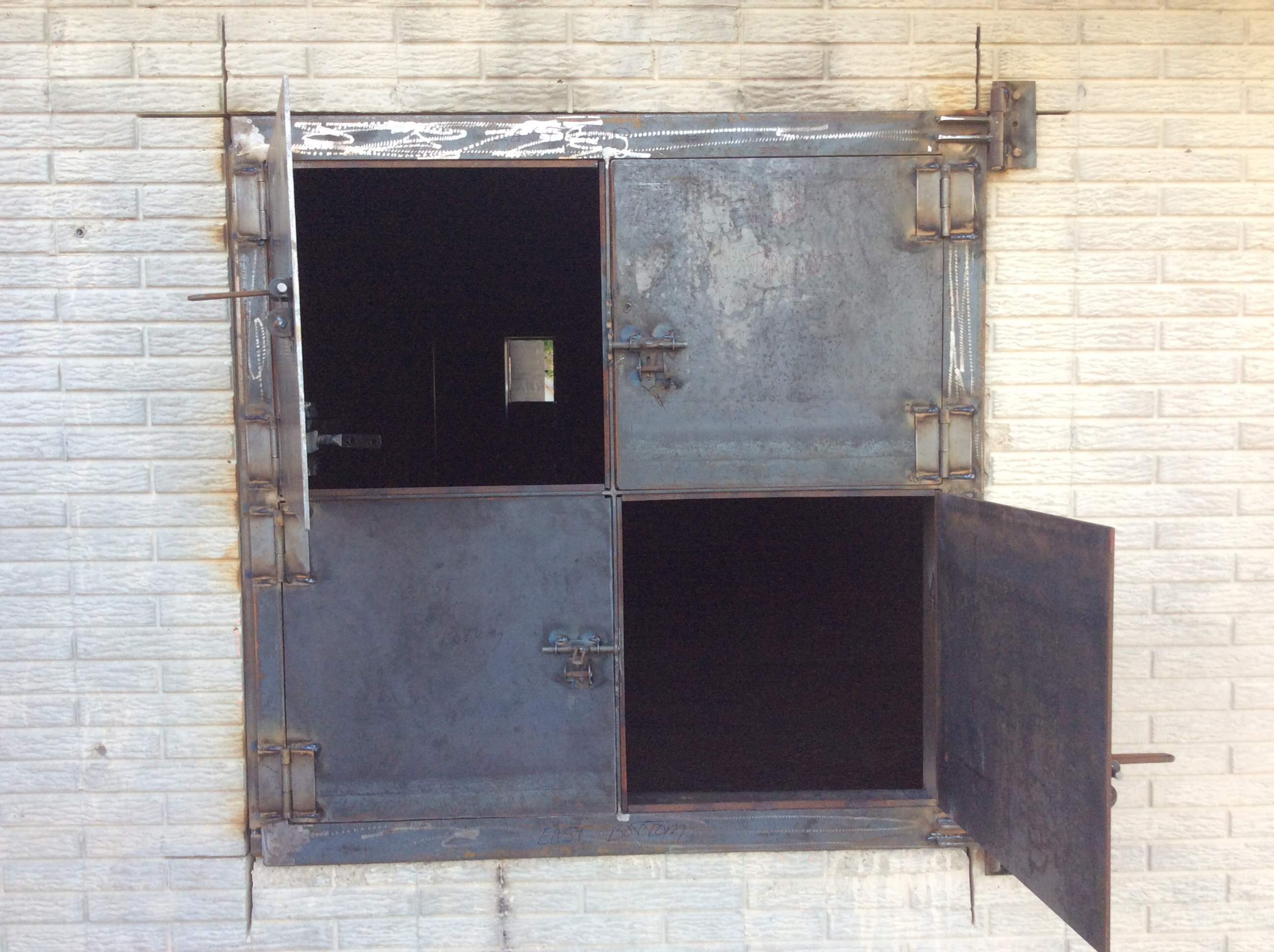

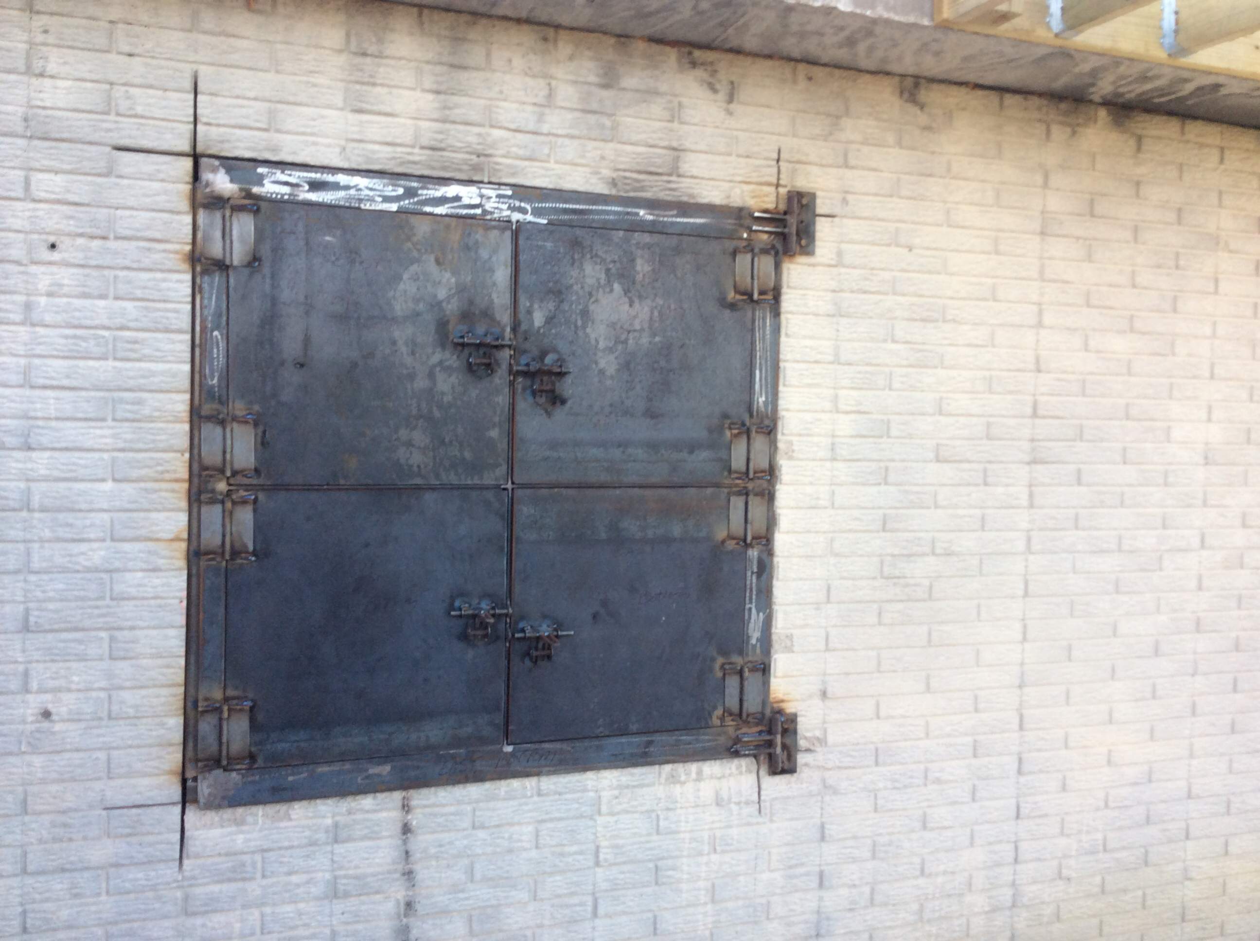

The Wylie FD asked me to help them out with a project. Back in the day when they were mostly volunteers that was nothing but a thing. They would ask and I would deliver. But things change, we now have three fire stations and tons of firemen and lots of equipment. The Wylie FD has won state awards many times.
They have a training center. And in this training center is a smoke house where they can train working in smoke. It works great but there is this new method of fire fighting where they place a wind generator, think of one of those fans they use to air up hot air balloons, at the front door. Then they break out windows in the back of the unit and the smoke is evacuated and it is a lot easier to fight the fire. It supposedly is a new technique and the Wylie FD wanted to have a training aid.

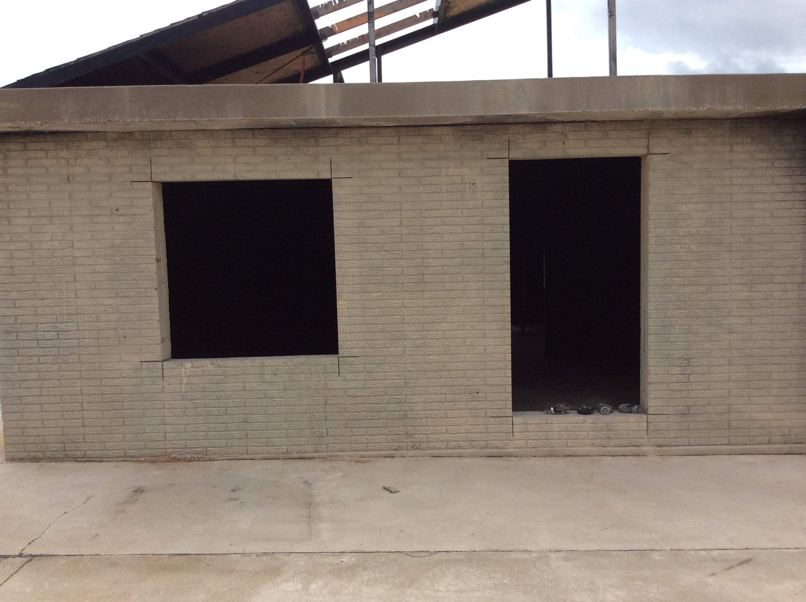

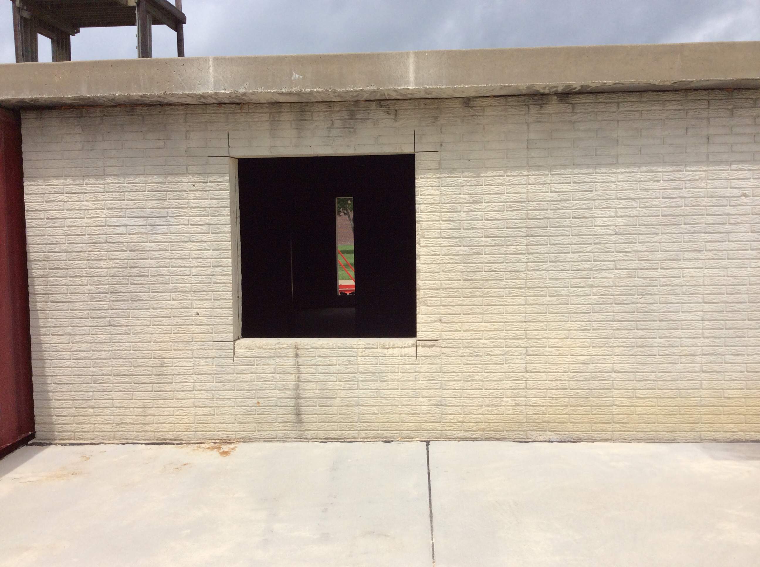

So they had three windows cut into the smoke house. And engineer laid out and stamped the window framing and left everything else to the firemen and me. The only hiccup is the city now has layers to go through but luckily we met the qualifications, $2,000,000.00 general liability for one.

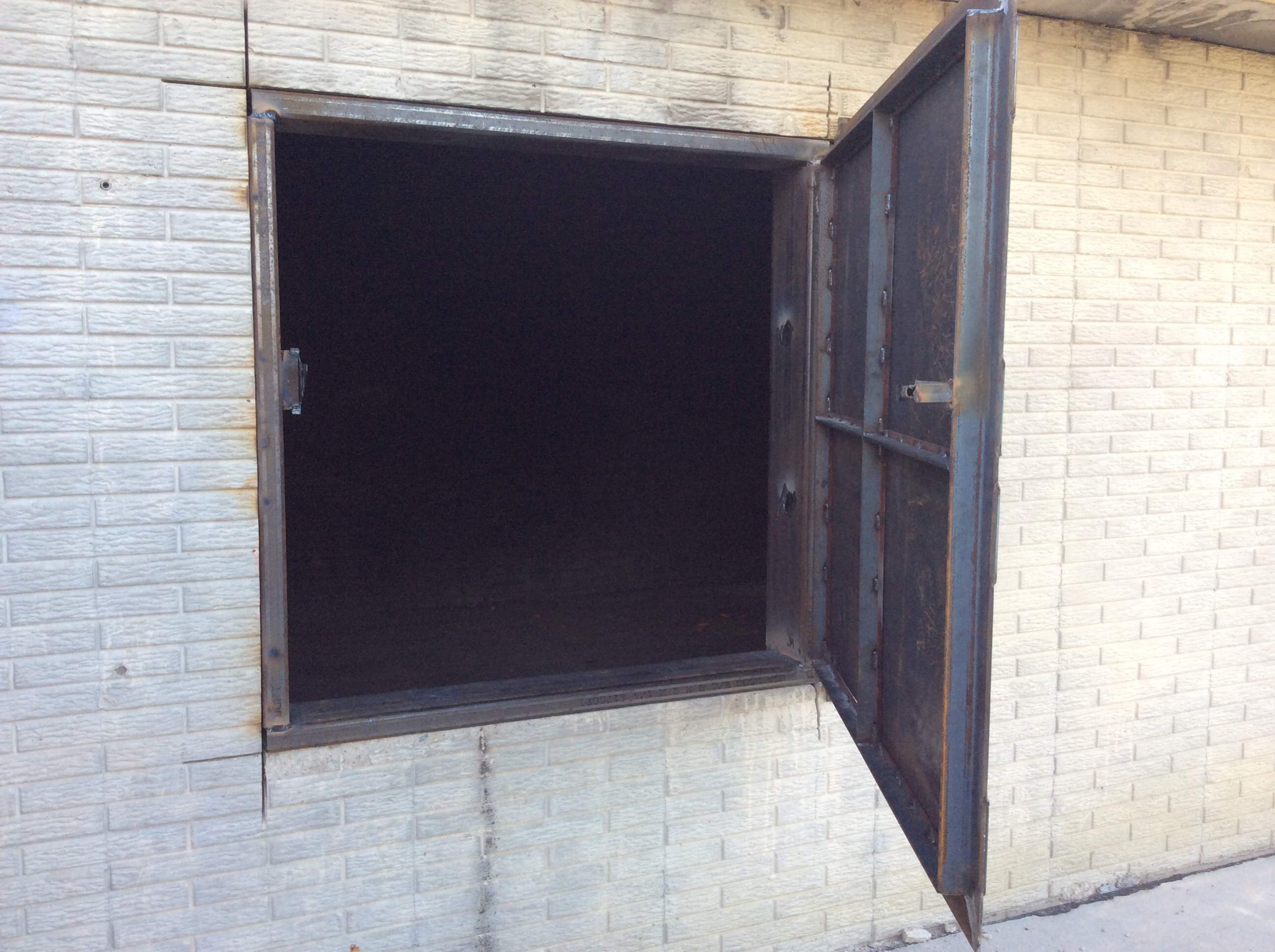

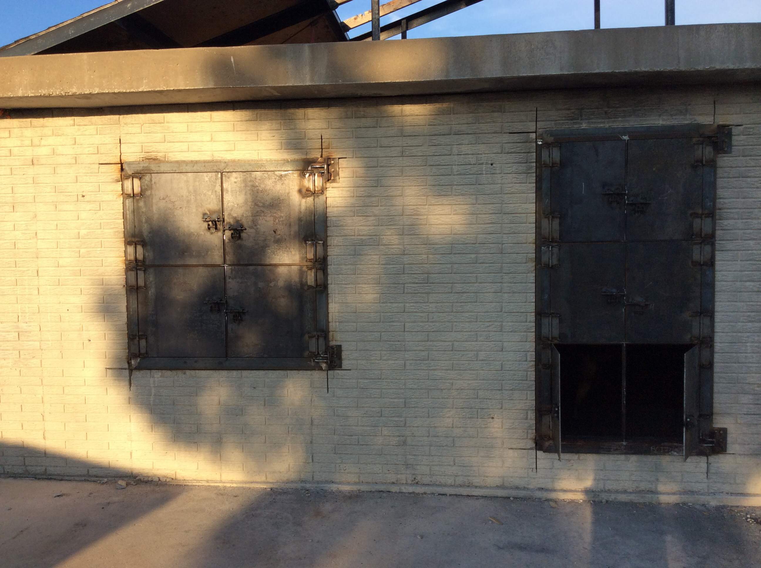

What they have have is one 4' X 4' window on the east side, one 3' X 6' and one 4' X 4' on the west side. What they wanted was steel window that could be blocked off for regular smoke training. And they wanted the 4' windows to have four separate doors that could be opened individually. The six foot window needed six individual openings. Oh, and they wanted all of the window to be opened from the inside in an emergency.

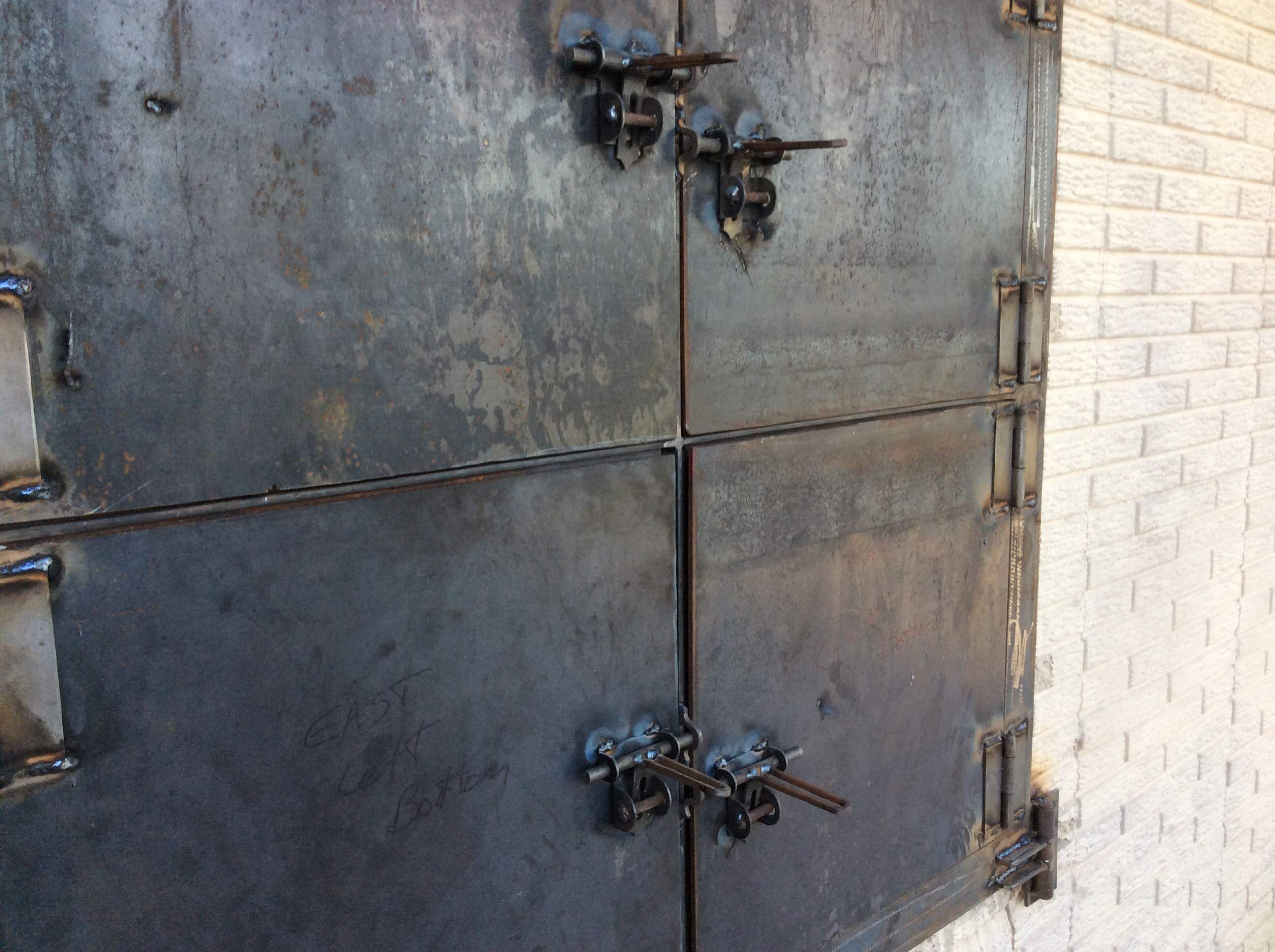

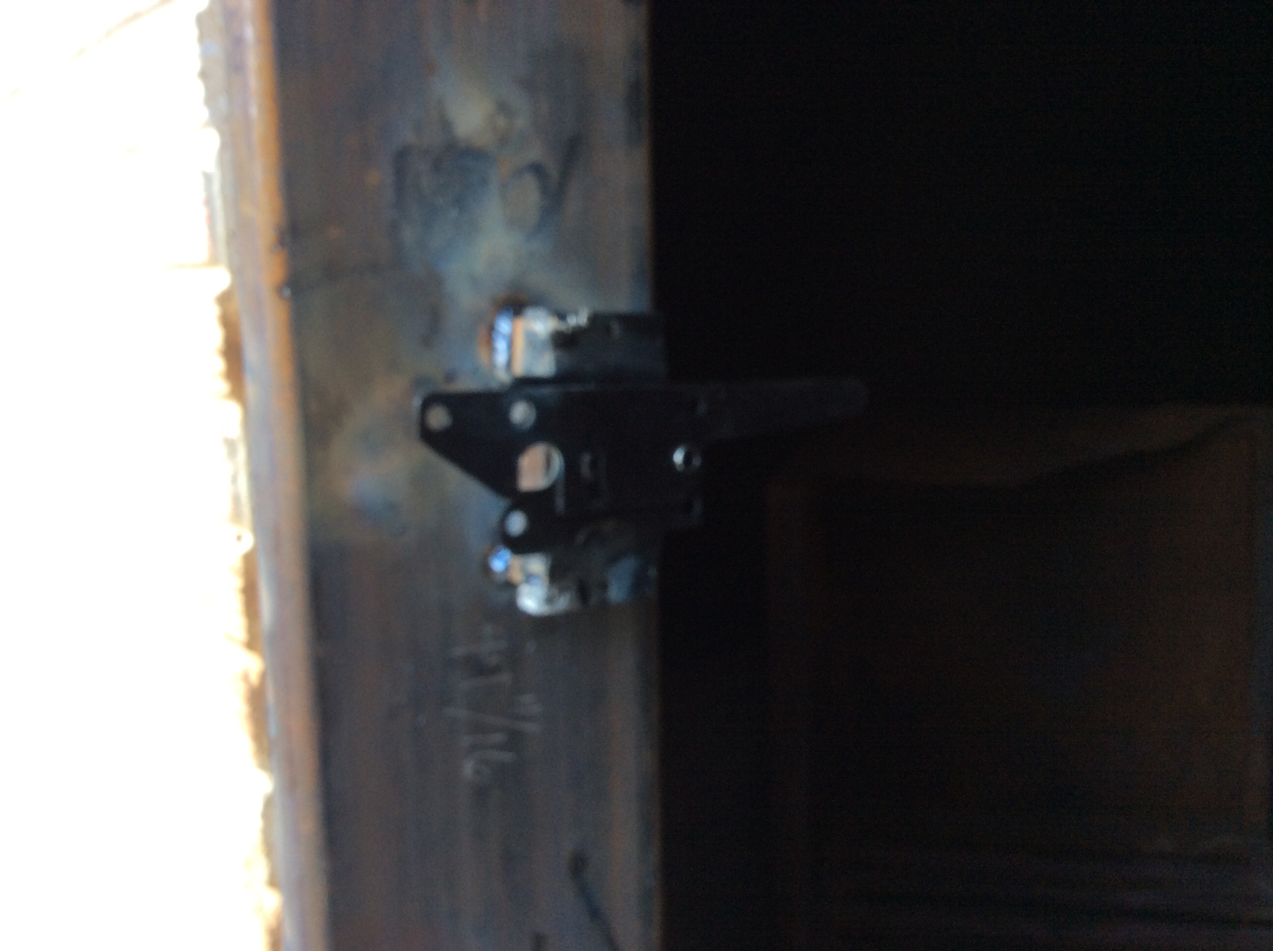

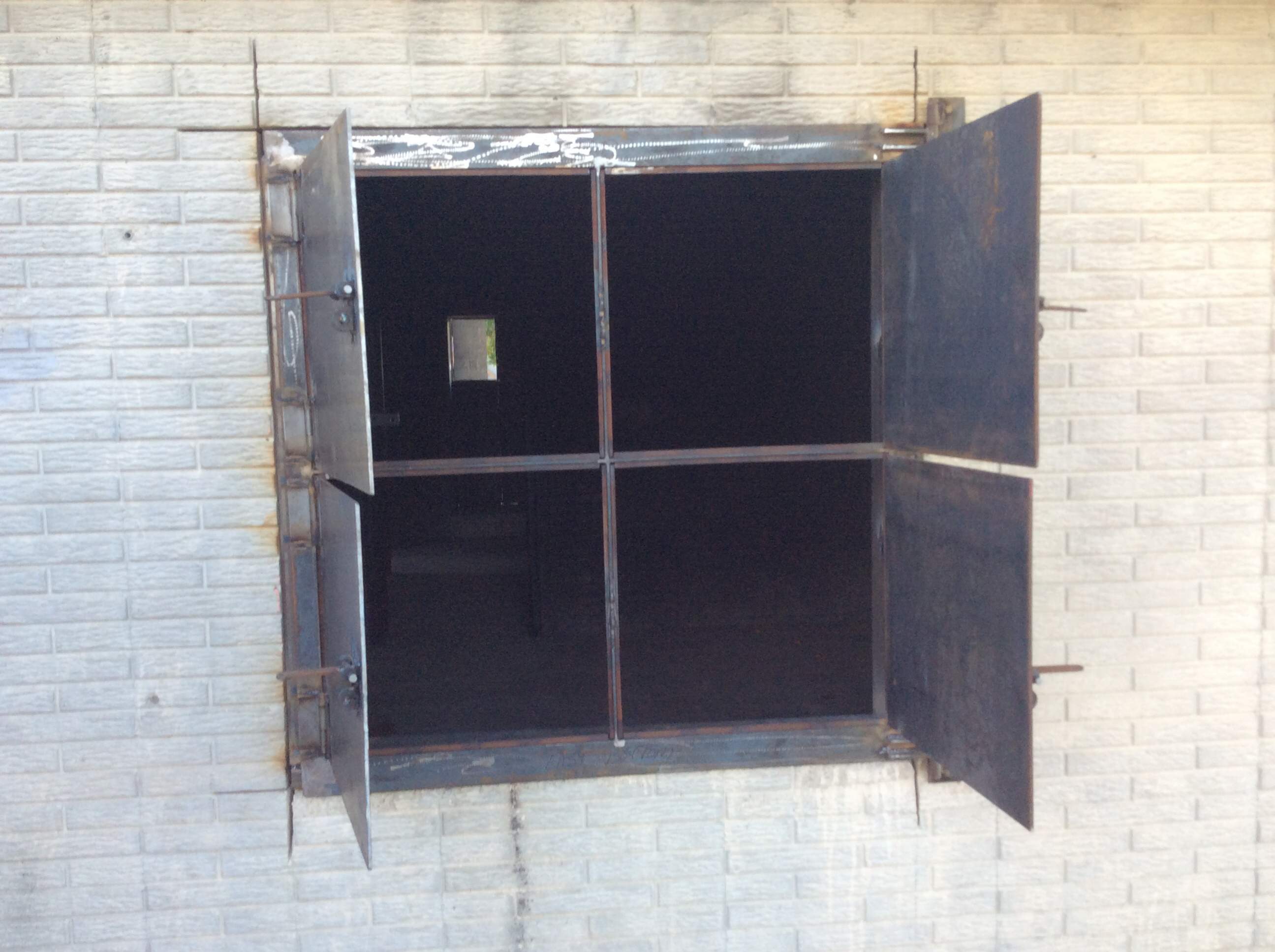

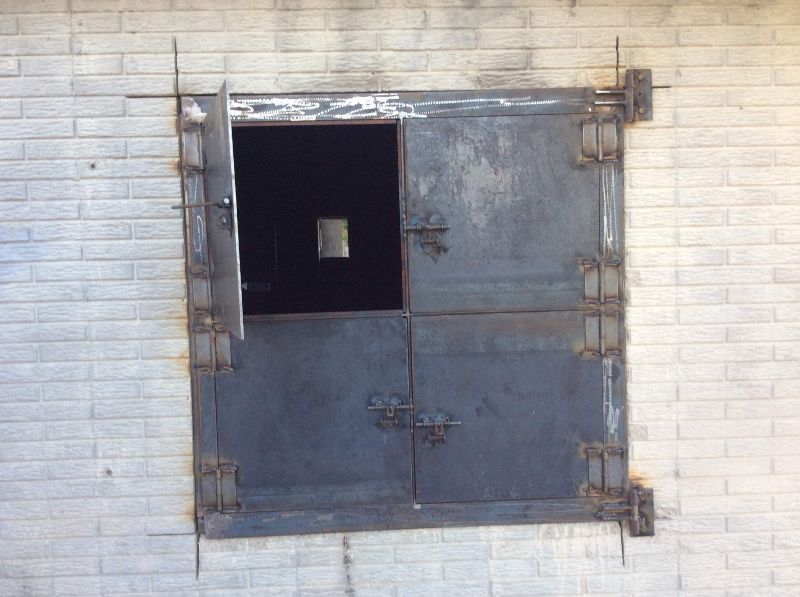

There were some interesting considerations. For instance the emergency latch had to be easily found and operated while wearing heavy gloves. The individual panes also had to be easily operated while wearing gloves but from the outside by instructors.
So as I understand it the two rooms will be filled with smoke. The instructors will be able to demonstrate the effects of one to fourteen windows being opened for venting the fire after the fan has been started. And it will still be a viable smoke room.
I used readily available components when possible. Boys will be boys and stuff will happen. I probably won't be around to fix it in fifteen years or so.
