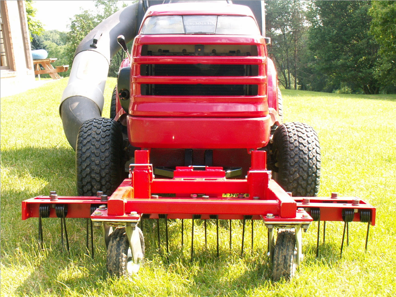

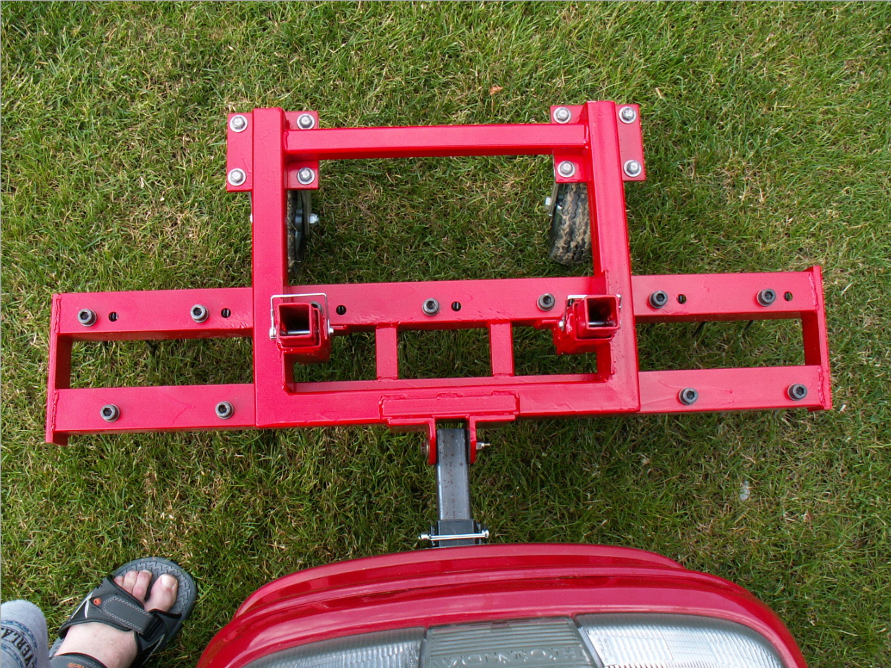

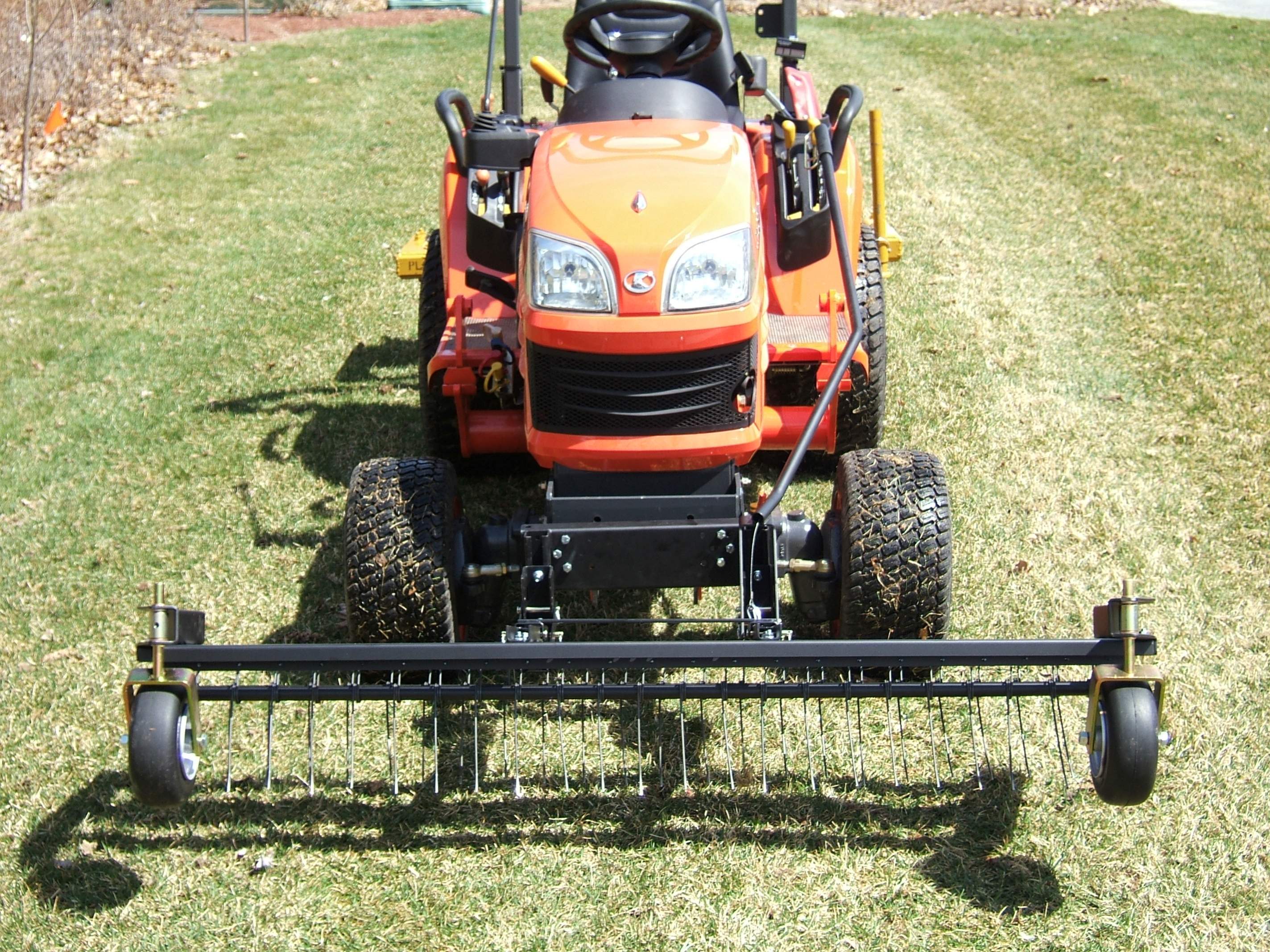

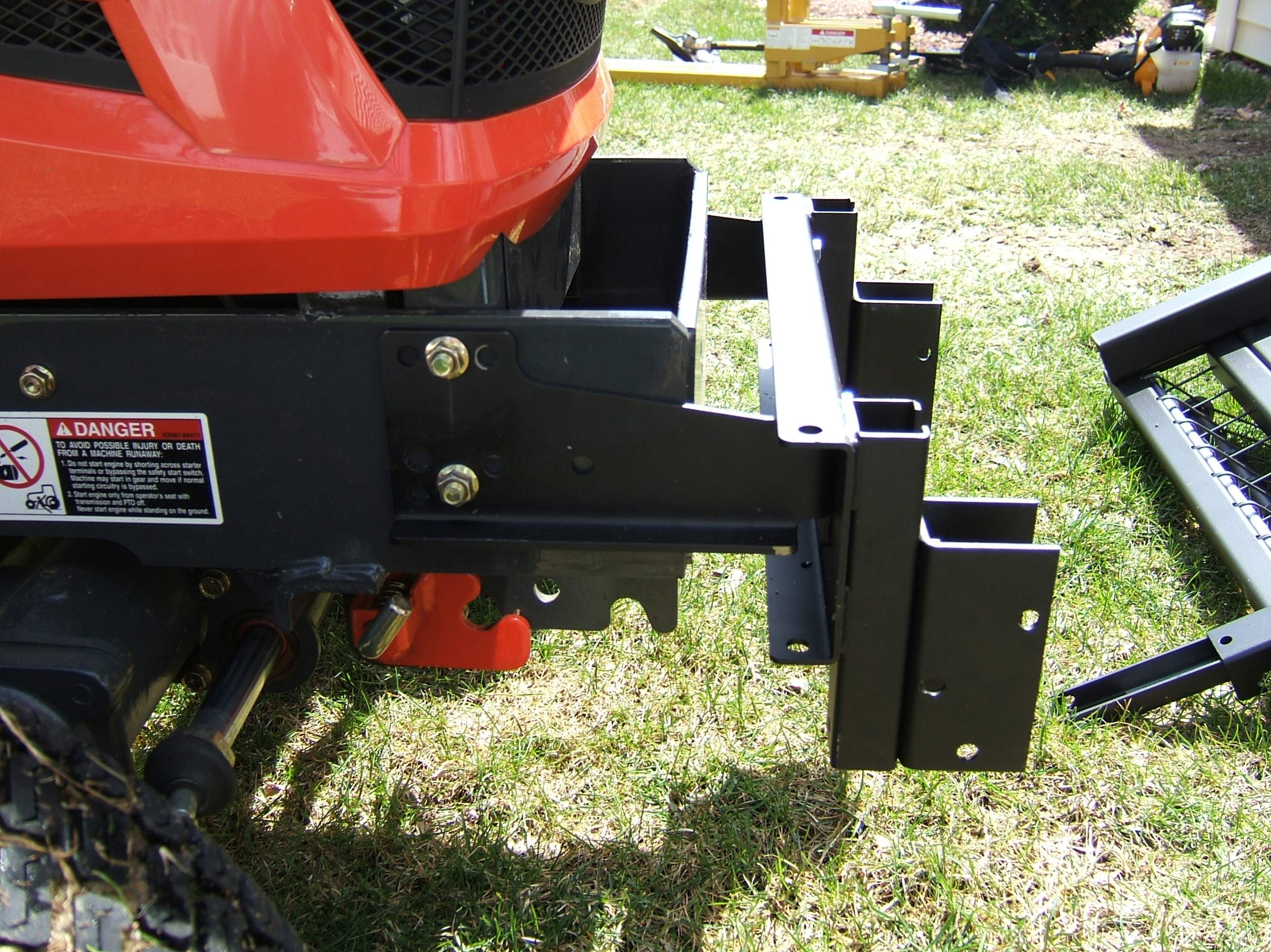

This is the JrCo...on my BX2350...
I run over the lawn horizontal and vertical with just dethatch - then I drop the dethatch and run the 60" deck and the bagger - works like a champ!
I drilled two additional holes in the mounting brackets to fit - but you should contact them directly - great guys - they sent me the mounting brackets free of charge to see if I could make them fit - it was a make them fit and pay for them or just return them...
Best part is raise and lower from the seat - cross the driveway, walkway, patio...without even slowing down :)

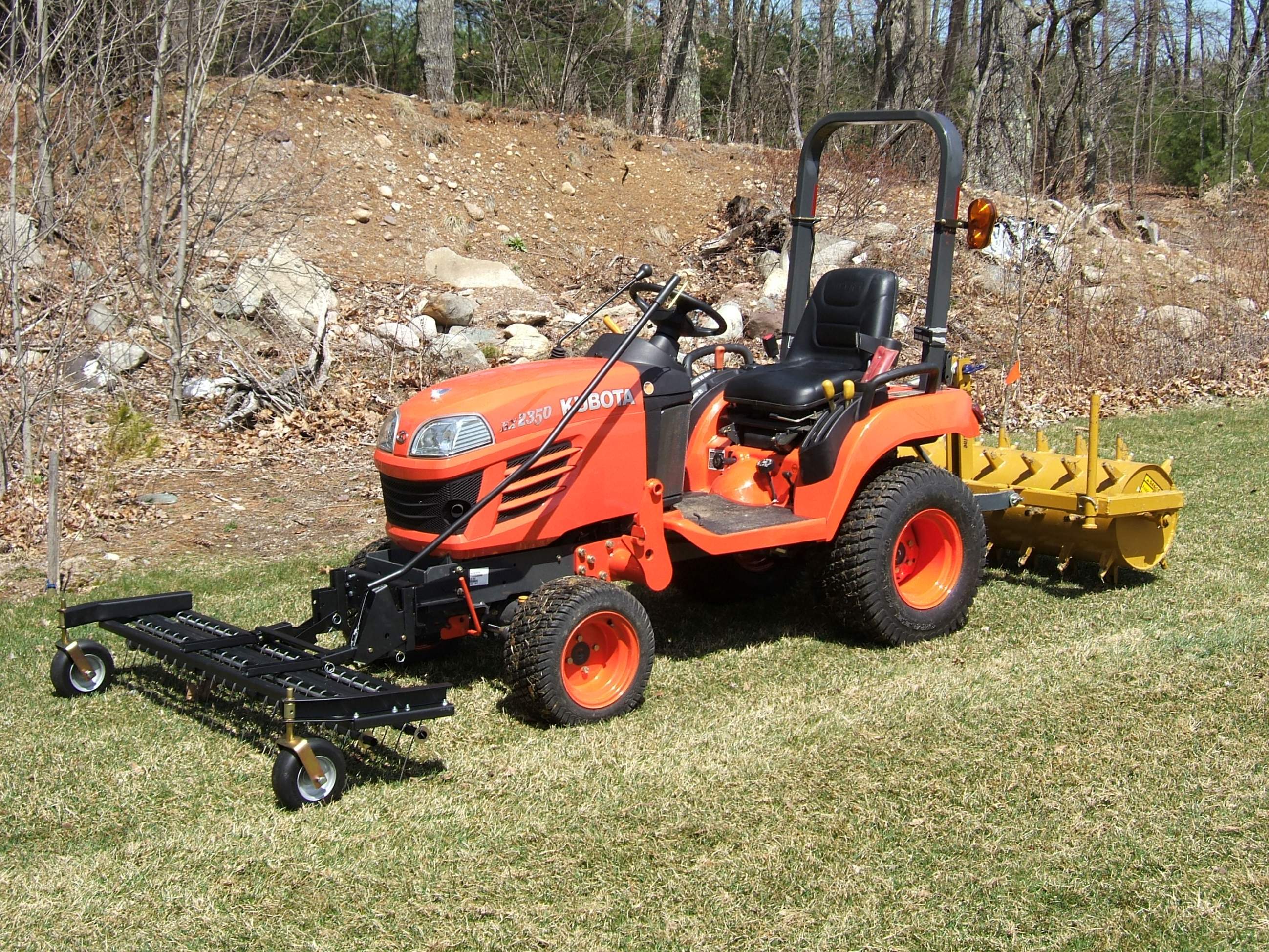

I must say, the JrCo unit looks very robust. It is wider than mine, and has two caster wheels. Very Nice unit. My cheap unit is adequate for my needs, and matches my storage space, but many folks on tractorbynet have big yards, and this unit you picked should suit them well.

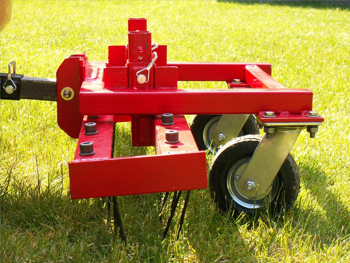

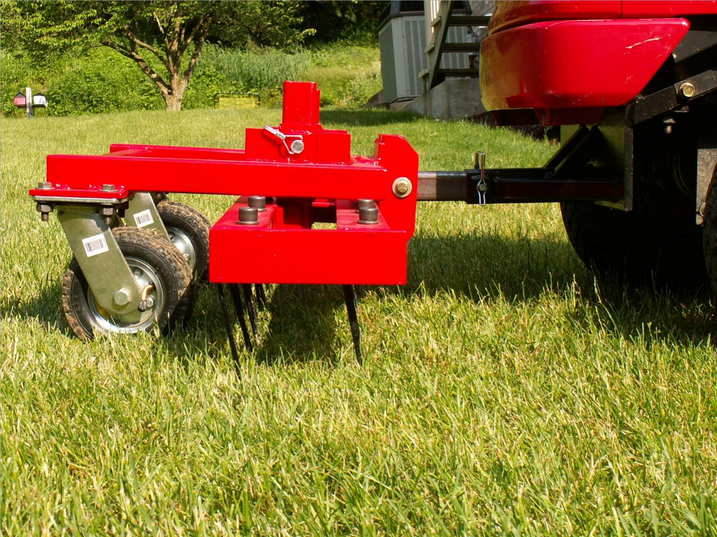

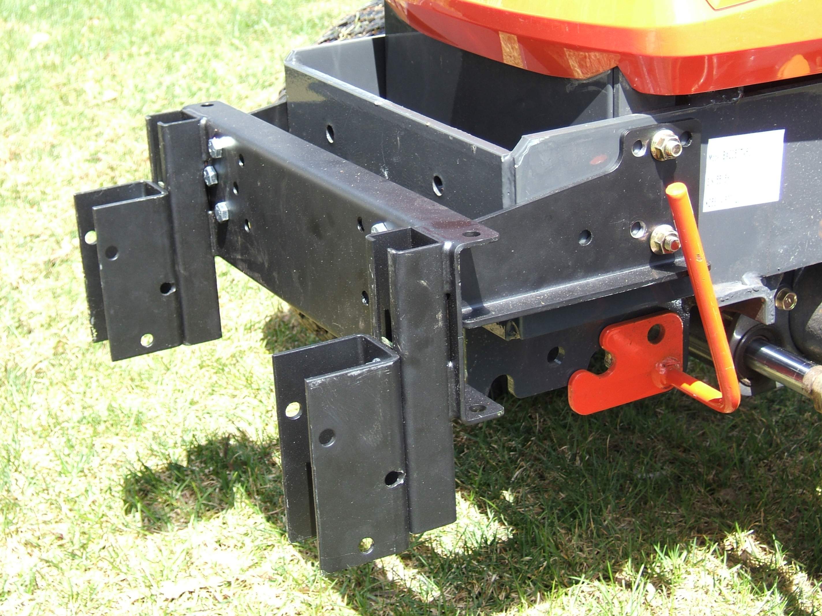

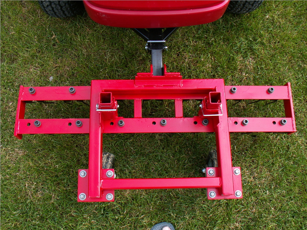

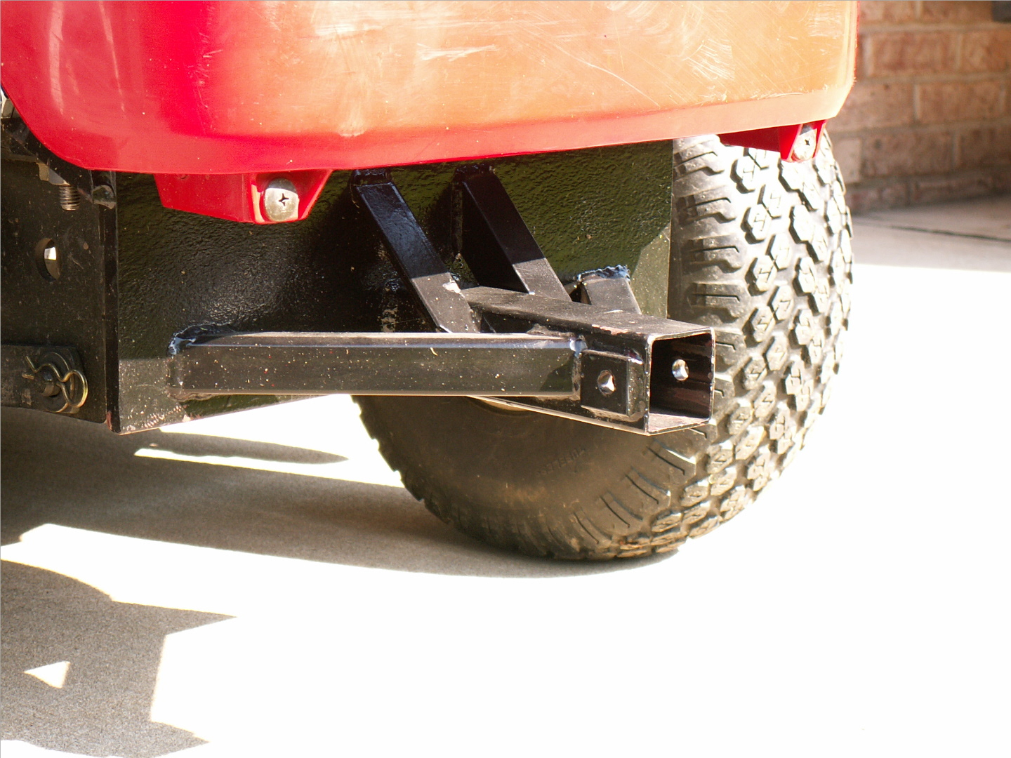

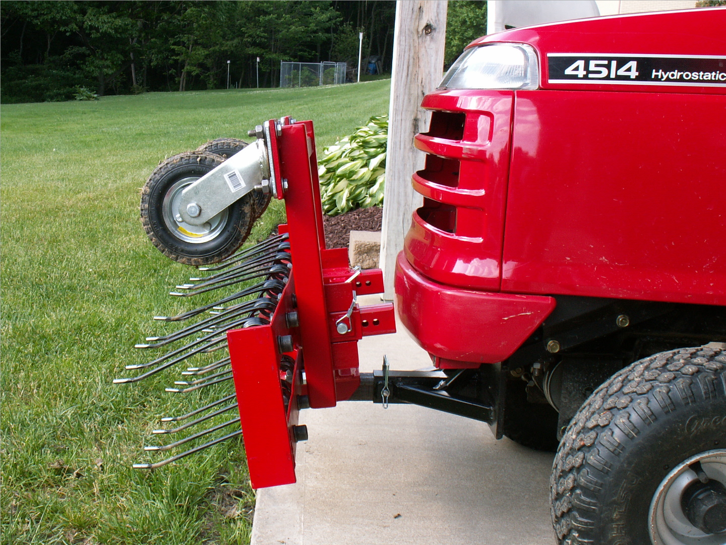

This is something I crafted for my Honda 4514 last winter. I love winter as it gives me time to think and design new toys!
I actually had to build a hitch receiver and mount it to the front frame to mount the thing. It does work very well too.......
