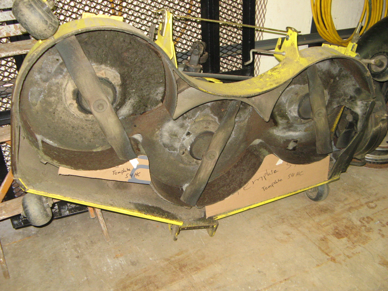

this is a work in progress since the leaf season is upon us and it will only get worse. I basically just cut off the part of the mulch kit that was blocking the exit. welded on a tab to bolt down the loose end then cut off the plates that prevent flow of material between each blade section. But like I said it works great right now because the leaves on the ground are not dense but as the season progresses I think I will have issues with there being too much material under the deck with not much area for it to flow towards the exit. The real solution should be to come up with a leaf kit like JD sells for other mower decks which is just a baffle plate similar in shape to the mulch kit but that doesn't block off airflow under the deck.
i have a piece of 1/4 inch plate I just need to find the time to get it cut out to the shape I need and then weld it up.
I can actually suck leaves off my asphalt driveway without too much blowout which was not possible before. my mower would just blow all the leaves around before the mod and nothing would end up in the bags on the driveway.

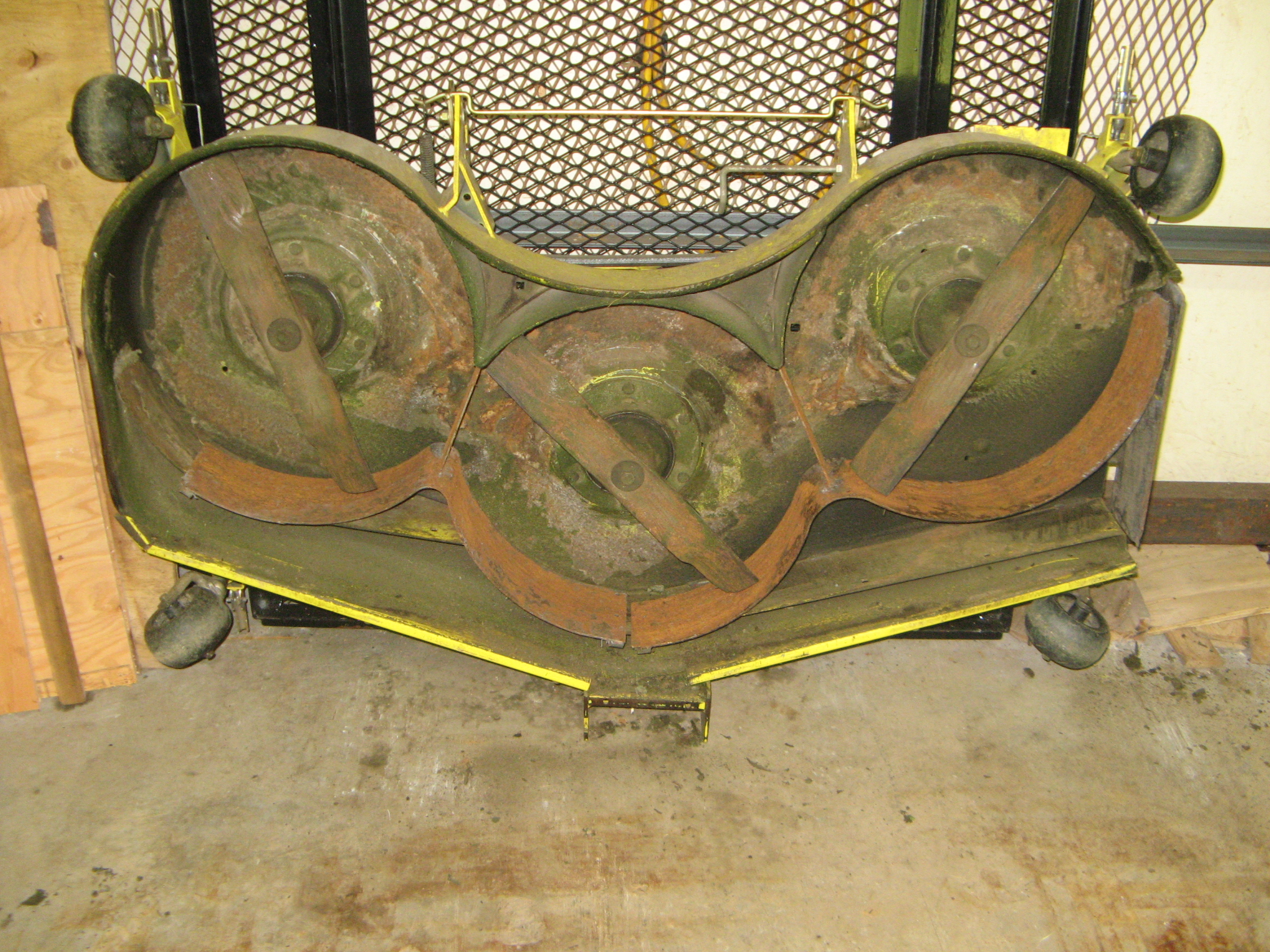

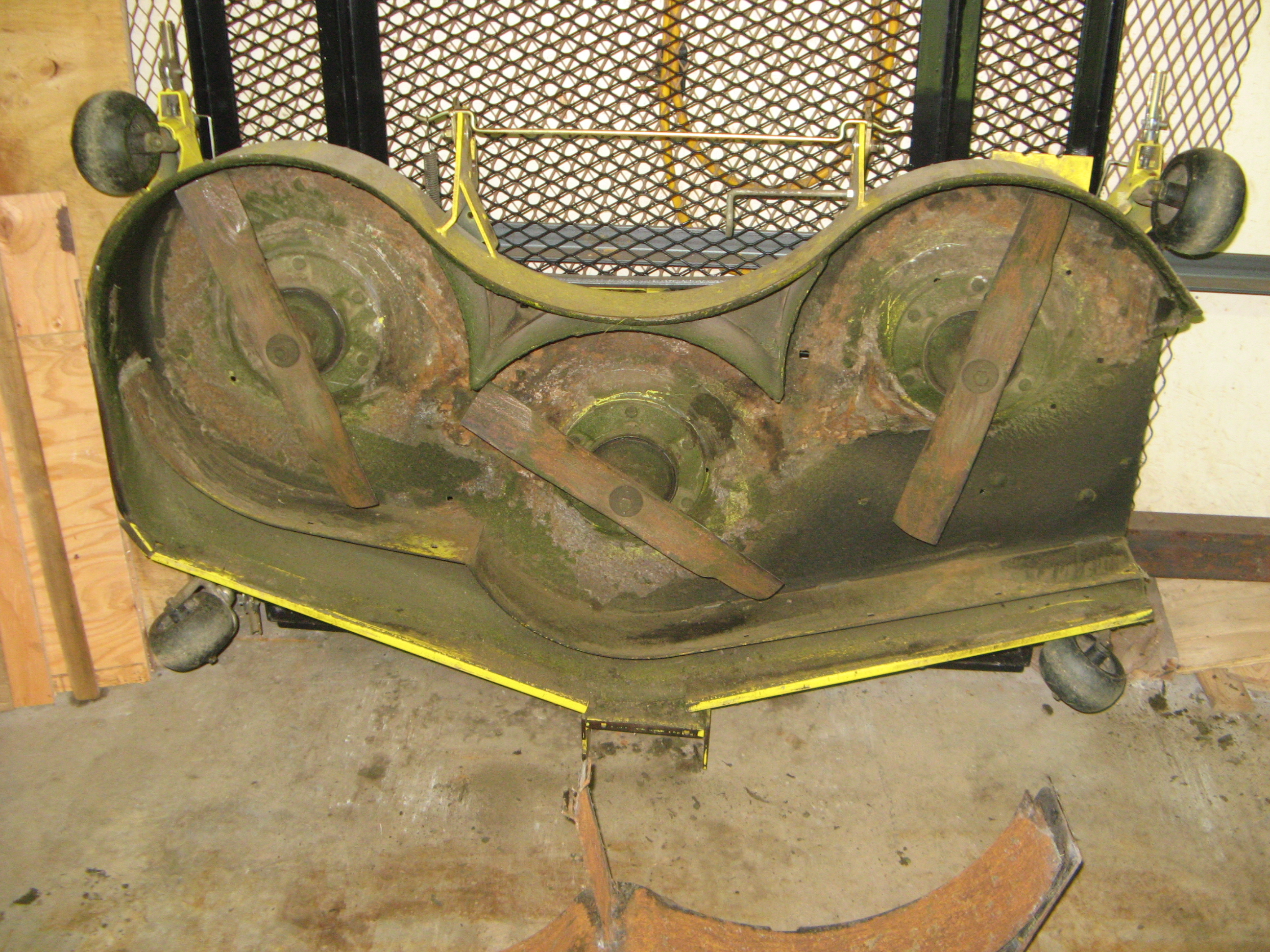

here are some pics without the mulch kit and with the mulch kit installed. you can see where the baffles need to go to mimic the mulch kit without restricting flow under the deck.
I bought the mower used with the mulch kit installed but the previous owner had standard lift blades on it. I had to change them before I could use the mower because one of them was bent.

there are even pre punched holes for carriage bolts where I need to mount the baffles so its as if JD knew they had to develop something for it but just never got around to it.

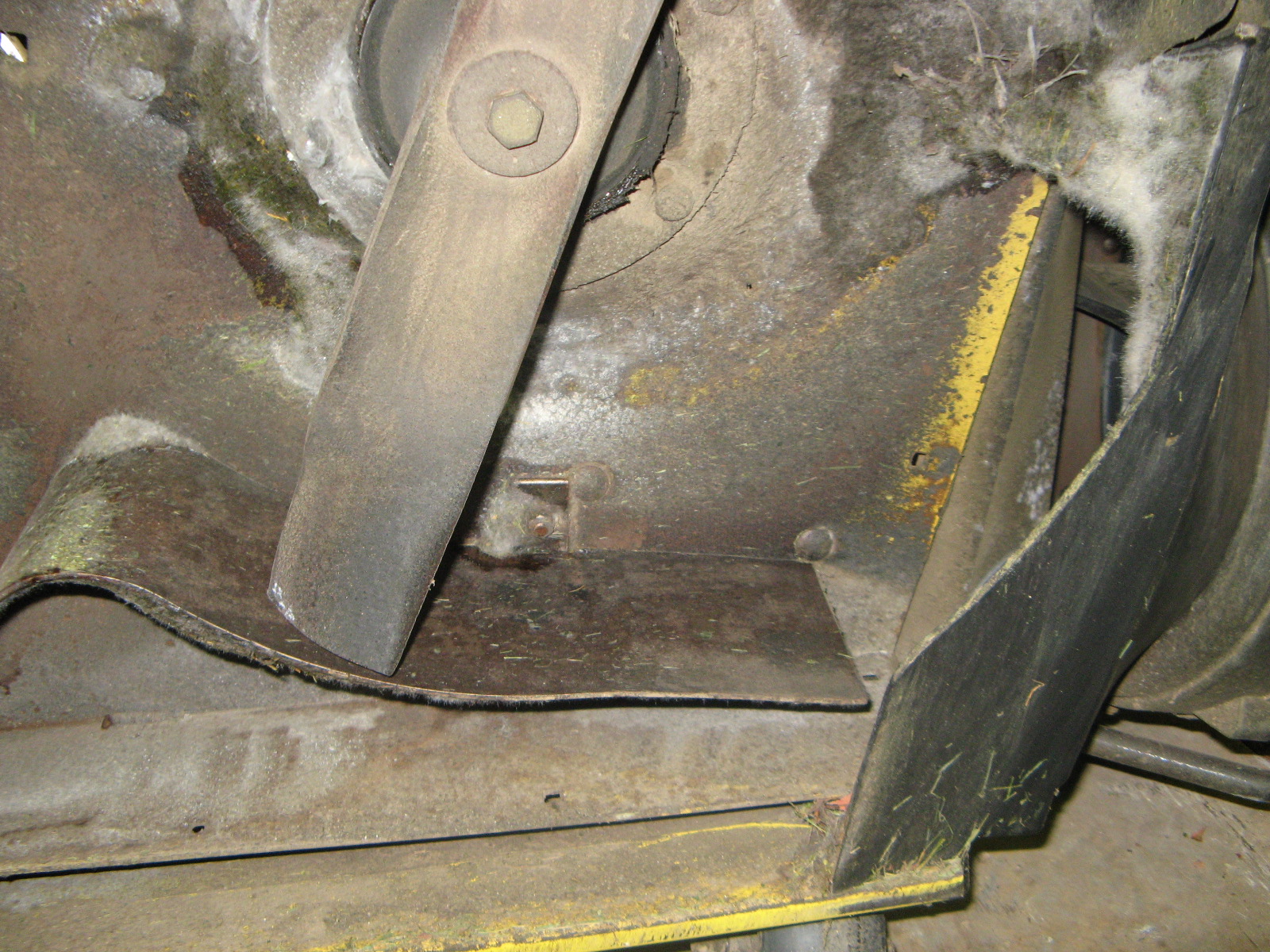

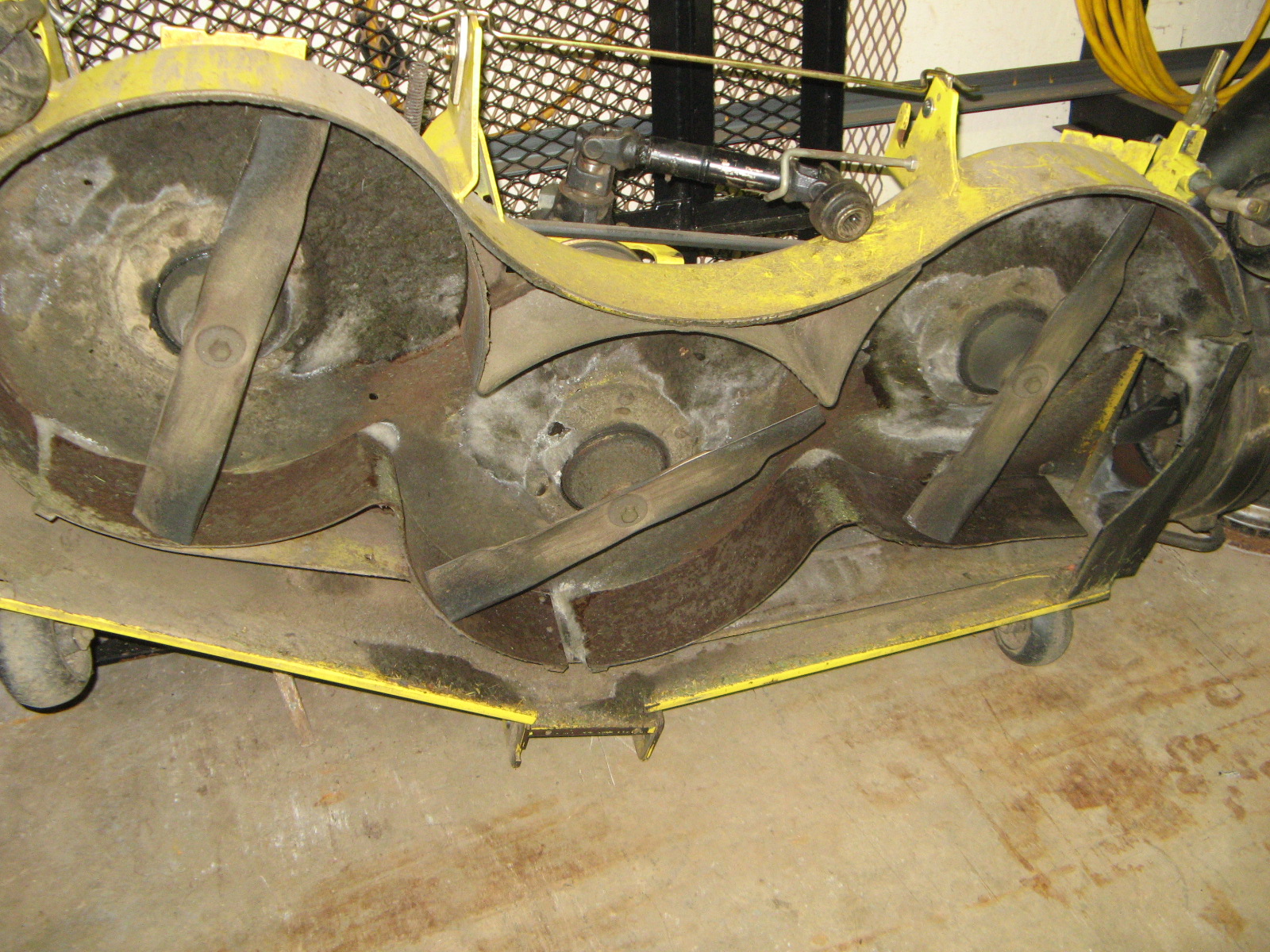

here is a pic of the modified mulch kit
and a pic of my cardboard templates taped into place
the left side mulch kit baffle only needs to get the baffle between sections removed but the right side mulch kit baffle needs to have the baffle between sections and the end plate cut off then adjust the angle so it exits right and have a tab welded to use an existing hole in the mower deck to bolt it down. There is even already a notch on the underside of the mulch kit that let me slide the tab under the baffle and weld it to the outside of the baffle so it wouldn't disrupt the flow of air under the deck. I used a piece of 3/16" angle iron for the tab.
