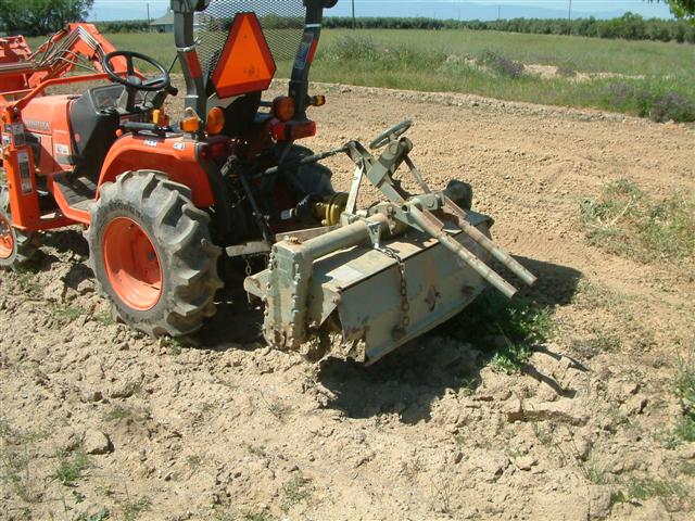

My RS1200 back flap was a shredded mess, so I trimmed it a little. The flap is there to smooth out the tilled soil after the tiller digs it up.

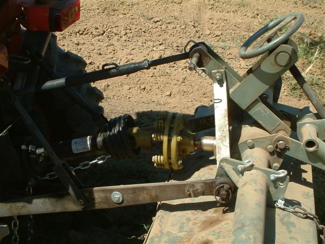

I had to use the 35" long lower lift arms off my Massey Ferguson 135 tractor since the 25" arms on my Kubota B7510HST caused the wheel rubbing problem you have. I also installed a slip clutch on the pto shaft and had to add a pto extender on the tiller to keep the slip clutch from rubbing on the top sheet metal on the tiller. I bought the shortest pto shaft from TSC and then trimmed it to get everything to fit.

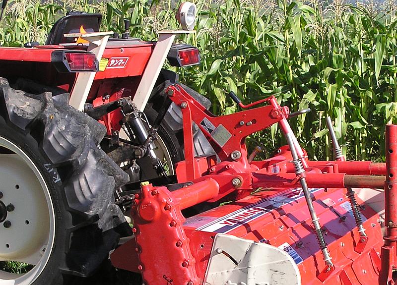

Don't know where you are located. LCI Products in Wills Point Tx used to have a pretty good pile of Yanmar tillers. They sold parts off some of them. Haven't been by there in a while so not sure they are still there. I believe the in the Northwest Erinies Imports may have them. In the Southeast Fredericks may have them. And I'm sure there are other places. I just made a short top link for my tiller and have been using it for several years. Mine is an RS1200.

Yanmar has their tiller close coupled and if a factory type upper link isn't used, you will likely hit the rear tires with the tiller.
Look closely at the pic and you can see the upper link and how short the bar is. It attaches to a special upper link extension and when all connected, when the tiller is in the up position the bar is almost vert. The extension piece comes in various models to fit different tractor models. The special upper link is designed so as the tiller is lifted or lowered it pivots about the lower link mounts.
Depending upon tiller and tractor model the rear flap is used in conjunction with the UFO controls to automatically control the tiller depth.

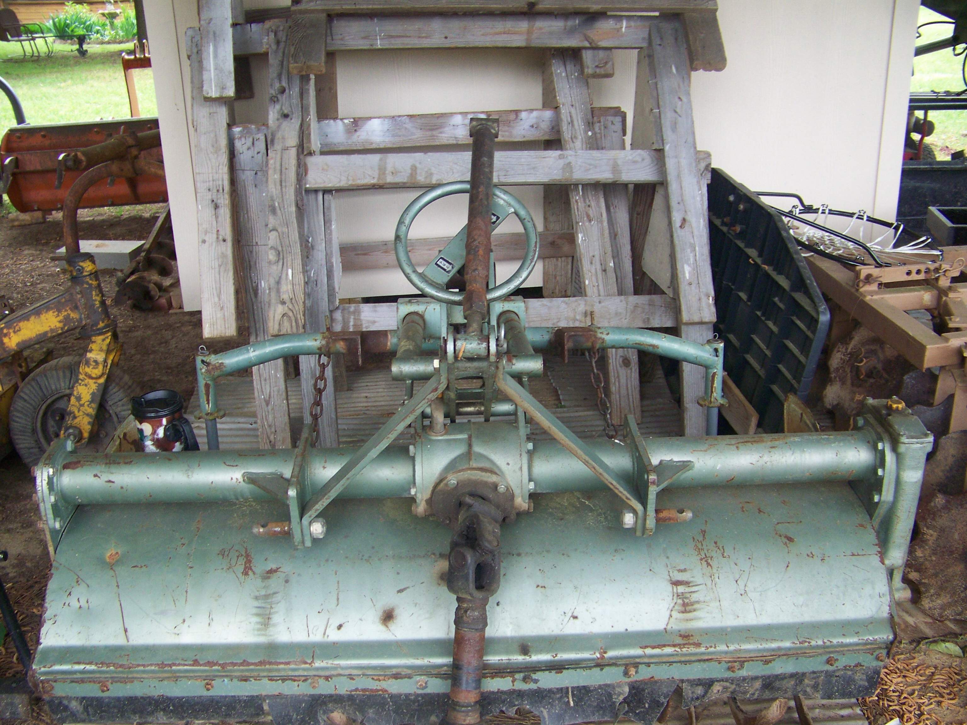

When I bought my 1400 there was no rear flap. I ended up making one out of 3/16 steel plate and attached 2 chains to the flap and attached the other end of the chain to the cross bar that used to work the wheels. The sheet is flat and does a great job of smoothing the tilled soil, I think the extra weight helps.
