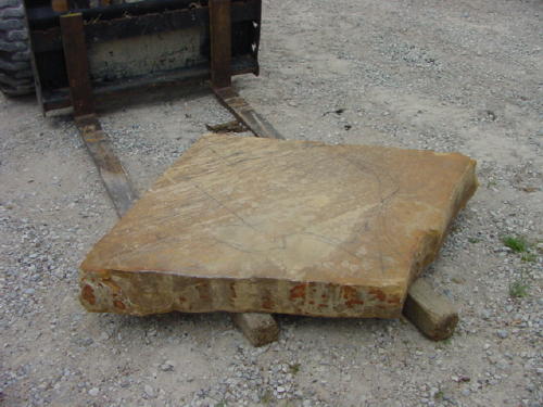

This is a project I'm starting.
Every now and then I get lucky and get to be involved in a project that's unique or at least a little different.
This is one of those.
The project involves about two hundred and seventy feet of pipe fence with a gate. There will be an automatic operator of course with the keypad etc.
The customer went online and found a gate I'd made and wanted one like it. Slight problem. I really try to not make two gates just alike, character flaw, no one's perfect.
He decided to turn me loose.
What we're going to have is a six inch pipe overhead with elbows here and there. The gate will be four and a half rail four inch (4 5/8" O.D.) pipe. It will weigh about seven hundred pounds before we put in the rock. It also will have no mitered corners, all elbows.
The rock. I'm not much for steel silhouettes. Anyone can do them and machines do them best. So I figured we'd use a rock to make our statement. I'd never seen a rock in a gate so that's reason enough to do it.
Customer agreed. There was some doubt in his eyes when he agreed, but he agreed.
So today I picked up a five hundred and eighty pound piece of stone to see if what I thought was possible was, possible.
Here's the rock.

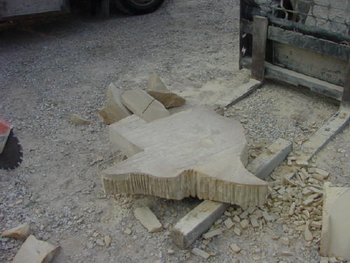

This is not the rock I will use in the gate. It's about three quarter scale and a test bed for technique.
After a couple of cuts

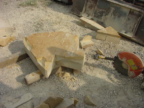

This is after a couple of more cuts.

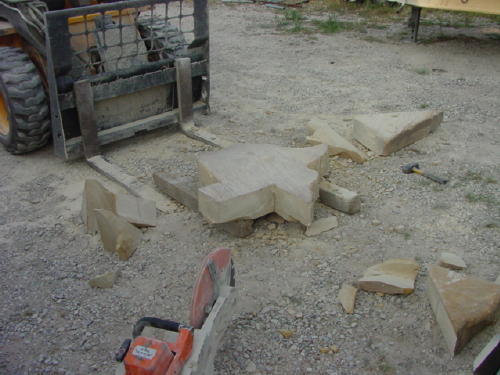

another view
   / The gate
The real rock will appear to be floating inside a frame of pipe. In the middle of the rock will be the letter D in an antique french style. It will be a positive image.
By positive I mean the letter will stick out instead of being cut in. It's more difficult but I believe the sun has more fun playing with the positive image than it does with the negative ones. I guess the sun isn't much different from us. /forums/images/graemlins/grin.gif
I've never tried to do this before. So not being the smartest cracker in the pack I've used the same techniques I'd use if I was doing it with wood and power tools.
I'm after a couple of things with this gate. One is for the rock to appear natural in the company of pipe. I don't want the rock to appear to have been cut out with a machine. I don't want anyone to think for a minute that it has been done by waterjet or a computer even got near it in production. If what I want to happen does it will appear that mother nature worked over some eons or two on a stone and it came out looking like a map of Texas with a "D" in the middle. And we found it.
I'll keep you posted.
