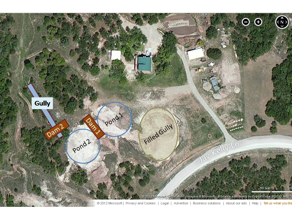

I couldn't do a whole lot yesterday because of the weather, so I decided to redo my "orientation" photo as requested by beppington. The current Bing Maps photos had to be shot last year. They are so up-to-date they are scary. I didn't have all my excavation done when the photo was taken, but it sure shows the project well underway. I've labelled all the areas so you can see where things are going. The last set of photos I posted of dam 2 are taken from the pond 2 basin looking directly down the gully looking north (or just slightly northwest). Because the gully is a big "V" shape and I had easy access to the opening of the gully, I decided to work from the pond end instead of cut down the bank to make a core trench. As I cleaned out the gully's silt, made it a lot deeper and then refilled with clay. Raising the clay and expanding outward to the sides is my primary plan. Each side of the gully "V" has clay down about 3' deep, so I remove the topsoil and sand and refill with clay. If I get runoff in the pond from these rains, I now have the option of cutting down the sides and coming in that way to bring in clay because my gully has been filled and the dam is firm, solid, and flat. It's also wide enough to drive my tractor on and turn around. Being able to maneuver was goal to get completed before the rains. If it looks like another dry day here, I'll try to get back in there today. Yesterday's rain really only settled the dust and there's no standing water.

OK I just about get the picture now :thumbsup:
I assume Pond 2 is lower than Pond 1? And "Gully" is lower than Pond 2?
So "Gully" is the sloped funnel that directs overflow toward the reservoir to the NW?
These questions may be obvious to others, but it's so flat here I've never had to even think about water flow or collection ... even though my property is almost entirely below the 100-yr flood plain! :eek:
I don't remember reading - Are you using instruments for this project, or just eye-ballin' it?

I have a surveryor's transit loaned to me by a friend, but when you have these wash gullies like I do, it's pretty obvious what is upslope/downslope. I also have a very good eye for level by sighting references that I know are level like on my house. All my final grades will be checked with the transit, but that takes two people to operate. If you look at aerial photos, it's hard to see where the slopes are located, but if you look at that photo I posted, the drop from my driveway to the bottom of pond 2 is probably 30' or more. I'll see if I can come up with a topo map of this area.
EDIT: I edited the previous post with an aerial photo with an additional topo map with my property outlined in yellow.
