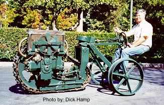

In this forum, we have a soft spot for 2-wheeled tractors, so I was wondering which one might be the largest in the world? I don't know the answer, but it could be interesting to see some candidates, though we probably won't get even close to the Big Bud
When it comes to "conventional" 4-wheeled agricultural tractors, most of us have a pretty clear idea what such a tractor looks like. Perhaps it's a little more tricky when it comes to 2-wheeled tractors, as they come in more shapes than their 4-wheeled cousins. Some larger 2-wheeled tractors have small supporting wheels, but in spite of that, we still call them "2-wheeled". As I was looking for a large model and candidate for this post, I leaned on the German word for a 2-wheeled tractor "Einachsschlepper" which in English could be translated into "1-axled tractor".
