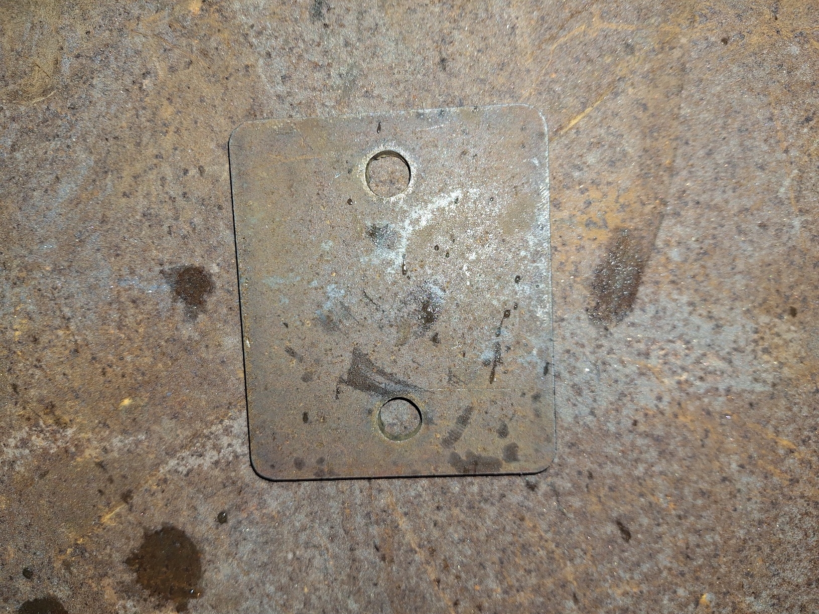

So next project is going to be some protection from falling limbs, branches and to help protect me when I flop her. (Not if.... I have rolled and flopped too many vehicles to not do it eventually) 🤪 This may be slow, but this thread will keep me motivated to get it done in a few weeks hopefully.

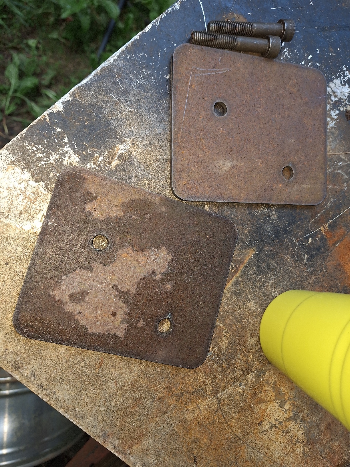

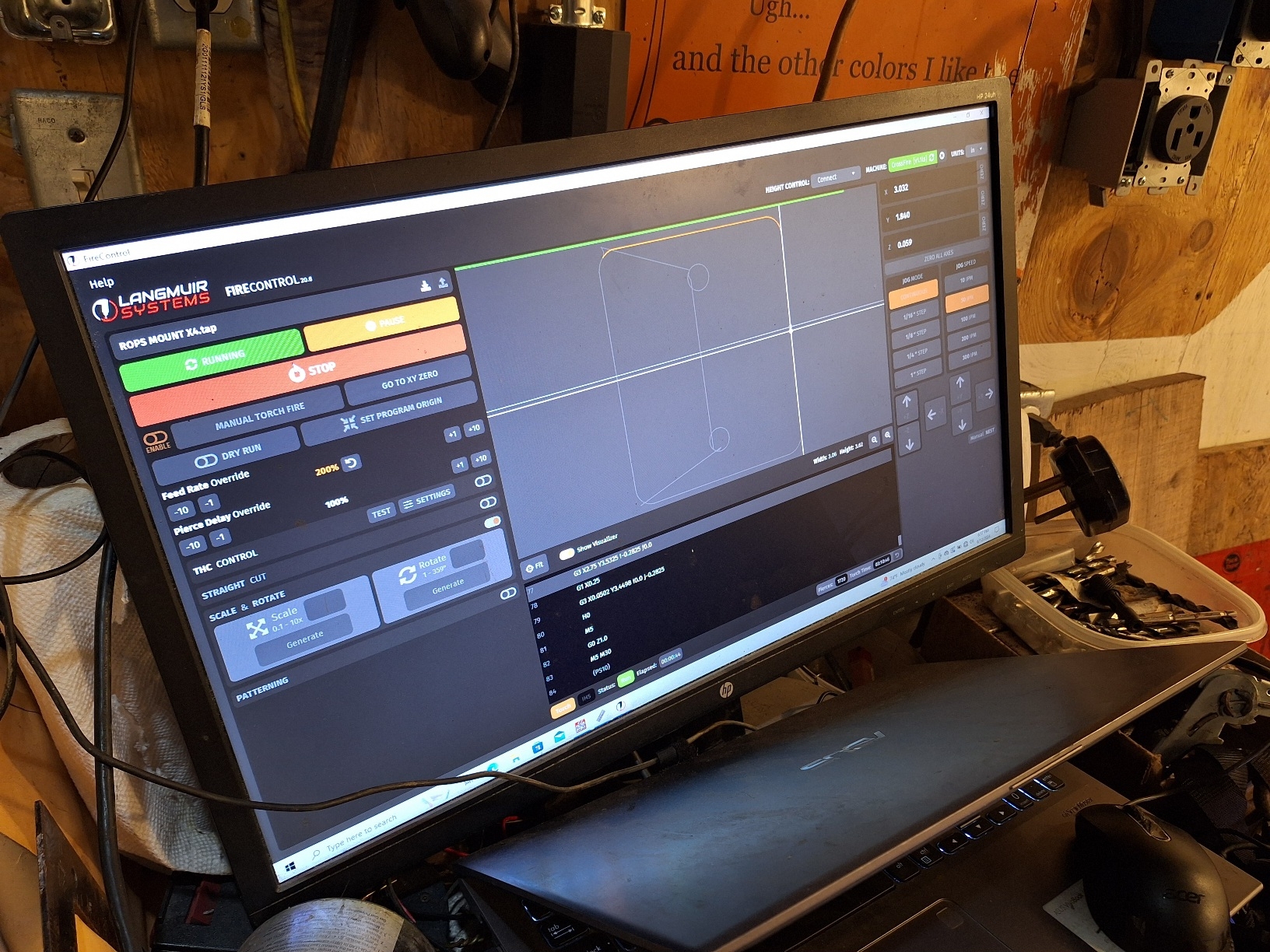

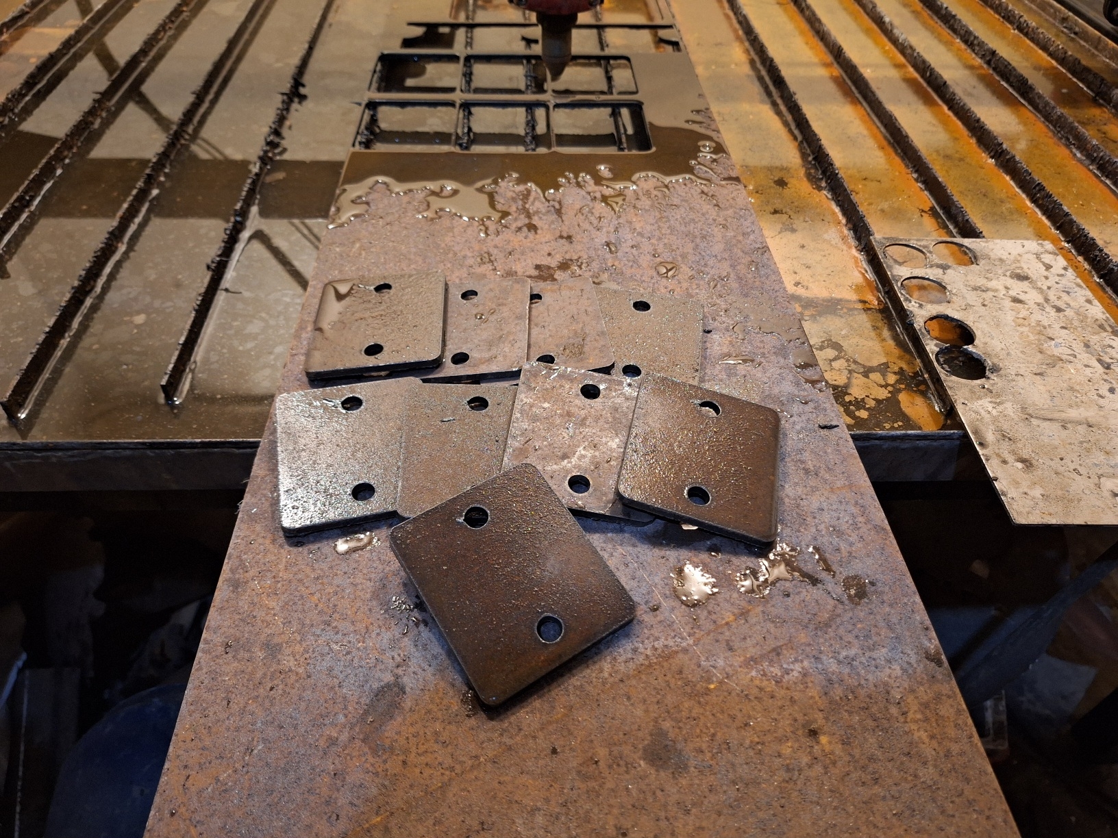

Plan is 100% bolt on, cut a mount for fit and function or proof of concept.
Woop! It fit.....multiply...multiply...
Sorry no fit pictures...
   / The lets build a cage for our kubota B2601...
Just cut these an hour ago or so...
YUP...They fit....

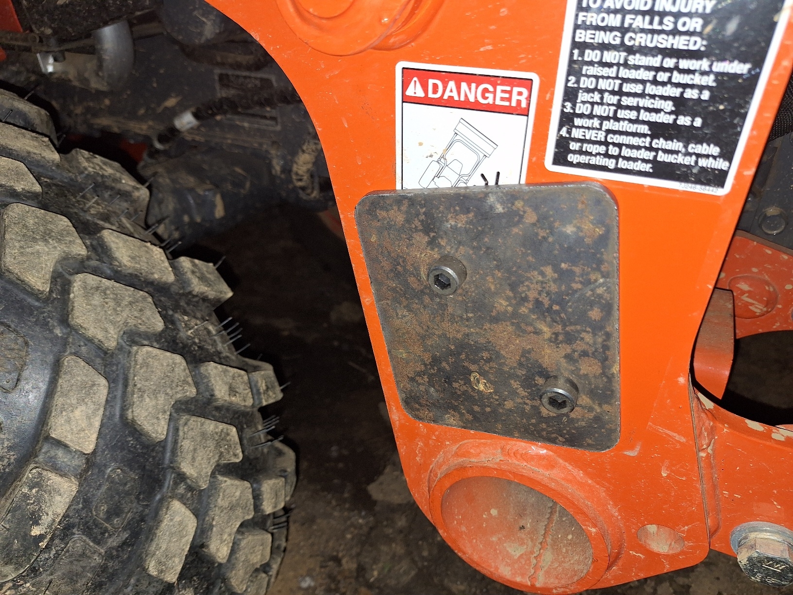

Mounting for the front posts?
Small brackets are for the ROPS connection or
("B" bar). The bigger ones are for the ("A" bar)
These are 3/16 thick. Got the day off so we are going hiking with the dogs, will do more tomorrow or maybe tonight.
Plan to incorporate a lot of things, tool box, saw mount, shovel, chains etc.

Yes, all removable as per factory design. I am at 2 holes to drill so far 1 each side of FEL.
