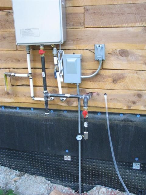

I plumbed the whole house for propane. 3/4 copper from the tank to the house, then 3/4 black pipe to the instant hot water heater and through the wall, then 1/2" copper through the floor trusses with shut off's to each appliance. Copper inside the house was a dollar a foot cheaper than black pipe so I taught myself how to flare fittings...pretty easy. Then I put a gauge with a schrader valve on it and put 10 psi of air into the system last night. 14 hrs later it shows 9 psi and 10 hrs after that it is still holding at 9psi....so I think I did things right.

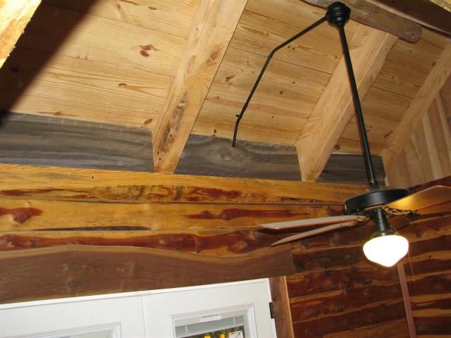

I also got the inside gables done in Poplar:

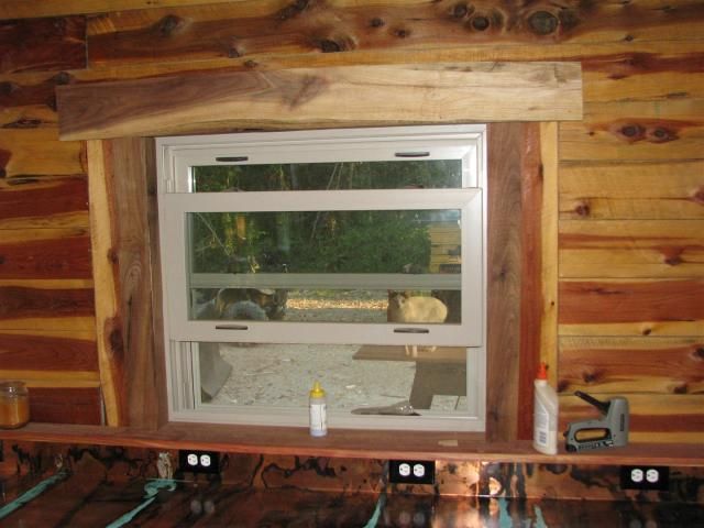

Kitchen windows trimmed out in Walnut:

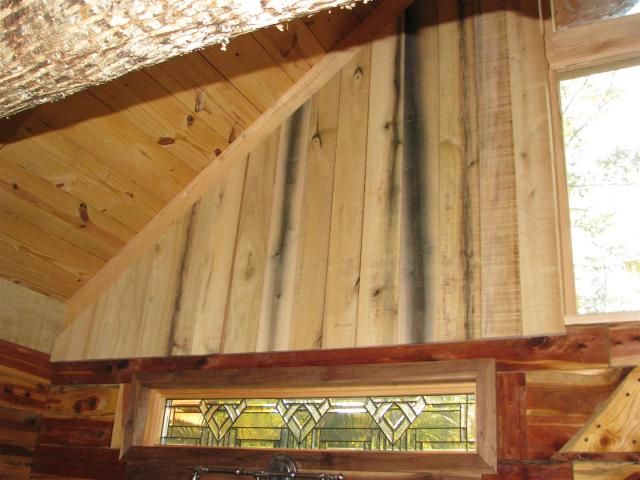

I insulated and installed all the interior bird blocks:

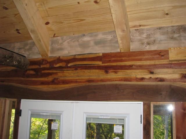

I used some really dark spalted Poplar in the master bedroom:
