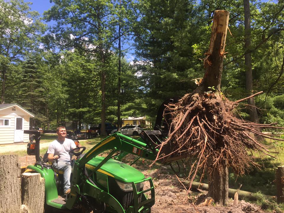

In addition to the pics Travis posted above, I have found the "teeth" enable me to grub out and remove stumps that are WAY bigger than I should be able to remove without a backhoe. So I am in IT's and Cat's camp here regarding grabbing roots.
I simply work in from the edges and push in and under the peripheral roots, then lift a bit with the loader to lock on and then reverse a foot or two. The creeper roots simply snap as the teeth slice through them, and then I go back for another "bite". I was amazed how strong just a handful of connected 1 - 2" roots really are. After circling a time or two and slicing the roots, I can usually get in the middle and gently rock the stump out, especially if I there is any trunk to amplify the leverage. To each his own though right?
This shot also shows how centering force in the middle is made really simple with a single lid and aids in the final push/pull effort. (Although I do acknowledge many applications were dual lids are better as well...)

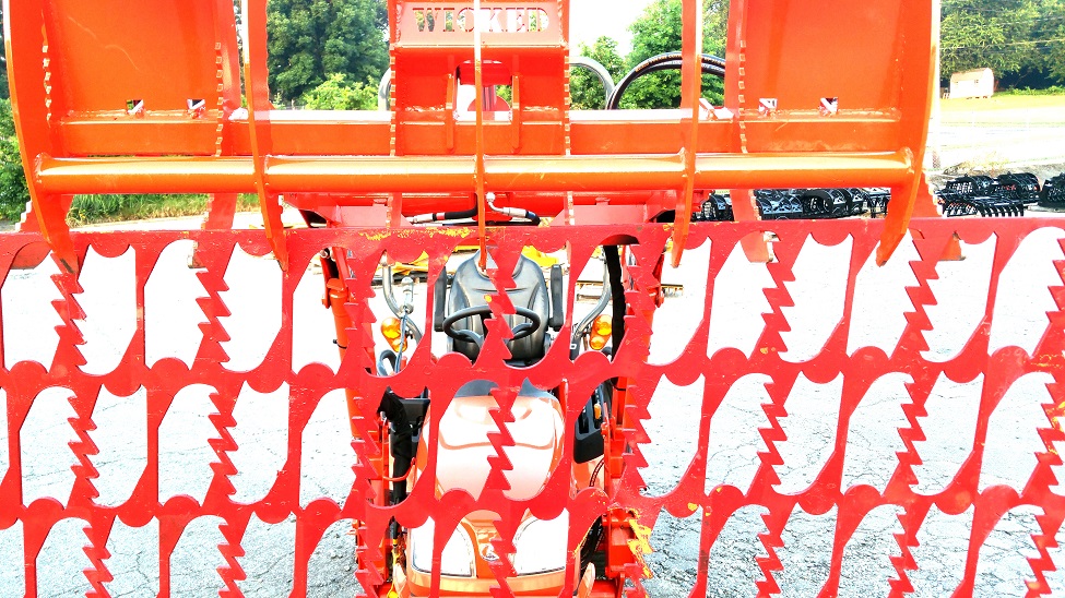

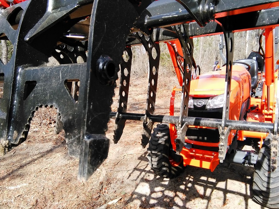

As shown below, there are definitely cheaper and easier ways to make grapple tines, but cheap & easy is far from making it to our list of priorities!

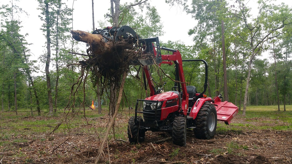

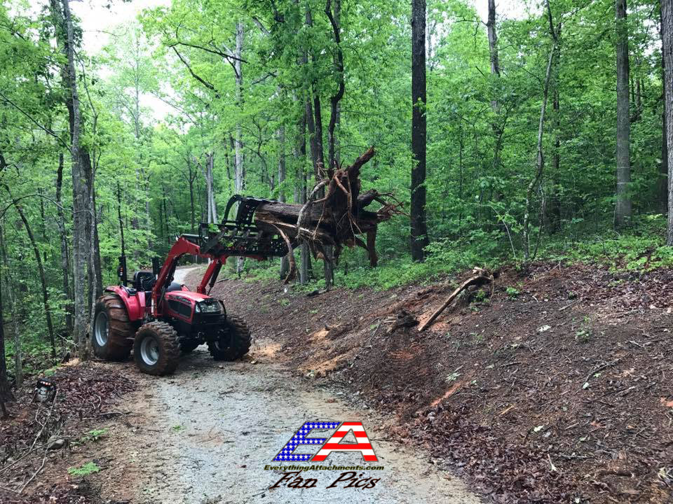

Very nice assessment! :thumbsup: The concept is catching on already. This doesn't even scratch the surface(pun, pun! :laughing:) of my awesome pic collection showing off Wicked tine advantages.
You guys truly BLESS us with so many and we are forever grateful for it! :applause:
Travis
Mahindra 3550 with a 60" single lid.
John Deere 3046R with a 60" single lid.

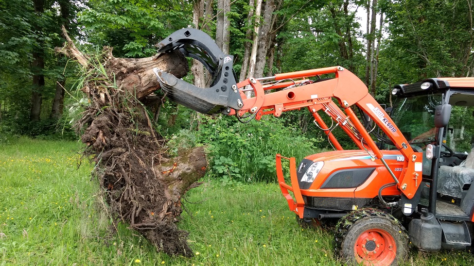

Kioti NX5510 with a 66" single lid :shocked: Double Stuff :shocked:

As the owner of a grapple with the "cheaper and easier" grapple tines like in the comparison photo Travis posted, I have to point out some advantages. The backwards curving and very sharp teeth on the EA grapple are great for grabbing but as others have pointed out are problematic when it comes time to dump material like brush. I don't have an issue with snagging when dumping brush. No doubt the EA tines would grab and cut roots more easily but I do fine.
I don't find the traditional style gusseted tines to be limiting. I don't use the grapple to plow through turf so a wider disturbed area isn't an issue to me.
I'm also not so sure about the traditional construction being cheaper. Every tine tip in the traditional grapple has gussets welded on four sides, top and bottom. Lots of tacking and welding time. EA doesn't have any welded gussets and uses laminated tines for strength. Good design but cheaper to build IMO.
Think about the nesting and laser time required to cut these Wicked weldments. Once cut, a trip to the press brake, yes, to bend 16 of them for a 66" or 72" grapple.
Cheaper? :confused3: Not in any remote sense of the word.
