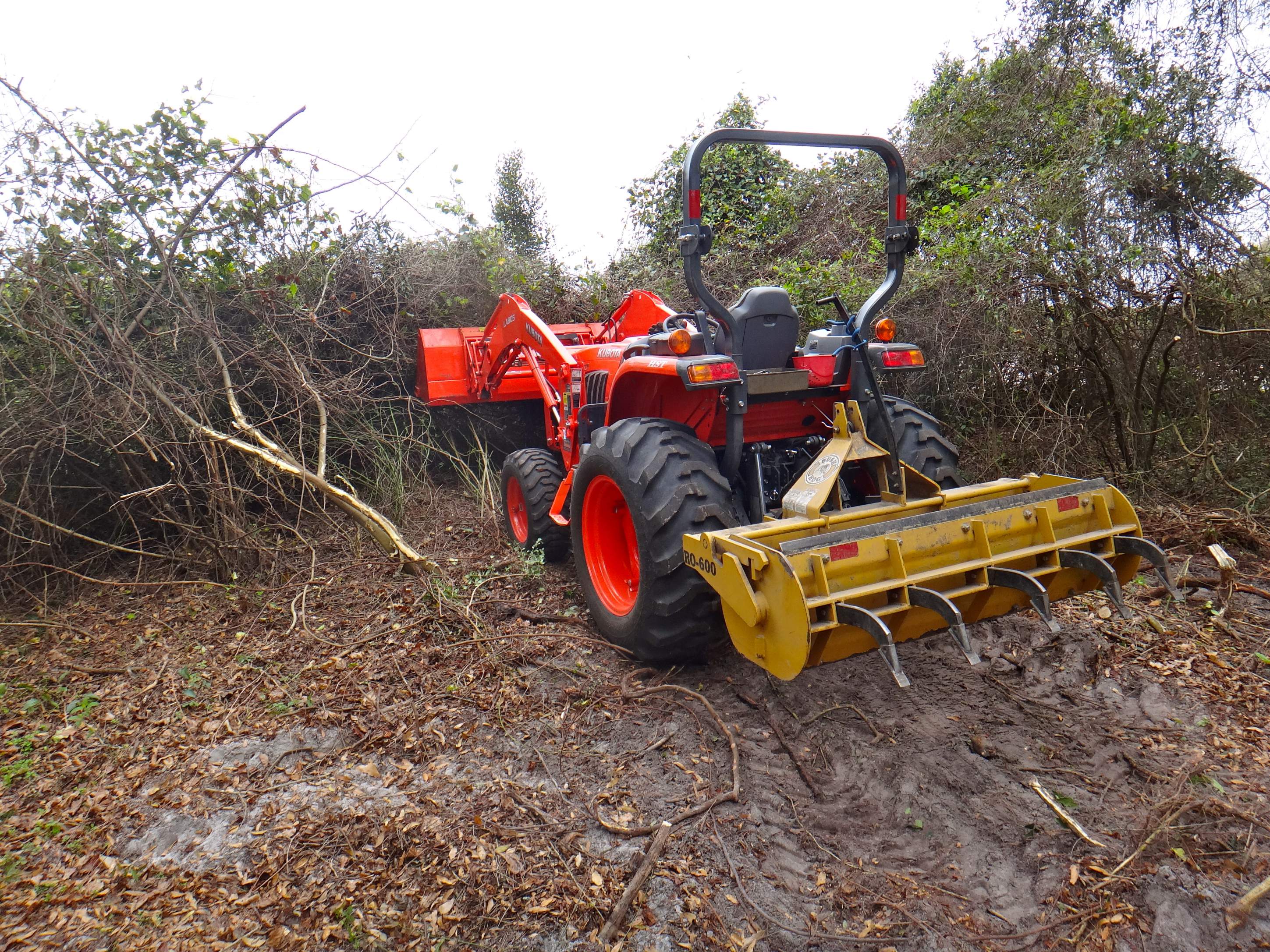

Ballast Box OR loaded tires; not both for a B7800.
Loaded tires are ballast; loaded tires are not counterbalance. The Ballast Box or an implement carried on the Three Point Hitch will be more versatile. Weight behind the rear axle (counterbalance) unloads stress from tractor front axle and bearings.
I normally use my 630 pound Box Blade as counterbalance on the Three Point Hitch, this is nominally 36% of FEL LA805 lift of 1,715 pounds, but since Box Blade is cantilevered to the rear the effective counterbalance is greater than 630 pounds, probably 900 pounds effective. This has never proved inadequate.

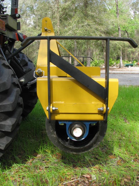

When maneuverability is important I mount my 650 pound Cultipacker on the Three Point Hitch. The Cultipacker rides very close to the rear of the tractor.
Photos #1-#3 Rollover Box Blade as ballast.
Photo #4 Cultipacker as ballast.

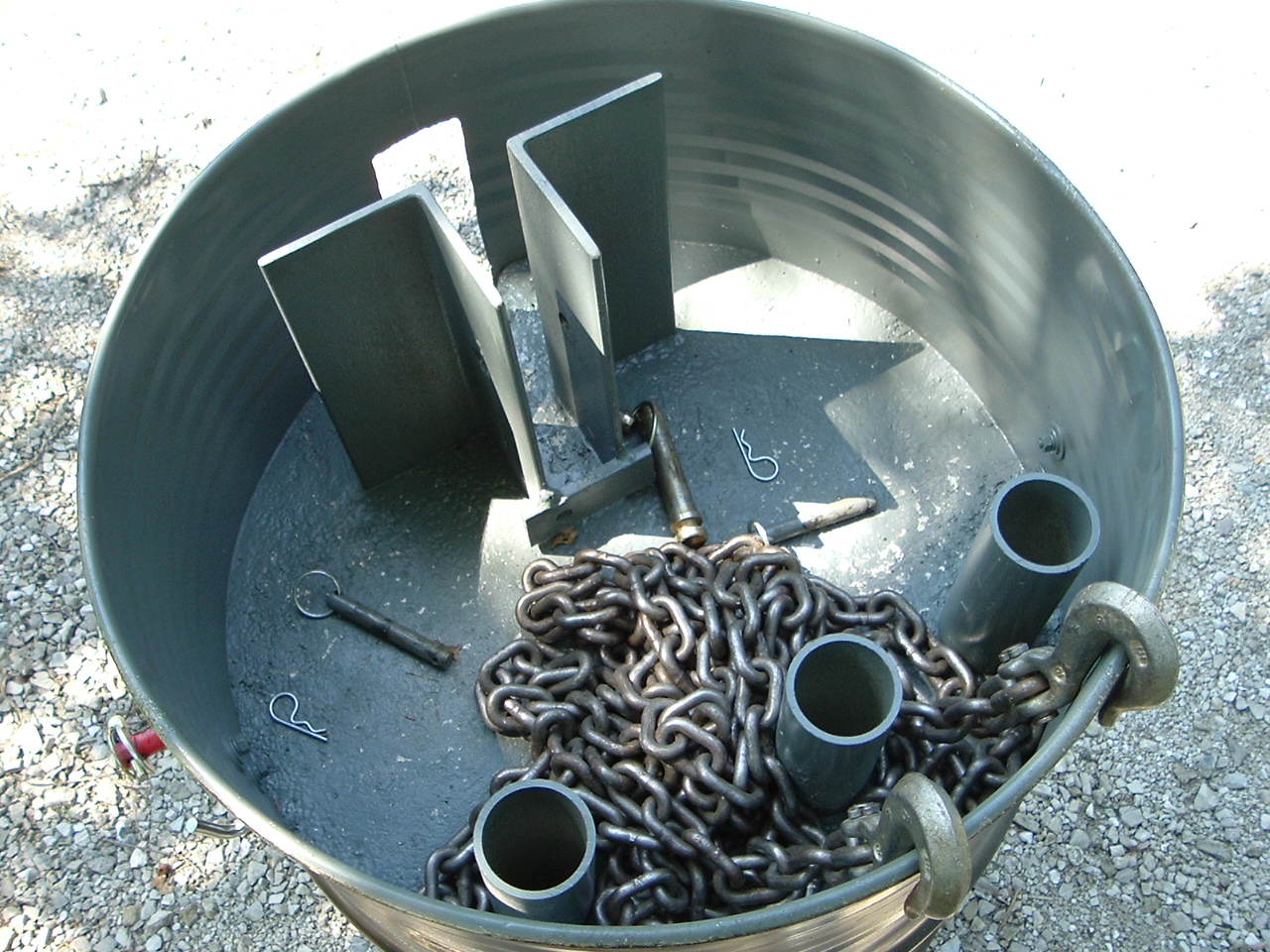

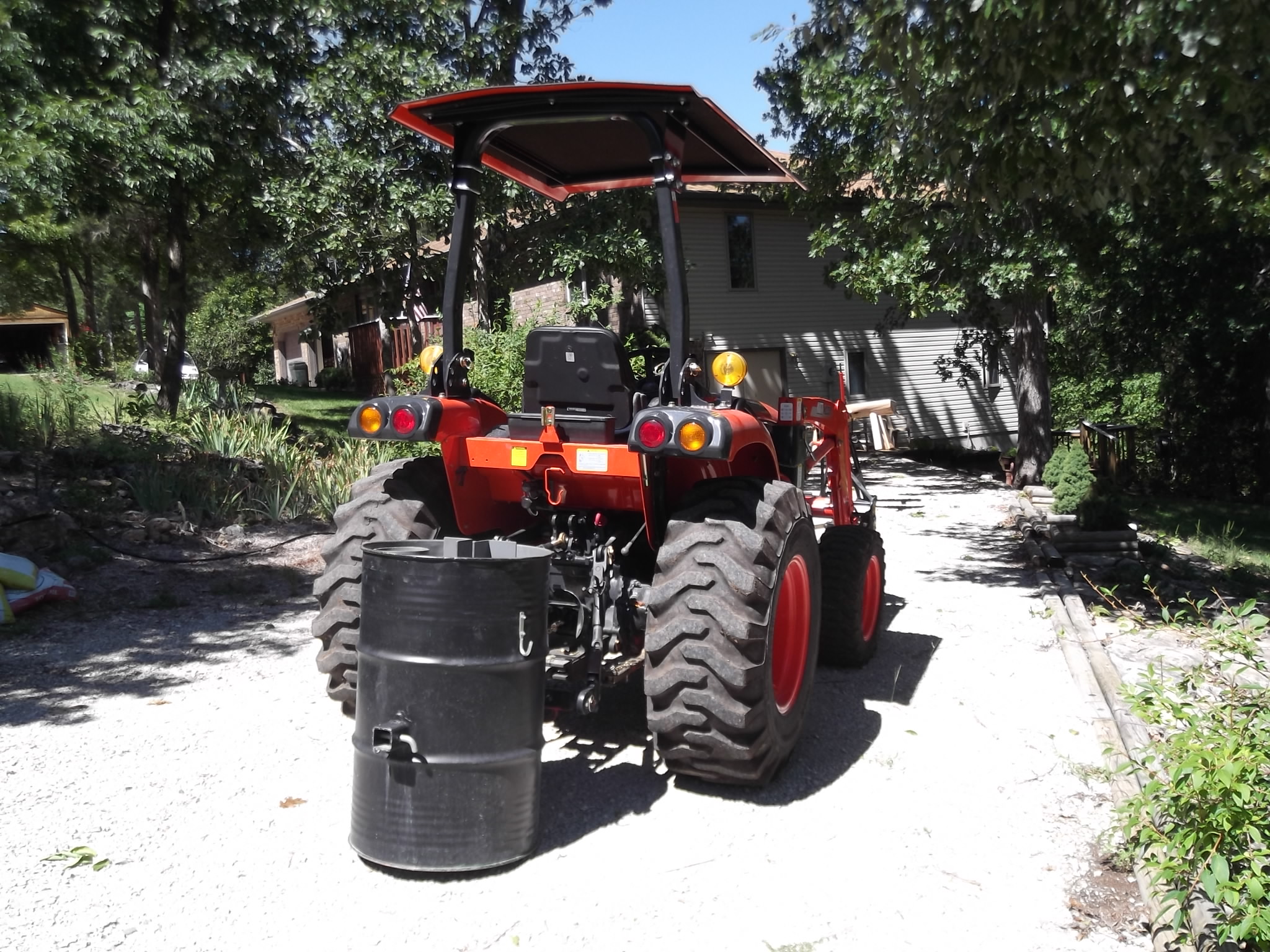

   / Theory of rear ballast? #6

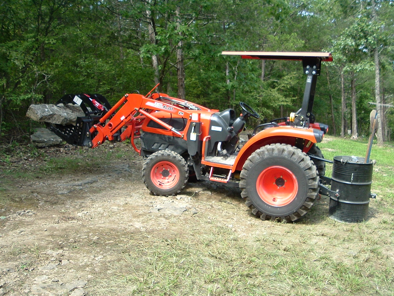

I have both loaded tires and a ballast box. Both help, and sometimes in different ways. Remember you are not always going to have the ballast box on. For instance pulling my rear blade loaded up with snow or dirt, The rear loaded tires are helping me maintain traction to pull that load. The ballast box is back at the barn. When operating my loader with full loads of stone up front, I am glad I have the ballast box to help unload the front axle, and the loaded tires are helping to keep them planted on the ground too, even if they are not helping unload that front axle.
When I am mowing on a side-hill, the loaded tires are helping me with lowering my CG for stability, and again the ballast box is back at the barn. My ballast is a 55 gal concrete filled drum but about 10 inches of space at the top for carrying things.
Would a square box that was wider at the bottom be better? yes probably. It would keep the CG even lower. Of course too wide and you have to start worrying about swinging into things, also too far back, while that helps with leverage, you also have to start worrying about hitting things. You decide how wide and how far back. It is a trade-off.

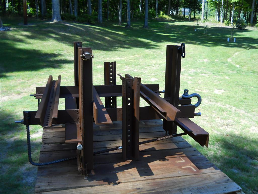

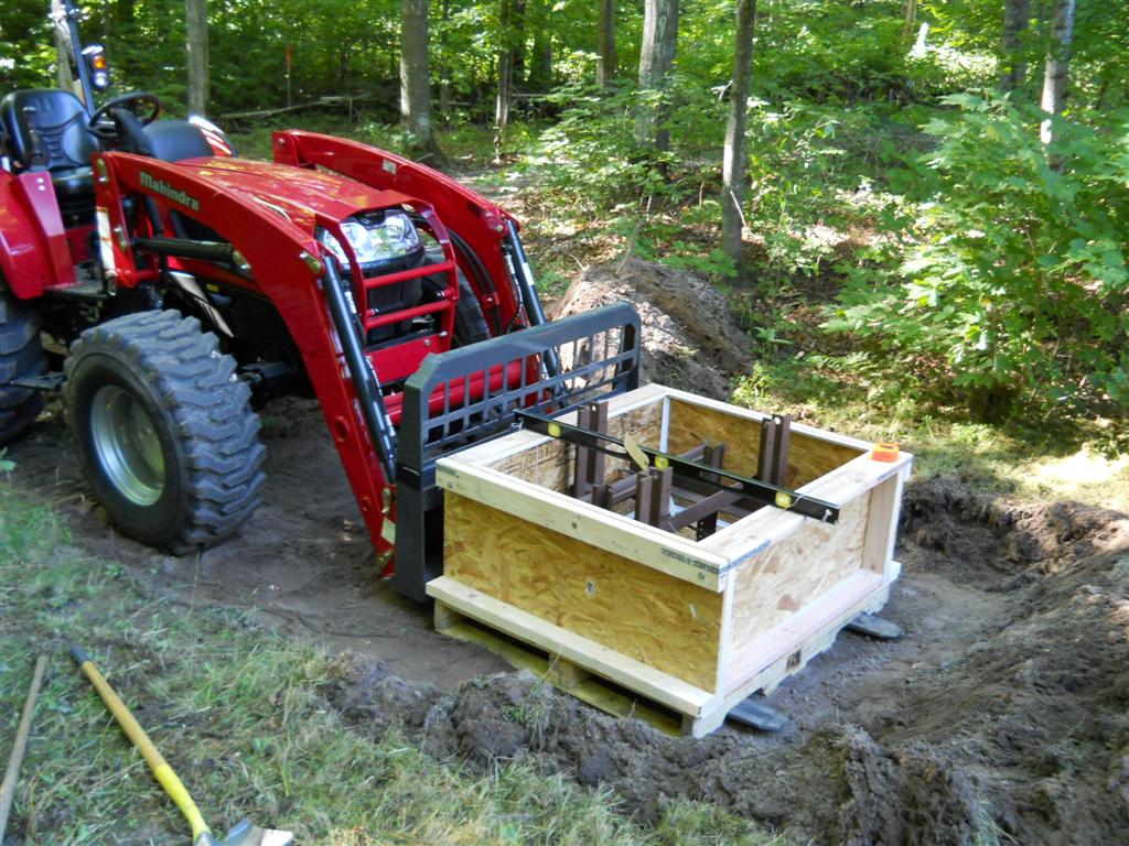

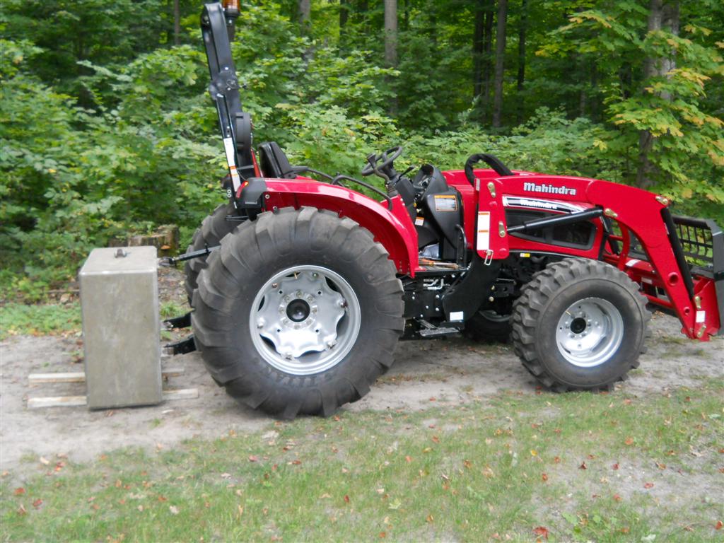

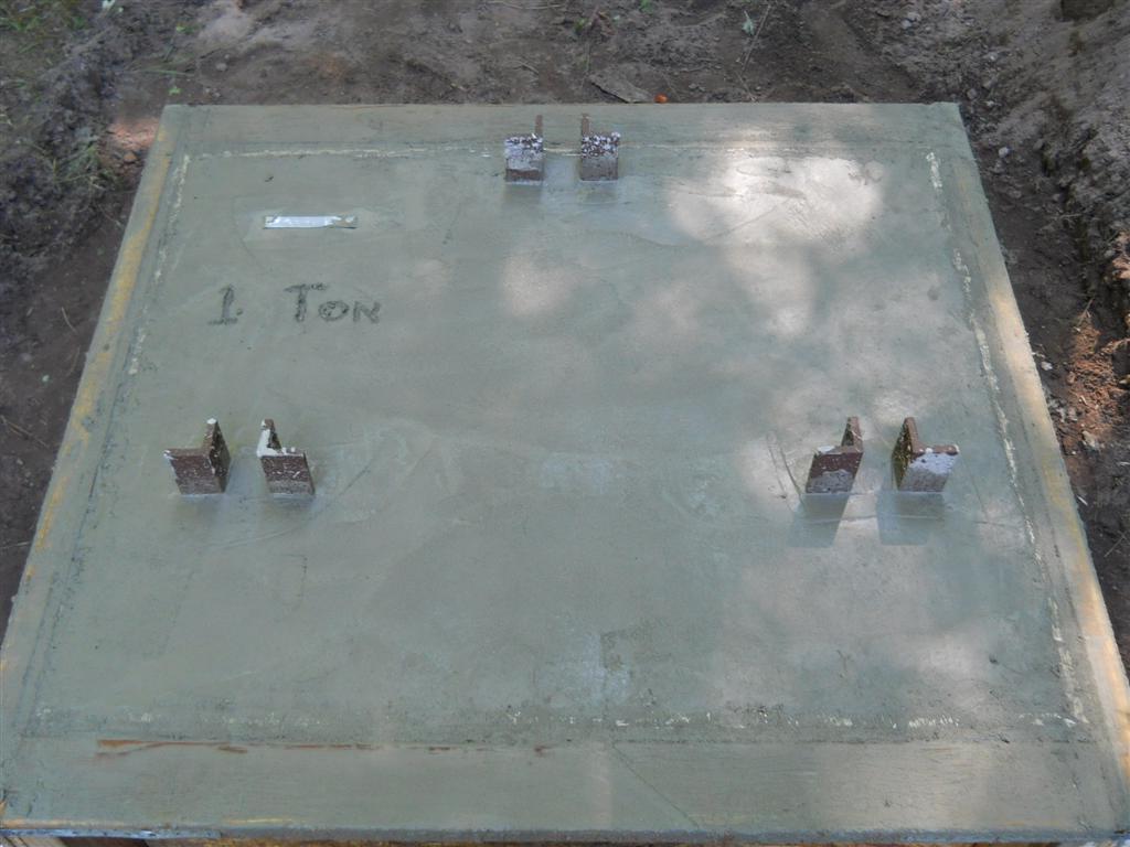

   / Theory of rear ballast? #8
A ballast on the 3pt takes load off your front axle and adds rear traction, whilst filling the tires mainly just adds weight for rear traction. For heavy loader work, rear ballast is better on your front axle. But each has drawbacks. Loaded tires allow you to put something lighter on the rear to use, or work without anything back there to maneuver in tighter spaces. But you always have that weight with you, can't drop it off. Extra weight to haul if you trailer. Ballast takes up your 3pt and sticks out some, so you have to allow for it back there in close spots. So, not a good answer either way. I'm a ballast guy, and have not filled my tires. But to each his own.... :) Here's a one ton I made.... [ 99% of the time my ballast is 1500#'s of American made backhoe ]

   / Theory of rear ballast? #9
That looks really nice Jerry.
Looks great. What is the weight of 1 cf of dry concrete? How did you chamfer the corners?
