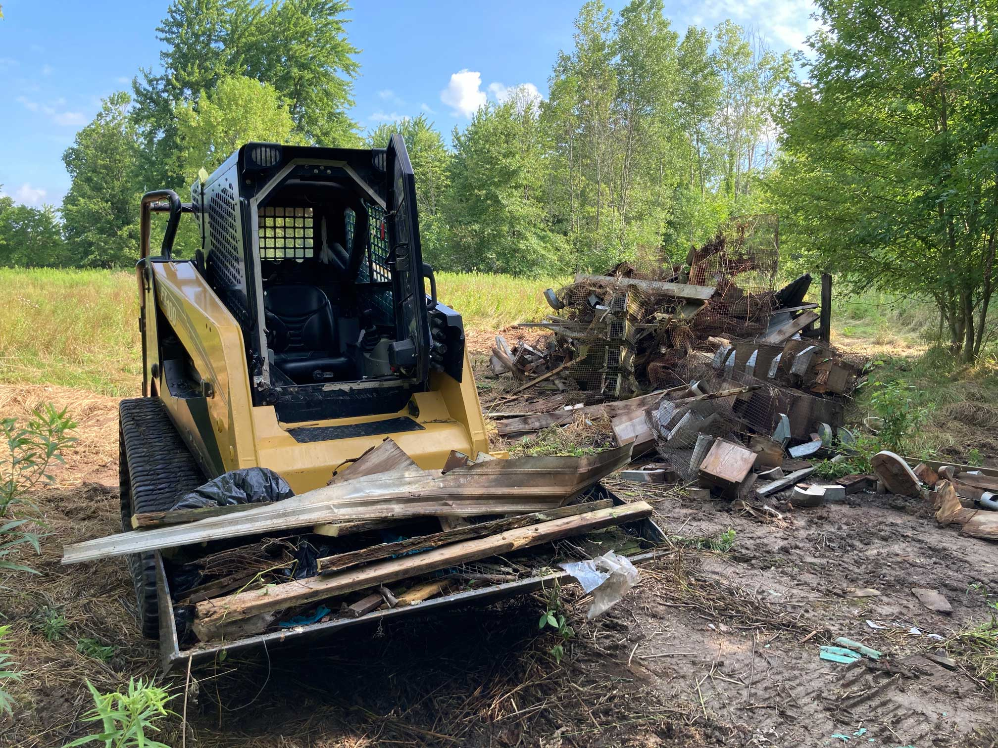

I decided to go easy on the machine for a while to make sure it is working properly. I did some low-rpm work demolishing the remains of a derelict (rabbit? mink? ferret?) house that has been gradually sinking into the mire. I did a lot of the demo with a pallet fork and a bucket; not really the right tools for the job, but it's what I have.
I'll be glad to be rid of this structure; it had something like 200 wire cages wired up in rows, each maybe 12" x 12" x 18" with water bottle and a pellet feeder. I eat meat and don't have issues with wearing fur, but animals deserve better lives than that.
