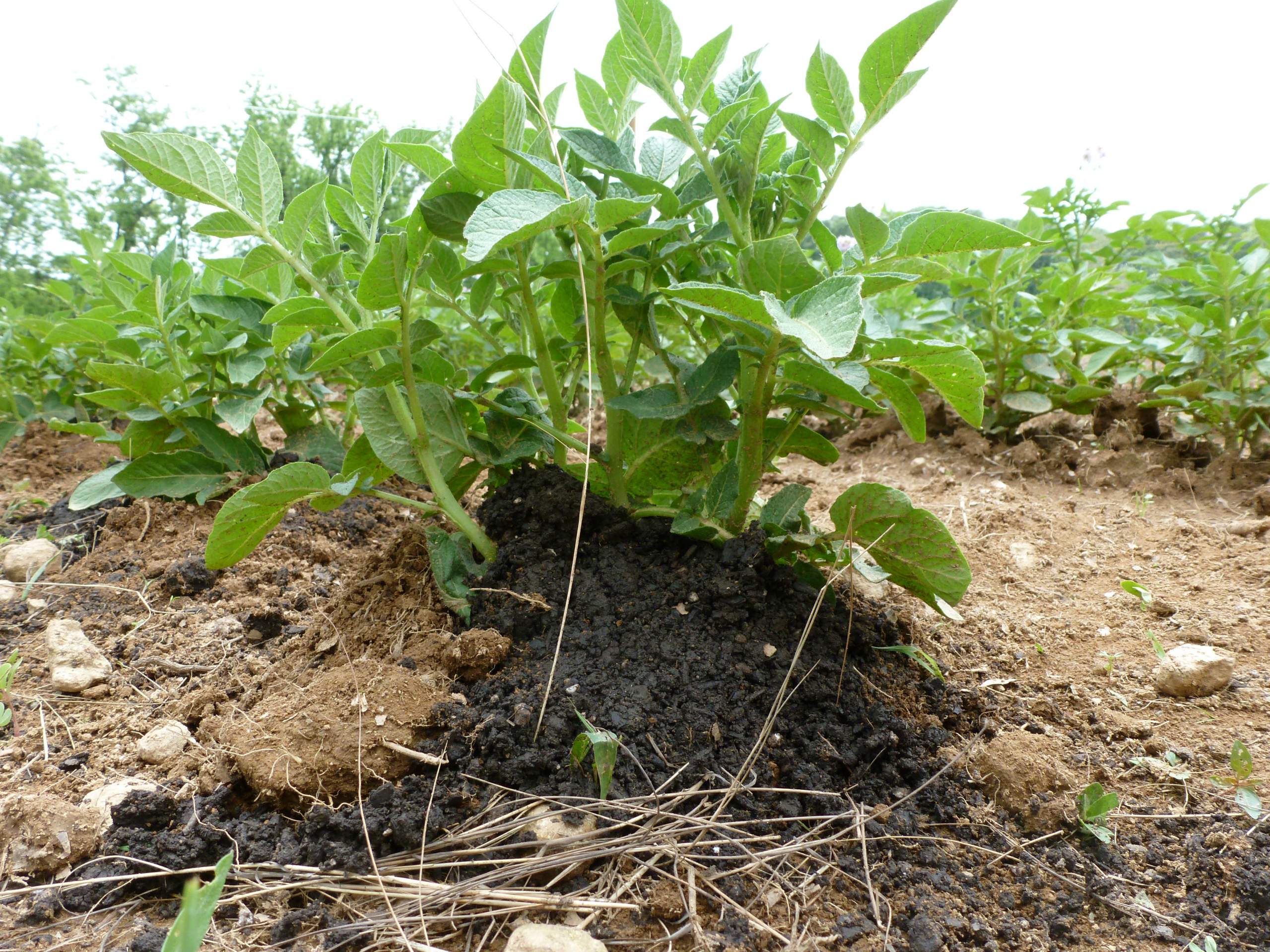

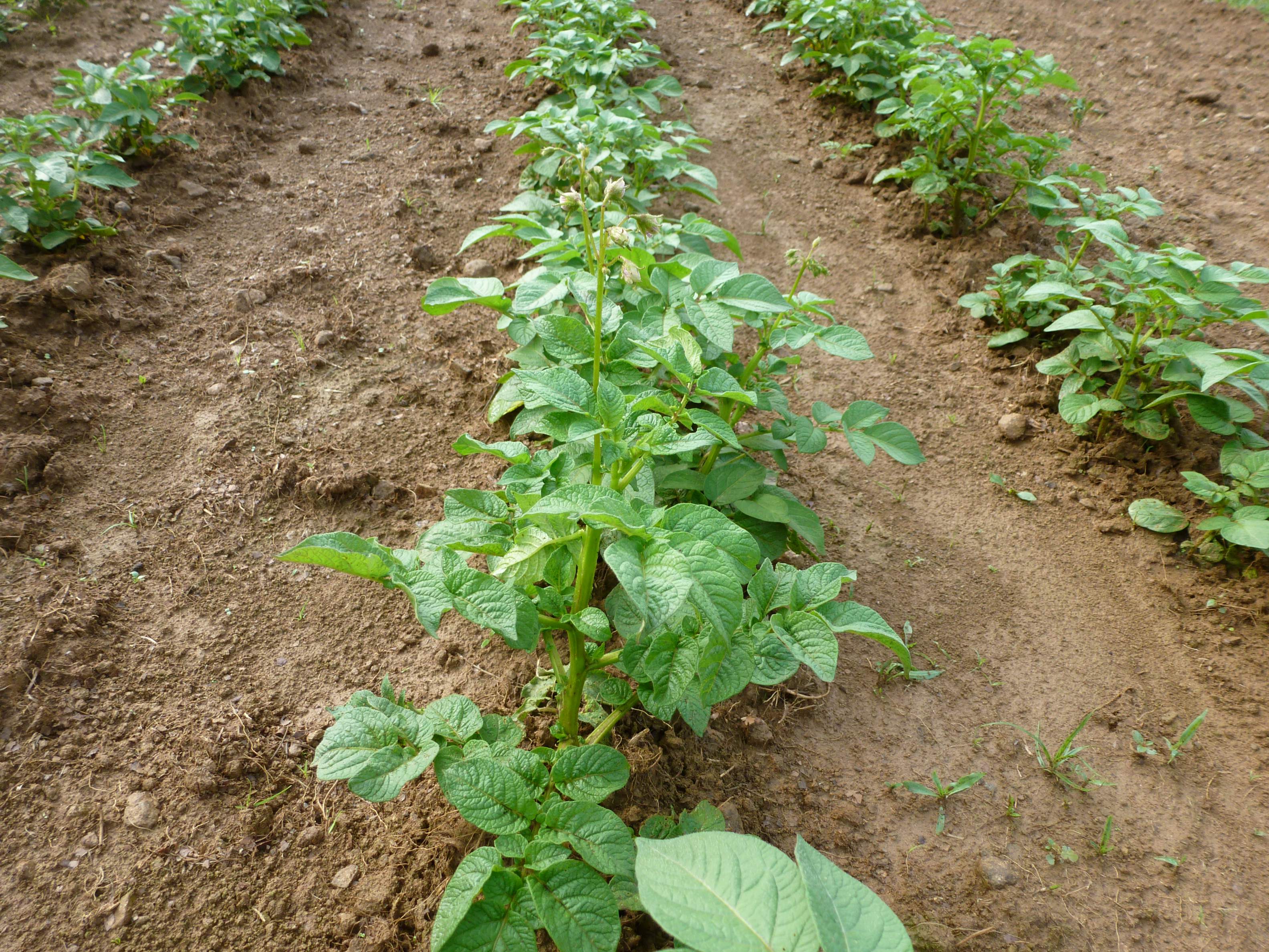

in looking at these pics for another post, I realized the plants were already growing pretty close and leafing out. Is there a minimum distance I should maintain? And do they transplant well to another sparser location if handled carefully? Thanks My understanding is that plants too close to each other limits the size of the potatoes, too much competition for space. Drew

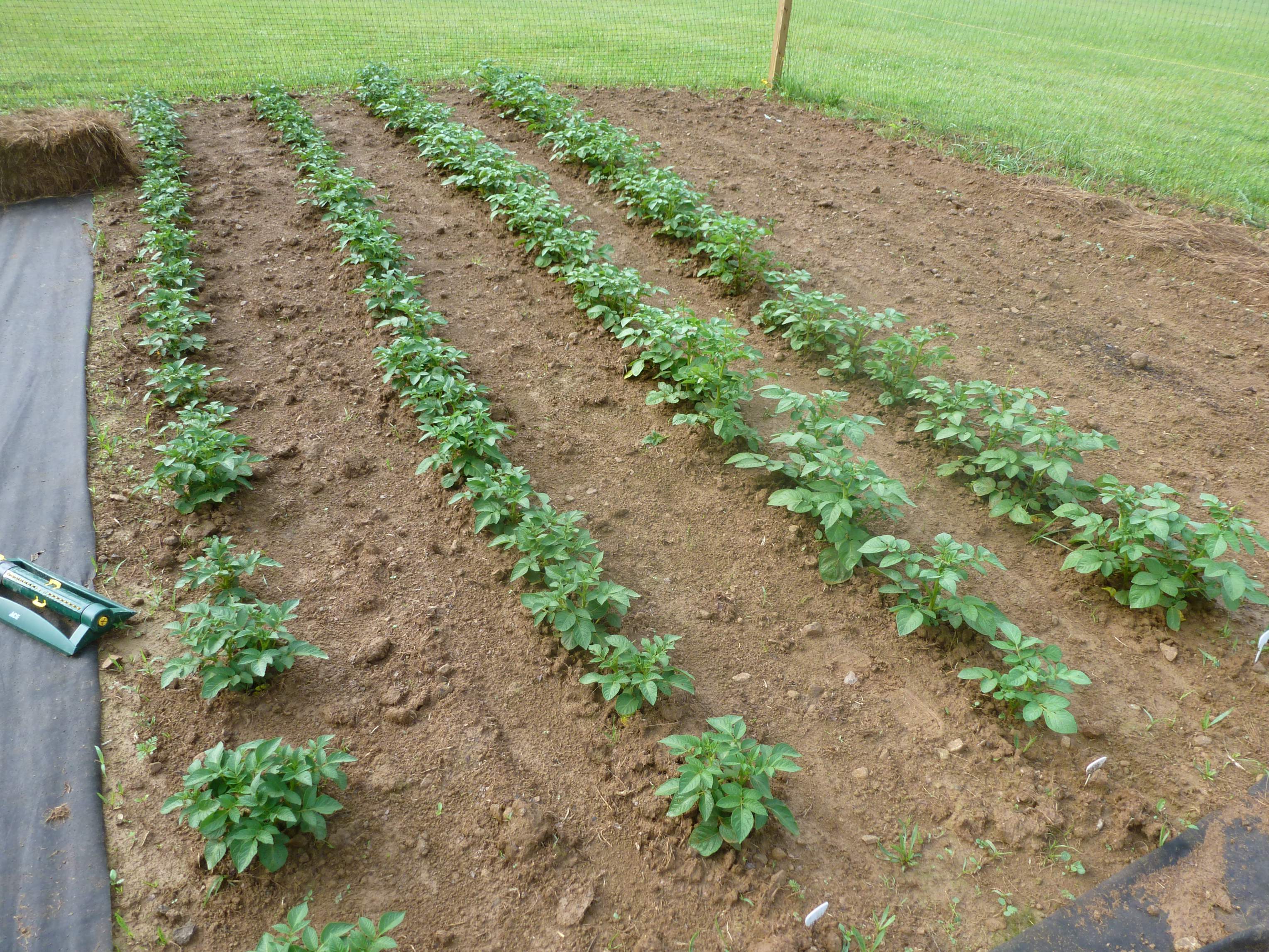

what I'm hearing is that if I get enough dirt over them originally, it's probably ok, but I have lots of hay, and after one more hoeing, I'm going to pack the hay under everything and just relax and wait. They are starting to flower and growing nicely. Bird, I love your use of the FEL, necessity is the mother of invention, and sure shows that a good tool used well can do many things.
So, I'm not going to thin the potatoes, though I did transplant about 70 ears of corn to fill in where things didn't grow; now that was a chore. Will be curious to see how they survive transplanting, as careful as I was. I have a second batch of potatoes coming in now, boy all that green sure makes the garden look nice. Thanks to all.

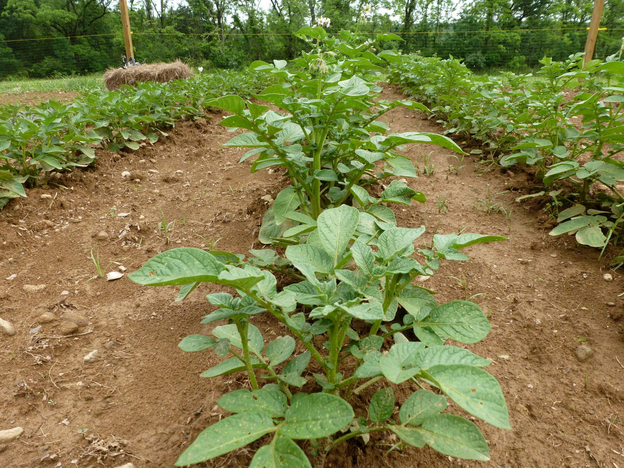

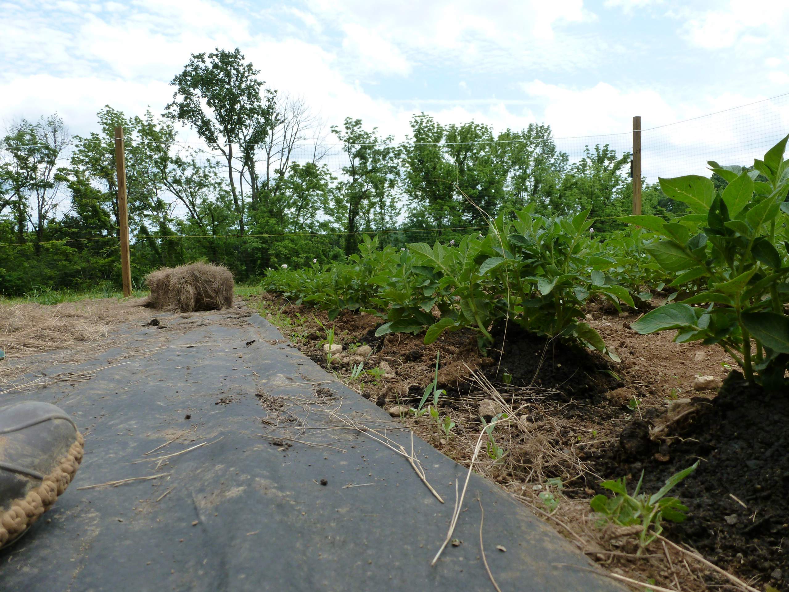

I packed in some cheap Ace hardware organic potting soil in and around the potatoes, making sure I got some dirt down in the middle of the plant.
This has to be plenty...next comes the straw and a lot of patience.
