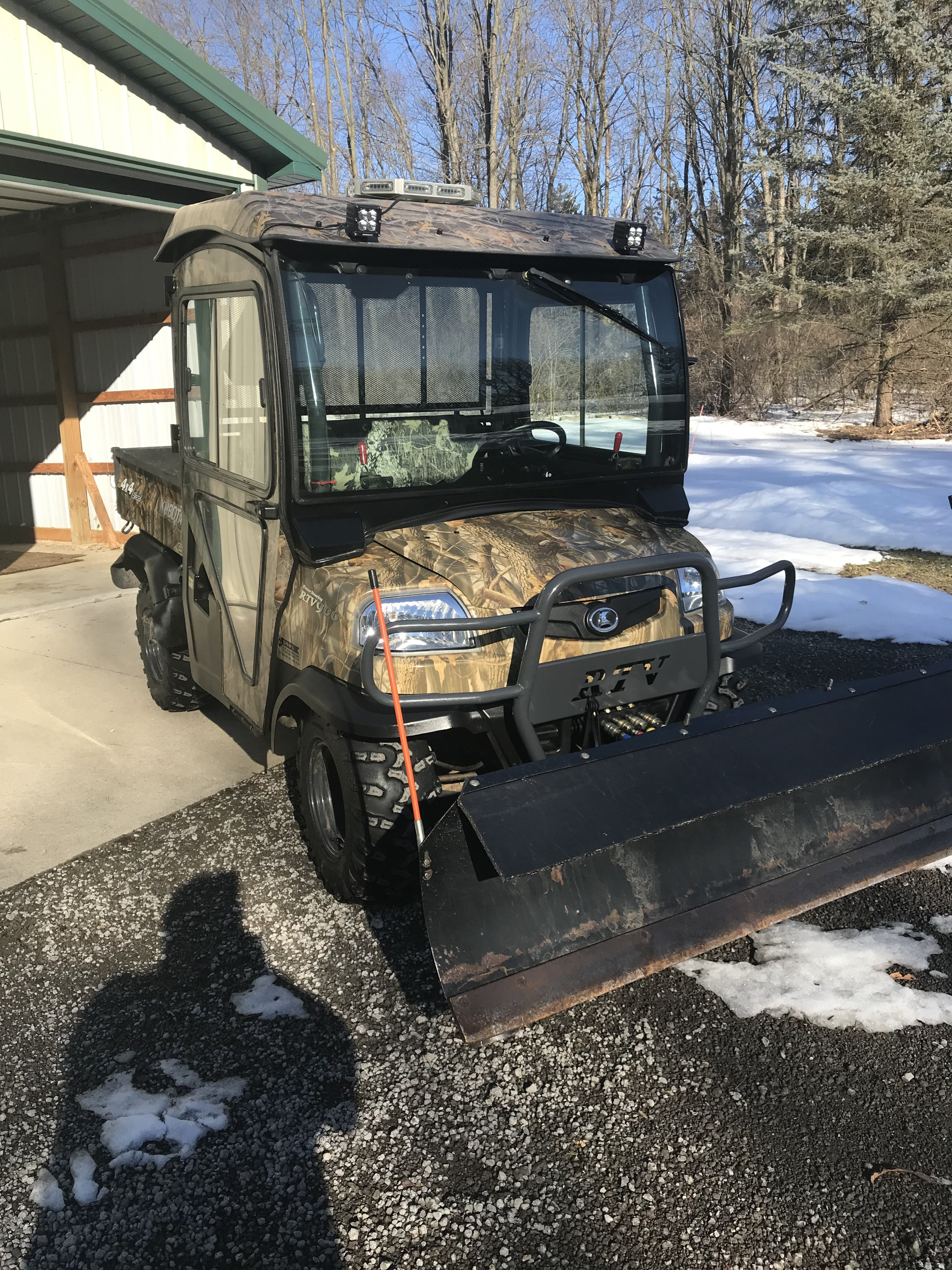

I sold my 2006 RTV 900 with 1100 hours last winter for $12,000 with snowplow..
