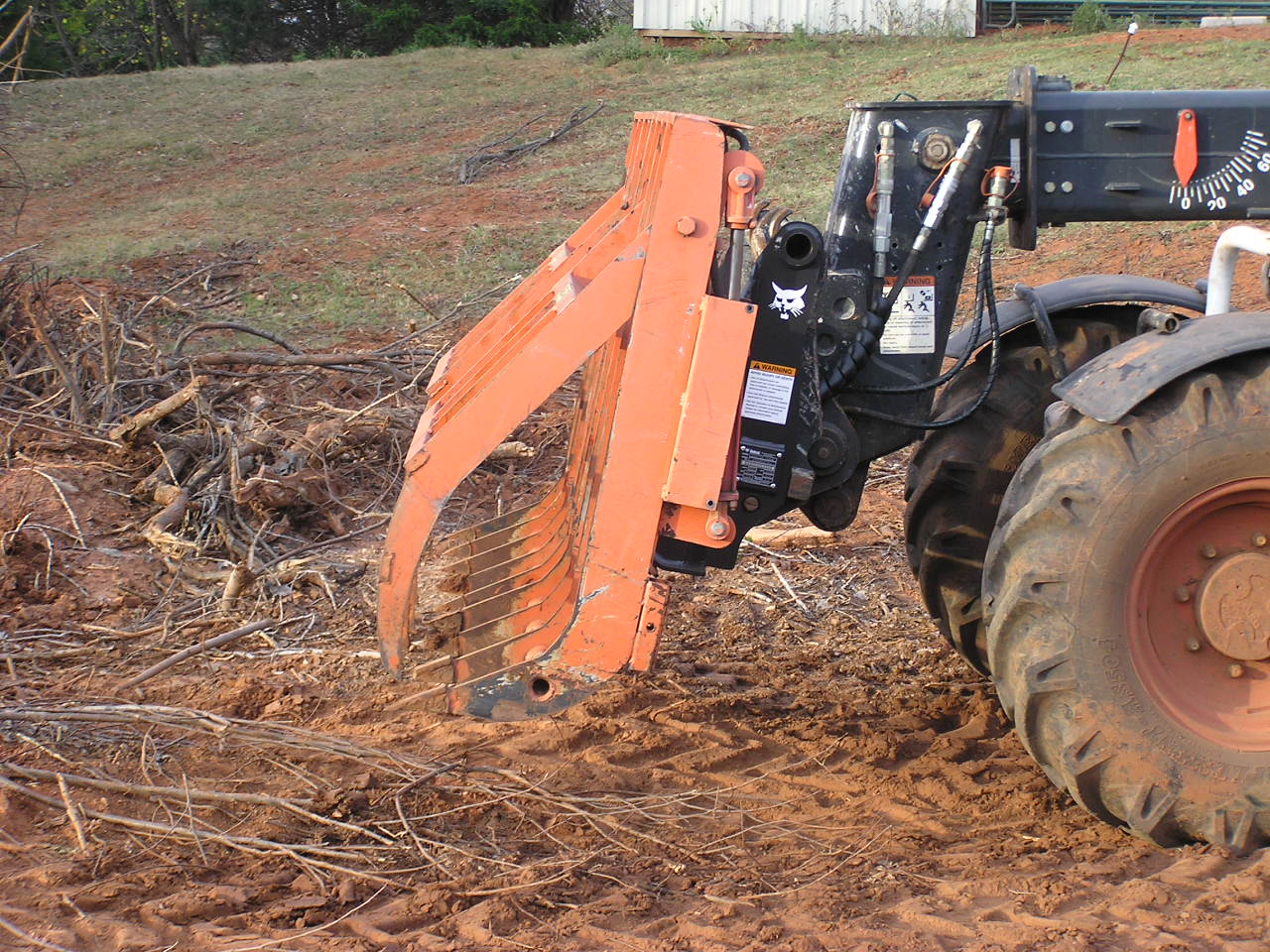

Mine seems to pick up brush piles very easy. (Picks up things it shouldn't too) image.jpg

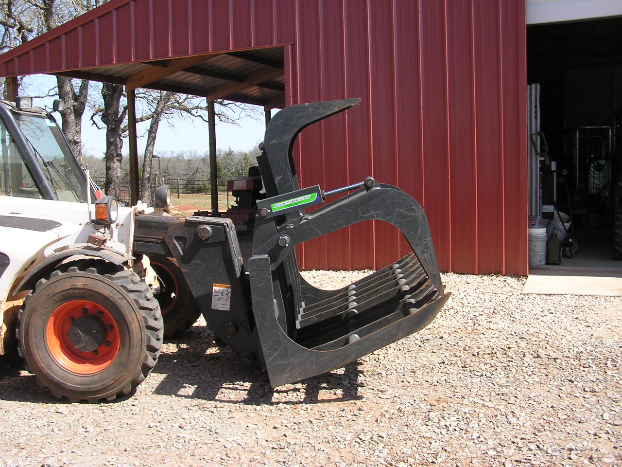

A place just down the road from me carries Armstrong attachments/implements. I like that this grapple opens really wide, just concerned about the bottom side not extending out very far. I want to pick up brush, which it should have no problem with, but I don't want any problem picking up logs up to 18"-24" in diameter.
My first ever grapple was that style, works like a dozer blade for removing brush. Not great at picking up brush, good for picking up logs. Sold it when I sold the V518.
For picking up brush, and logs, I prefer this style. :thumbsup:
