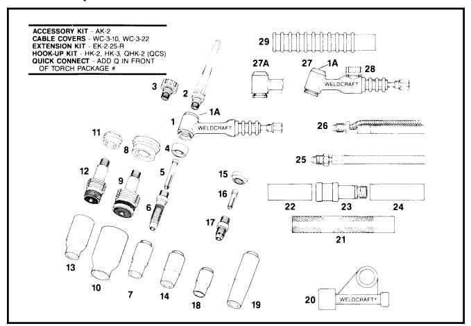

I got a shipment of parts for my TIG torch today. I want to get set up with a gas lens. I have a 17-style torch. I ordered the lens, the insulator, and the nozzle/cup. When I was looking at the Weldcraft web site, I didn't see a dedicated gas lens collet, but now that I have all the parts, my electrode slides out of the torch and the standard collet doesn't seem to help.If you look at the attached image, I have parts 13, 12, and 11. On that diagram, no collet is shown for the gas lens assembly. Any advice anybody could offer would be great. If anybody has a torch they could show me the proper assembly of, or link to a picture that shows a complete gas lens setup exploded diagram, that'd be much appreciated.
   / TIG gas lens parts question #2
You will still need a collet with the gas lens. Just tighten up the front end parts and the cap last. Double check the collet size.

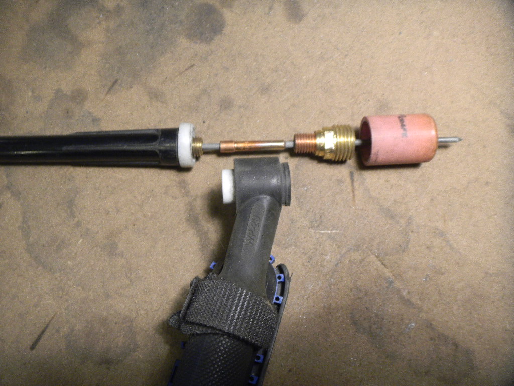

I have the WP20 Weldcraft torch.

Is it the same collet as would be used with a non-gas-lens collet body? I'm certain that the collet size was correct. Maybe I just had it installed wrong or didn't tighten it up thoroughly enough.
