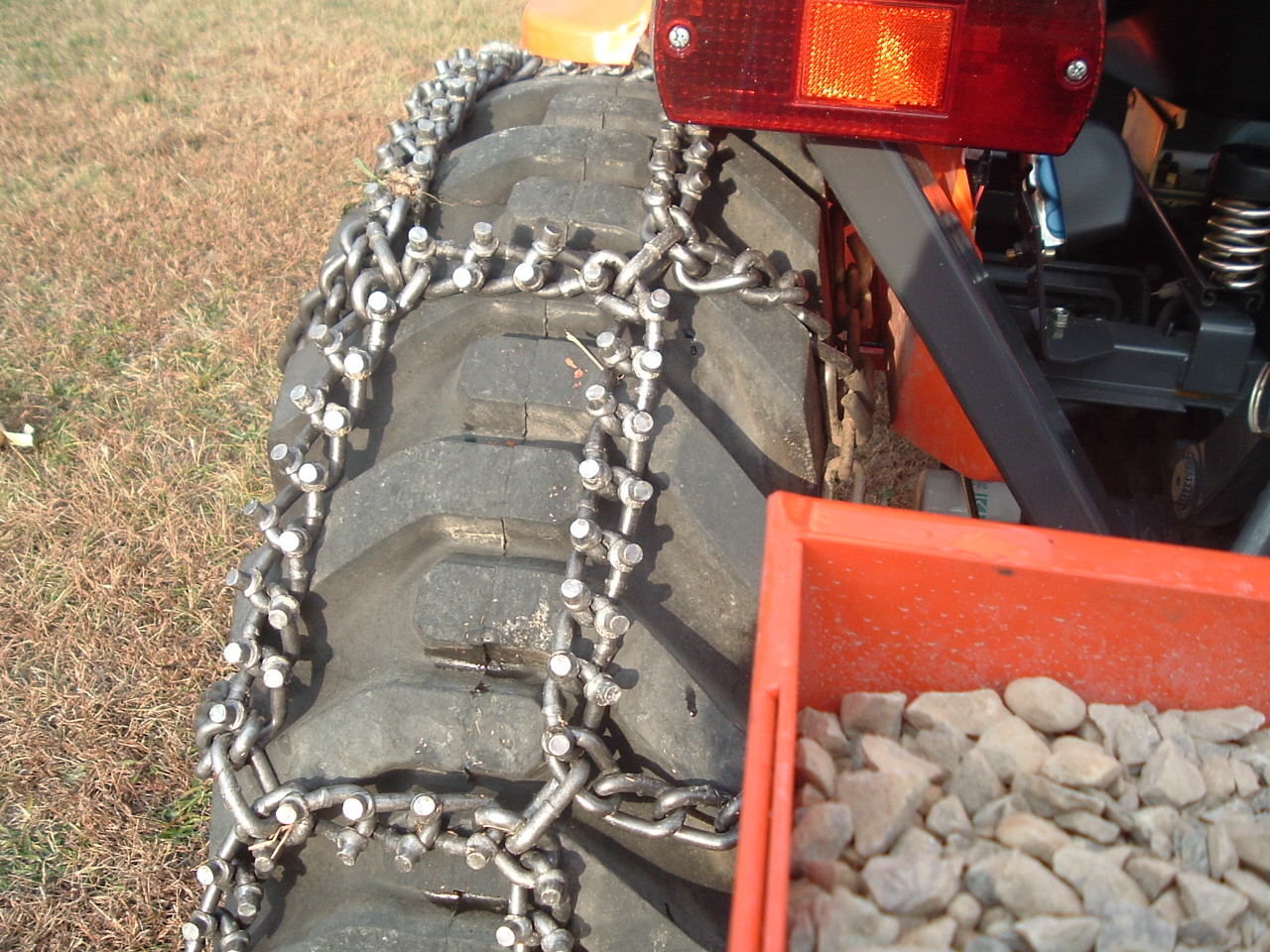

We'll see how this goes. I have 2.5" clearance between the inside wall of my tire and the fender. And 3.25" clearance between the tread on my tires and the fender.
There are two schools of thought when mounting chains. Some say they should have a reasonable amount of slack in them. Some say they should be tighter than a banjo string. I'm a banjo string type guy.
Takes a while to get 'em tight and tucked. Loose ends have to be safety wired. A wrong mount will rip a fender off. After 4 years I still have my OEM fenders. Unscathed.
This is around the house, outbuildings, and driveway chains. Driving down the road in high gear on the road for a long while would greatly change this picture.
These are my chains:
