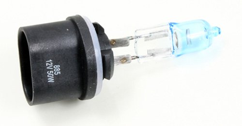

can anyone give me the bulb number used for the 4 lights top of the cab, dealer is crazy priced as usual, no number on the bulbs but all 4 are different looking, have the same connector and mounting so been changed over time.
the part breakdown say the outside ones are spot, middle 2 are flood but bulb numbers are the same for all 4 and must be available at the local Napa or similar
   / toolcat 5600 lights #3
I went out and pulled one, the number is 885. Available lotsa places:
