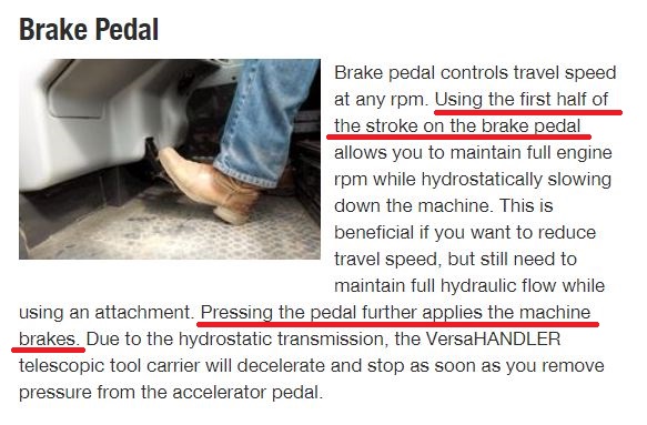

speaking with the service they mentioned a creep control "inching" function in the manual, looked thro it and either Im blind or nothing in the manual, what does it do and how is it used?

its not the work mode, so my service tech says, when I questioned him its tied to the brake and go pedal and says read up on it in manual but there is nothing there, --------------------------------
My Bobcat V417 has that feature, and maybe other machines also, but it doesn't work in the Toolcat.
Have him show you how he thinks it works.
   / Toolcat Creep Function "inching" Control
asked hi to show me just said its in the manual, he will be out next week, will have to see how he does it
   / Toolcat Creep Function "inching" Control #8
From the Bobcat Website for Telehandlers: Hydrostatic Transmission on the VersaHANDLER - Bobcat Company
   / Toolcat Creep Function "inching" Control #9
I just went through the manual and did NOT see anything like that for the Toolcat.:confused:
