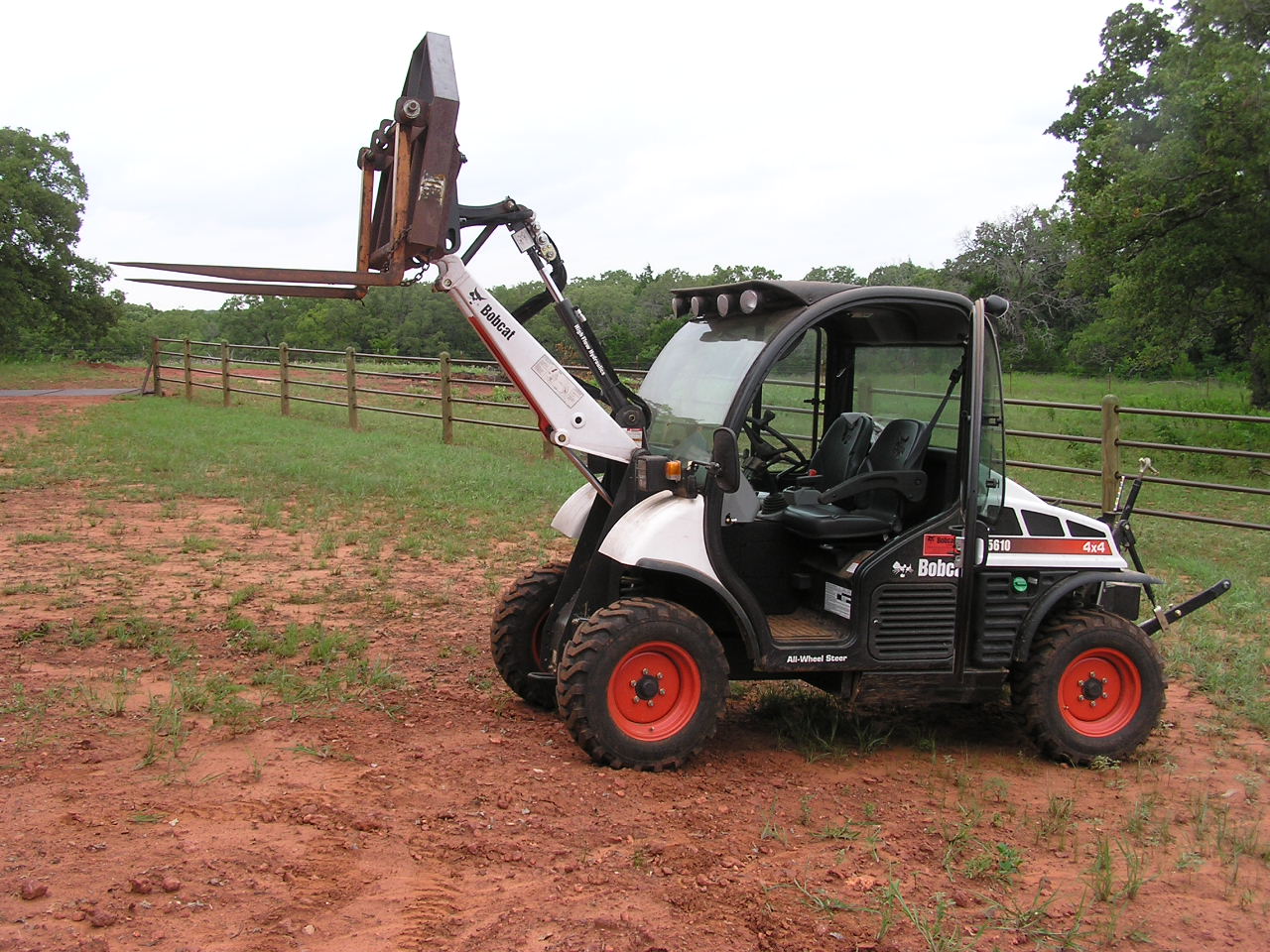

Well I guess no tall D series operators have seen your post. I have read there is a difference in the F series. My salesman thought the suspension seat was standard, but I didn't get it, so it is an option that has to be ordered.
I measured 36 inches, from the back of the cab, to the dashboard.
With the seat slid all the way back, there is still about 3 inches behind it.
Here is a picture that shows the seat.

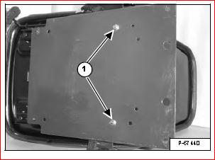

Here is picture of the under side of the seat plate. Looks like there is another set of holes to mount the slide rails back farther. If this is only hold up in your decision, mention it to the Salesman. He will very likely have the seat moved back so you can try it.

Thanks for the picture, SS! Gives me hope. I'll see if I can track one down with an amenable salesman.

The A - C series did have seat rails mounted on angle so it went up as it moved back. Idea was to give more leg room with less rearward movement of the seat. D series and later have horizontal seat rail mount with 2 rail position holes to accommodate the taller than average person.
