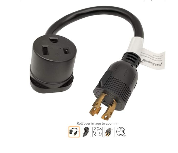

Also, are there adapters for the same welder that have instead of the 6-50P typical welder 240V plug, a L14-30P, the circular locking 4-lug plug for 240V on generators? That'd be handy, too.

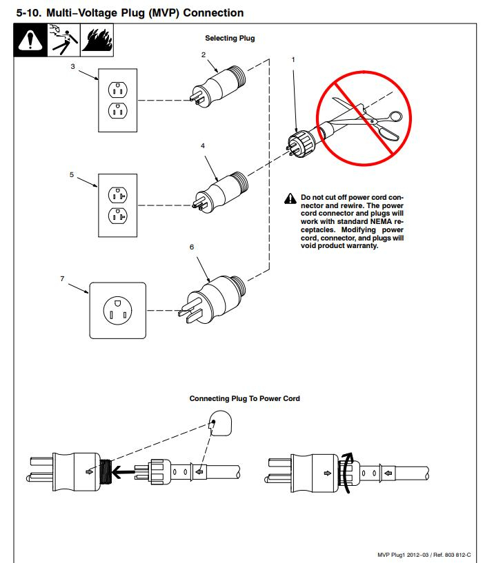

Some real world welding equipment manufacturers actually use a "multi voltage" plug that actually adapts on end of welder cord so you don't have Chinesium adapt only provided to make welder work with no regard to personal safety....
Example Hobart Handler 210MVP
Yes there is....
NOT RECCOMENDING THIS PRODUCT OR SELLER, but its here for reference only, many manufacturers and retailers can provide "like" adapter...
Yes there is....
My Miller Multimatic 200 uses the exact same set up.

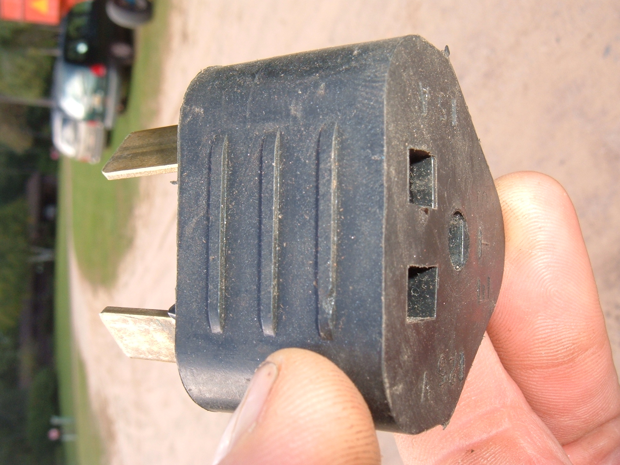

   #9
Sberry
Platinum Member
Jan 8, 2007
777
Brethren, MI
Mostly green
The 120 to other voltage adapters are legal, this one is not, some flea import scheme with no markings. its a 30 to 20. The only legal ones from 50 are to other 50 and from 50 to 30 travel trailer due to the fact the trailer has sufficient cord for short circuit and additional breakers. Its kind of like a power strip, has 14 wire with multiple outlets, can be plugged in to 20A but has a thermal device added to protect itself. The slight difference being that that little thremal is thermal and not short circuit which is still provided by the breaker.
The 30 to 50 Dale posed is legal, input is smaller than the recept. The comment from Hobart about voiding warranty is not really complete. Should also say dangerous. In reality wouldnt be an issue to cut off and install a 120/20 end (maybe even a 30). Not suggesting that, only for theory but never should have a 240 end hard wired to a machine designed for MVP. Might be ok with 30A breaker added but not really a diy type of thing at any rate.
They come out of the same box and the wire off the same spool as the Hobart. The 240V models use the same cord and plug as the Stickmate came with for decades. Only ones use different is hi duty cycle units, 250+ migs like 251, now 255.
