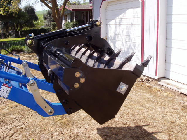

Simple question and am curious. Other than commercial TLB's, no buckets that I have seen on Kubota's have holes for bolt-on toothbars. Do you guys drill through the bucket yourselves or do you have your dealer do it?

As far as the holes, I've drilled my own. It's not difficult, but does require drilling a hole 5/8ths (.625") to 3/4 (.750").

Just pilot drill those holes first. You will want some good sharp drills (I used a step drill on my last bucket...done this three times) and lean into it.

On my old tractor, I drilled my own. On my new tractor, my dealer blew a hole through the bucket with a torch. I was not pleased, but I think they had to do it because the of where the toothbar bracket landed it was interfering with the cutting plate at the corners of the bucket.

I used C-clamps to temporarily hold the toothbar in place then drilled a dimple sized pilot indent with a drill bit the size of the bolt, then switched to a smaller bit and progressed back up with several other bits to finalize with the finish bolt sized bit. Bolt that side in place then start the same proceedure on the other side. This takes some time to accomplish but absolutely no guesswork involved.

That's a very good trick to getting an accurate center. :thumbsup:

Also should mention that I used 2"x2"x1/4" square Simpson foundation washers for a little more beef on the bucket sides.
That's my ongoing grapple project up on top. One more set of hoses to build and it's good to go.
