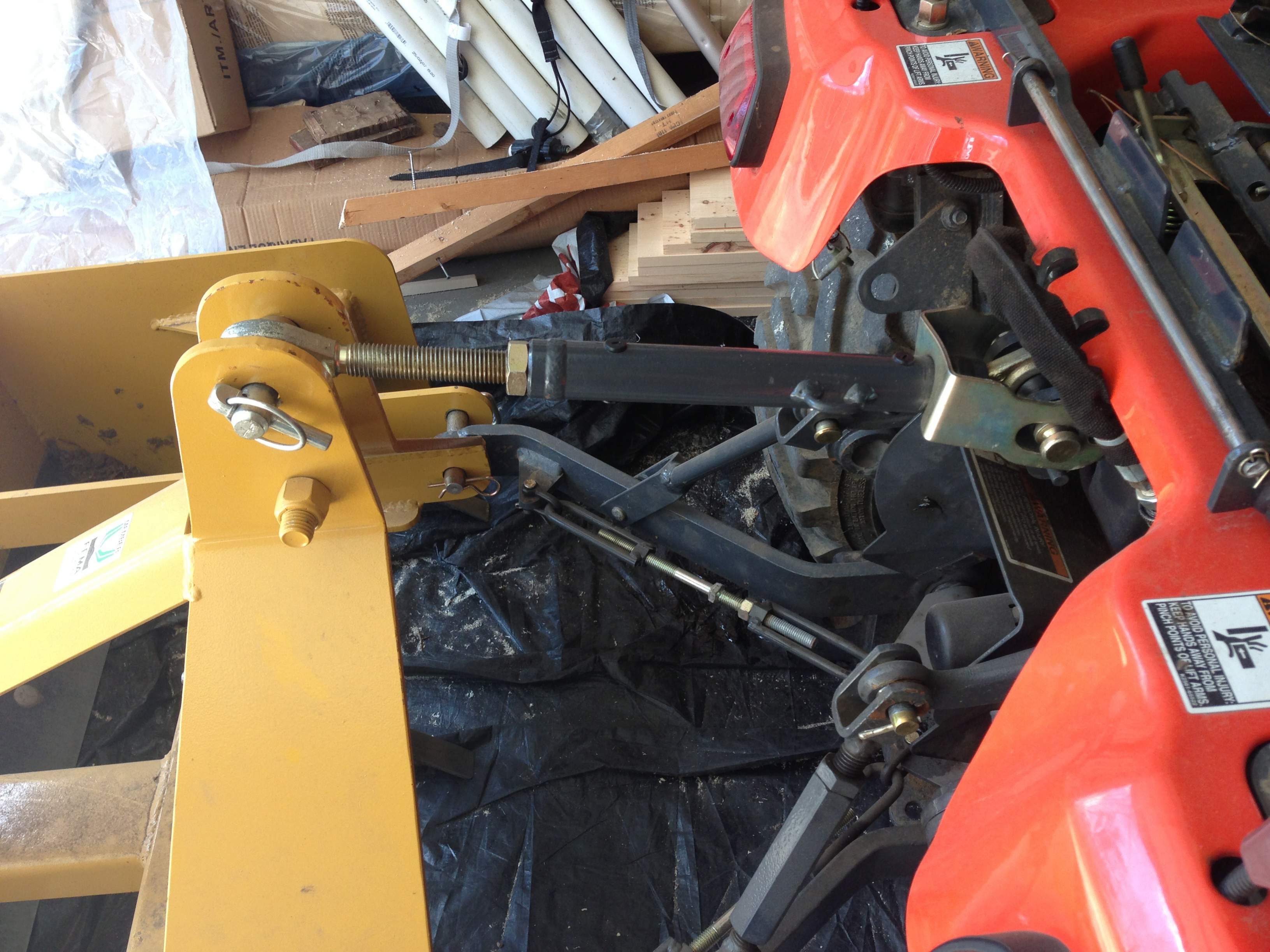

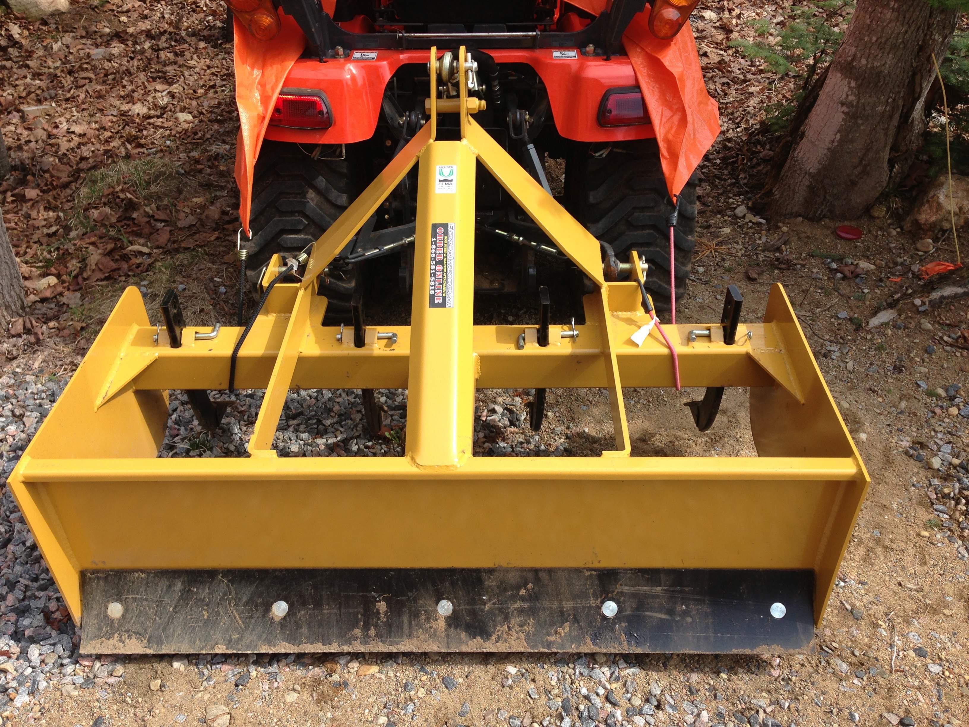

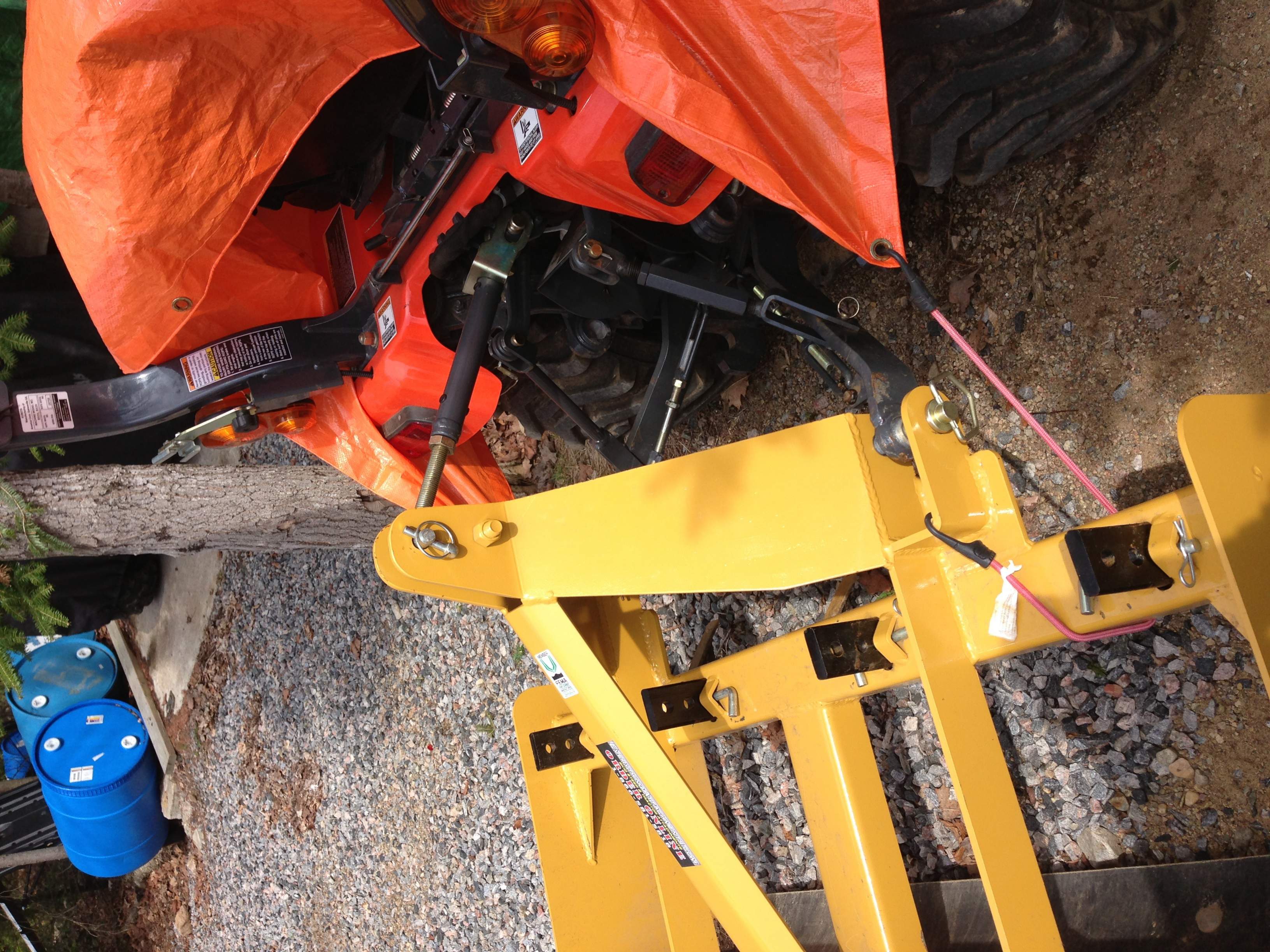

I just bought a new box spreader from everything attachments.com, and I can't get the top link on my Kubota 3 pt. hitch (which came with my BX25) to shorten enough. In fact, the entire range is only about an inch or so. I tried unscrewing it completely (so I could cut it shorter), but it won't come out.
Do I have to go out and buy another top link with a greater range of adjustment?
Thanks, guys - any help would be much appreciated.

Looks like you bottomed the adjustment at the tractor end. The turnbuckle should have equal amounts of threads showing on both sides.
Take the toplink off, run the threaded end on the tractor side out till the amount of thread matches the implement end.

My Kubota doesn't have that gold piece that hooks onto the tractor end of the top link. If it was me I would remove the link and try to adjust each end individually. If/ when both move freely I would adjust them so both were screwed in as far as they go. From that point when ever turning the center section I would make sure that both ends couldn't rotate.
   / Top link length adjustment is way too limited #8
It looks to me like the tractor end is screwed in all the way and the box blade end is screwed out all the way.
If they are truly stuck I would clamp the center section in a vice and turn each side individually with a cheater pipe through the ends. Penetrating oil is your friend and I've even had to apply heat to a stuck top link before to get the ends to turn properly.

The little plugs you are looking at are there so you can knock out a rollpin. That is what keeps you from unscrewing all the way. Also there should be a grease fitting in the middle of the top link. You do not adjust my screwing on one end at a time. Adjustment is made by ends hooked up and you turn the center.
   / Top link length adjustment is way too limited #10
first of all -- the gold bracket is on upside down and bent. Its not supposed to fit on the body of toplink- only the bolt end. Second, your toplink end is screwed in all the way on tractor end, and other end is out too far. Third - the toplink bar is supposed to be on the other way with the little loop on outside of toplink housing away from the tractor. Take top link off tractor, loosen the nut and thread it all the way to end, screw in the end that is too far out so its even with the other end and then put back in tractor. The loop is for the screwdriver to turn a stuck toplink and to hook up the safty chain to from the pto shaft.
