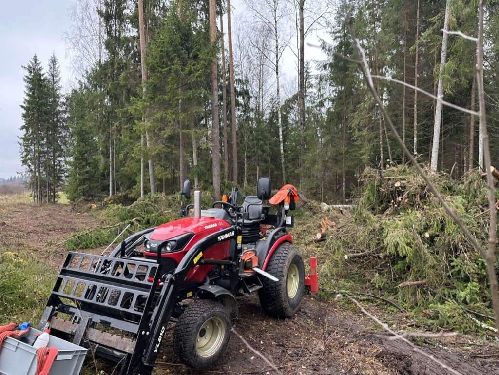

I am happy owner of SA424
If you mention "garden", I meant, that's the right size
But obviously I don't know, what kind of garden you have and what you want to do there
