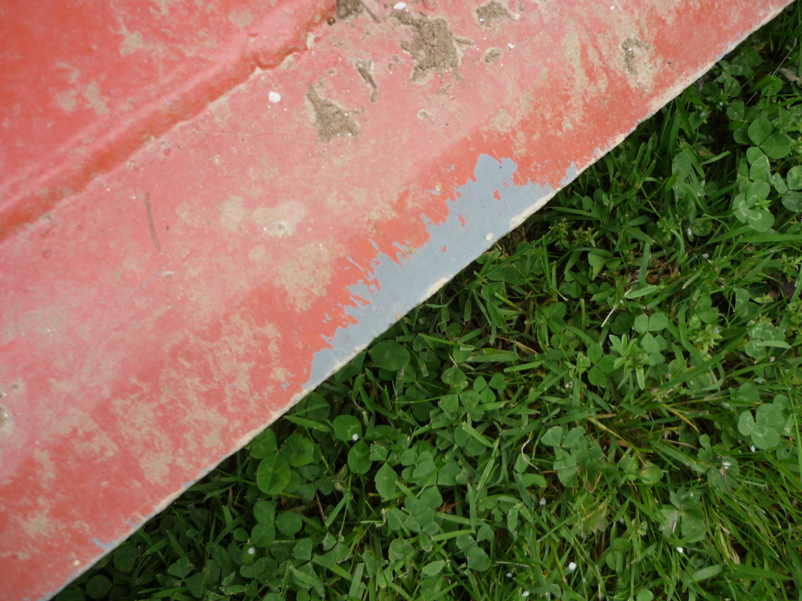

As I have posted before, I think two-part epoxy primer is incredible... I have used it on several metal items subject to weather and harsh use, and it seems almost indestructible. The photo shows my bucket's cutting edge- the gray is that primer, after it was used multiple times to scrap up gravel and stone from a paved road where it had washed down after heavy rains. The Kubota orange is worn off, while the primer remains.
