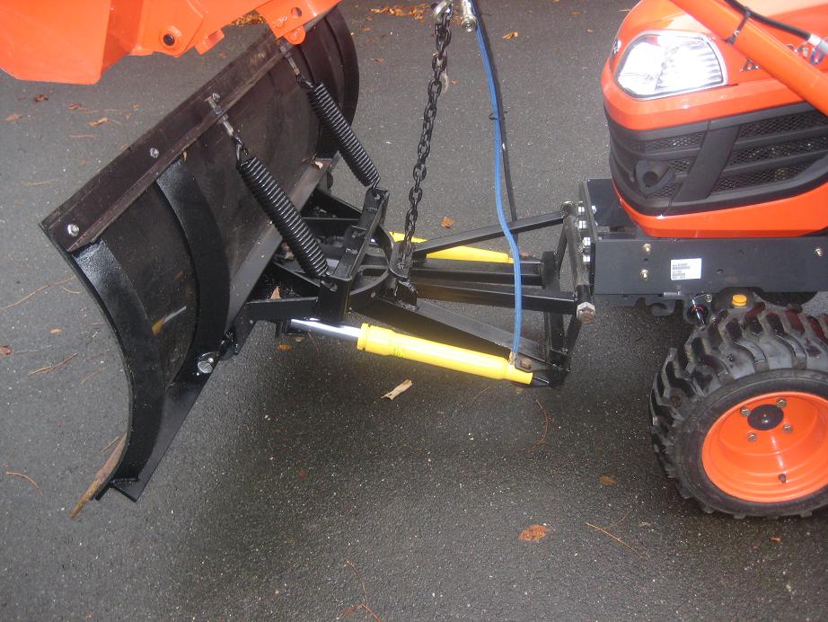

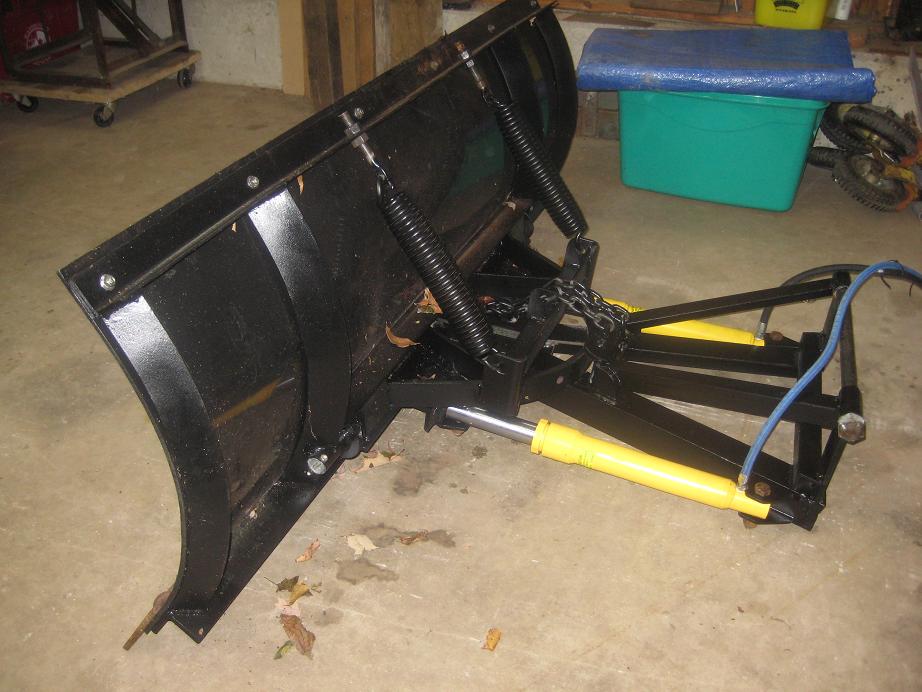

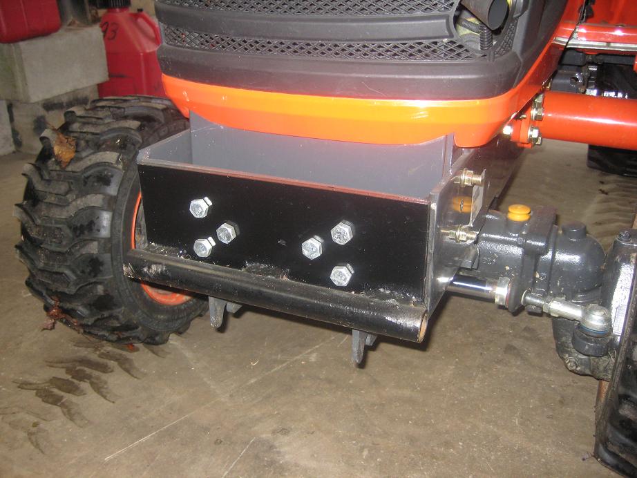

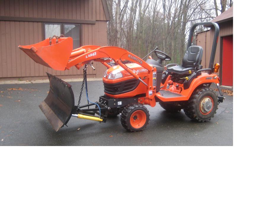

I looked at the quick hitch plow setup, thought it was way to expensive so I decided to make my own plow setup. The FEL is used to lift the plow and the bucket hydraulics are used for the swing. Just got to play with it in 9" of nice wet heavy snow. Worked great. :D
You can still see, right? :D:D That rig would be a lot of fun around my big pines. LOL

Visibility is no problem and if I need down pressure the bucket on top of the plow is the hot setup. Got a nice Stihl and a Salsco chipper to deal with trees. LMAO

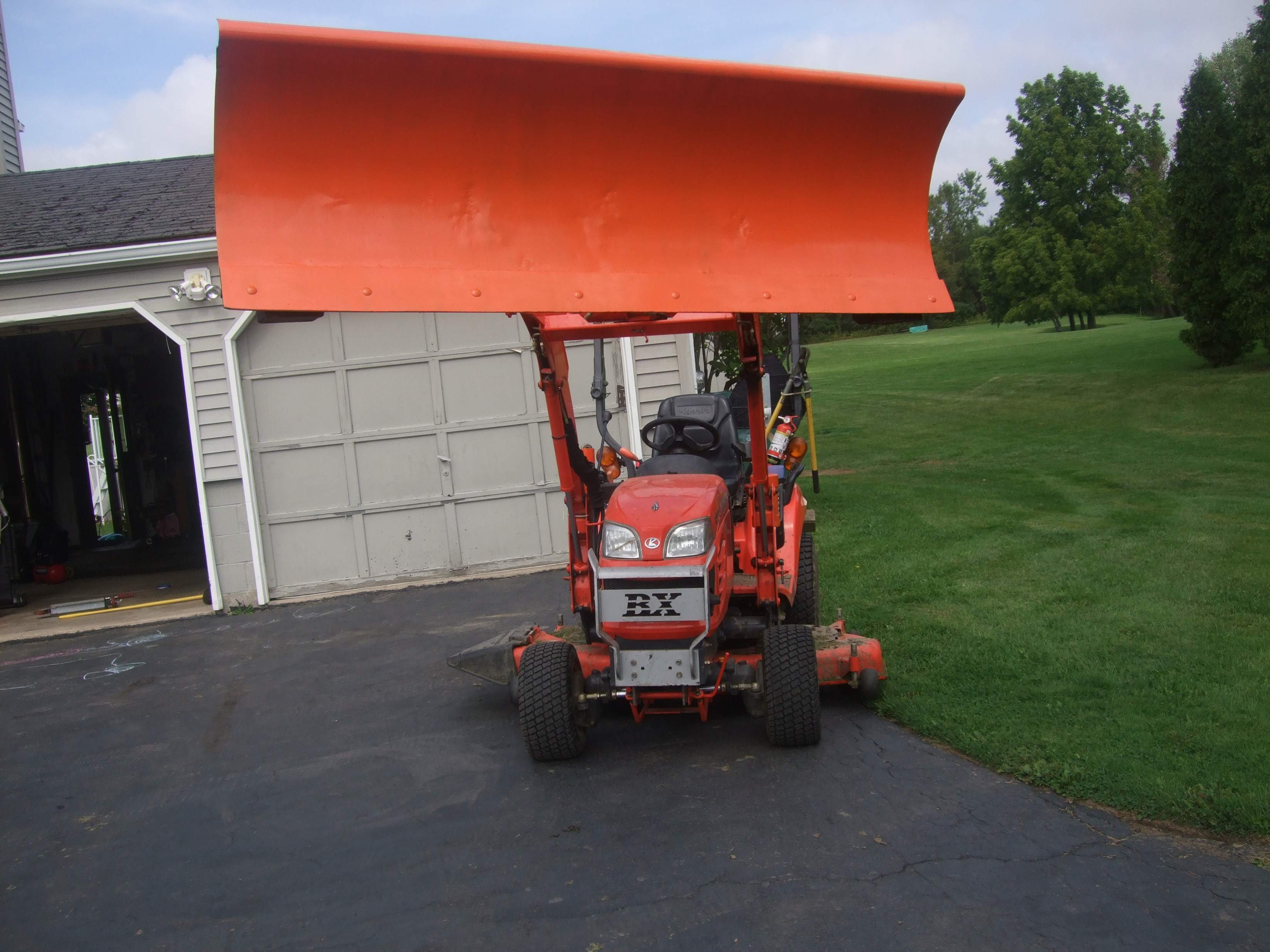

OR perhaps you could add plow to FEL arms and have best of both worlds? You get the hieght of FEL and angled plow action. ;) Here a pic of mine
