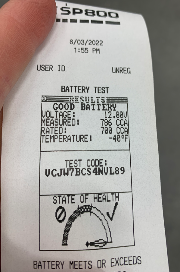

Thanks for the quick feedback! Here is more info and some follow-up questions..... Battery was tested and seems to be fine. When you mention fuel system needs to be bled out - what would the issue be? How do you bleed out the fuel system (I'll google it - but showing that I don't know off the top of my head). My brother in-law speaks of some solenoid issue. What I'd love to have is the process flow of turning the key, indicator lights flash one, glow plugs cycle, and then...... all of the steps and electricity flows that happen to engage the starter and turn over the engine. ??? :)
   / Tractor died - now trying to troubleshoot - issue seems to be electrical #7
Thanks for the quick feedback! Here is more info and some follow-up questions..... Battery was tested and seems to be fine. When you mention fuel system needs to be bled out - what would the issue be? How do you bleed out the fuel system (I'll google it - but showing that I don't know off the top of my head). My brother in-law speaks of some solenoid issue. What I'd love to have is the process flow of turning the key, indicator lights flash one, glow plugs cycle, and then...... all of the steps and electricity flows that happen to engage the starter and turn over the engine. ??? :)View attachment 756883
Fuel causes many problems. No crank, and slow crank with jumpers are neither of those.
New battery, check battery to ground, and battery to starter connections.
Take all safety precautions, and try jumper to starter directly. Let us know if you need additional detail, and do let us know what you find.
Best,
ed
