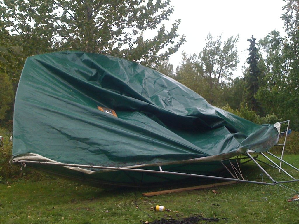

Anchor it as well as you can... it isn't fun when they blow over.
That is a 20X30X14. After that little disaster, I anchored it with 14 duckbills.

This is the reason I put a floor in the one for my Heep and then anchored the shelter to the floor.
(2x8's on top of 4x4'swith 1/2" gap between the boards. It is now heavy enough that it aint going anywhere.
