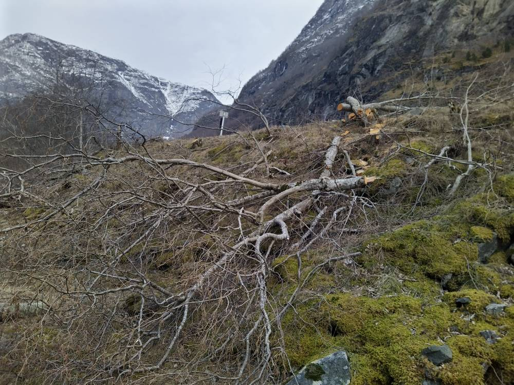

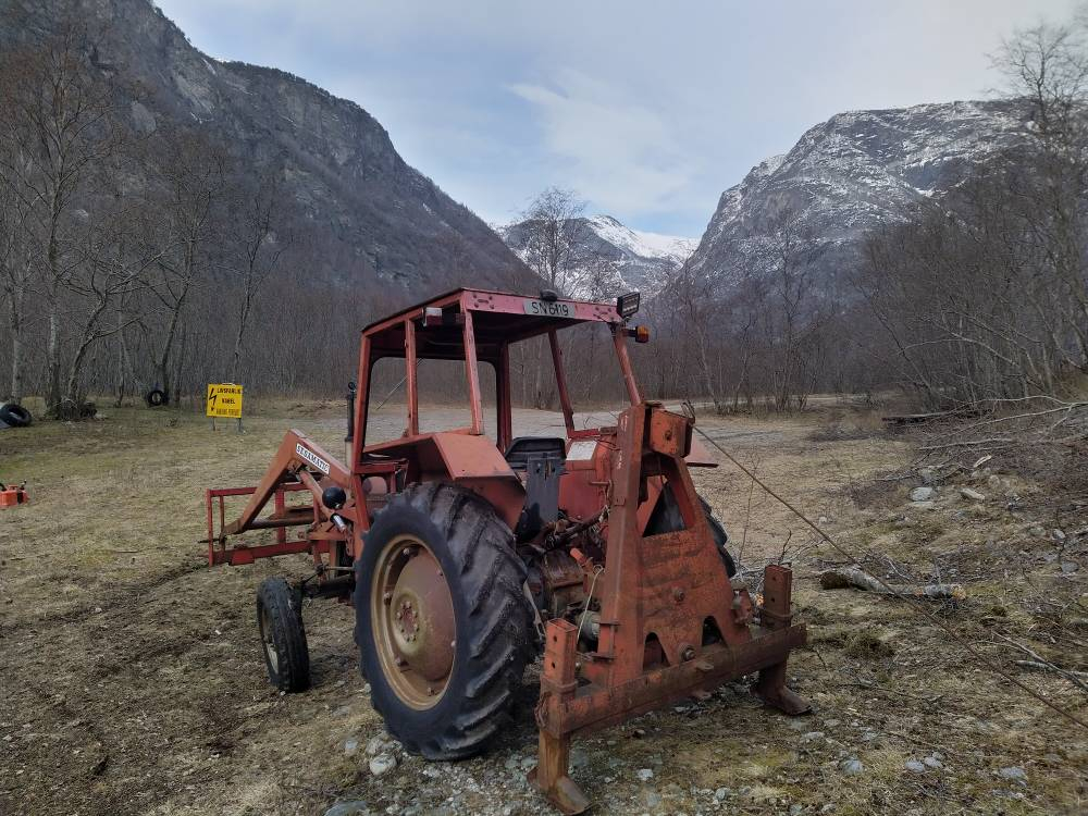

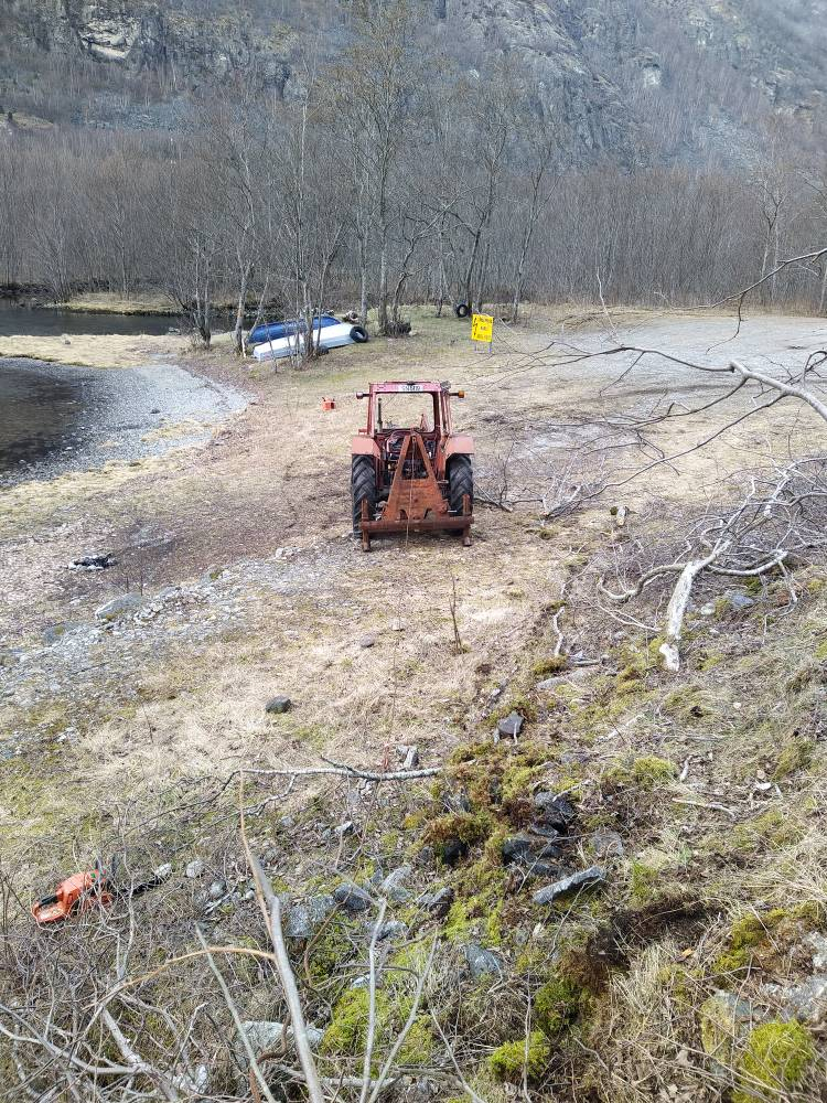

Our and cleaning upView attachment 737255View attachment 737256

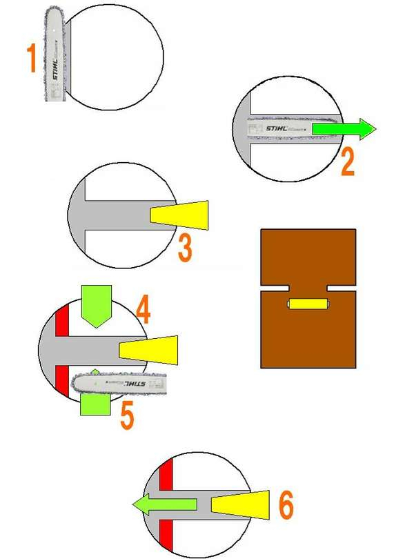

Try this when you don't have room for a wedge. Make your face cut and then lay your saw on the flat of the face cut and bore straight back thru the back of the tree. Then put your wedge in. Make your back cut in two steps. One on each side and a little above the wedge. Make sure you leave good wood above the wedge. The little bit of verticle grain left splits very easily when you drive the wedge. Works real well. Called tongue and groove cut.
gg
So why not just do a plunge cut for the back cut leaving about 10% of the tree diameter intact, when you finish the plunged back cut, pull the saw, insert your wedges on both sides of that 10% left, then cut the little bit left and finish driving the wedges.
Something like this...
   / Tractors and wood! Show your pics #19,890
Why not - there are lots of ways to cut a tree where there is not enough room for the wedge before it hits the hinge. I just showed him the one I use and like most. Everybody has their preferences. The important thing is that you have some method in your bag of tricks that solves the problem to wedge over a 6"tree.
