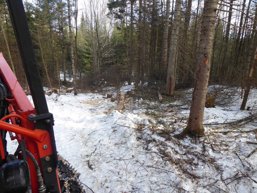

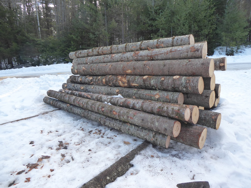

Trail conditions here have remained solid so far thru this warm spell so I am still able to work the winter fir harvest. Here are a couple pictures from this morning.
I'm cutting the stand, back to front and left to right. I try to fell everything to
the back so that I'm not working in, or winching logs thru, the slash. It requires some wedging.
Tuesday I made a little video showing some of that wedge work. The first tree, a back
leaner, wedged over nicely and had very little butt rot. The second tree had a right lean.
The butt was quite rotten. The rotted hinge couldn't take the jacking pressure of the wedges even though I left it heavy. When the hinge broke the tree went where it wanted - to the right, and leaned up against some adjacent trees. I pulled it off the stump with the winch then cut quite a bit of rot off the butt before I found good wood. Third and fourth trees were back leaners, especially the fourth. They were too small to get a wedge in behind the bar before the saw got pinched. In those cases I like to use the "tongue and groove" cut so I can get a wedge in. This is about an 18 minute video.

Excellent video Gordon. It would be a treat to work with you. I would learn a lot.
Never understood the tongue and groove method until now.

As others have already noted, that's a great video, Gordon.
To clarify for those who are not as familiar with the tongue and groove method of dealing with small back-leaners: The tongue and groove is not about steering the three. The hinge is still doing that (you are losing the center part of the hinge, but the part to either side still does the steering). It's all about making room to drive the wedge: with a small back leaning tree, on a "normal" cut, you might run out of room to drive the wedge and have it bottom out on the back of the hinge before driving the tree over. The bore cut which forms the end of the tongue makes a space to drive the wedge deeply without having it bottom out on the hinge. THe tongue and groove are just formed as a by product of offsetting the two back cuts (one on each side of the wedge), so you don't cut in to your wedge while making them.
