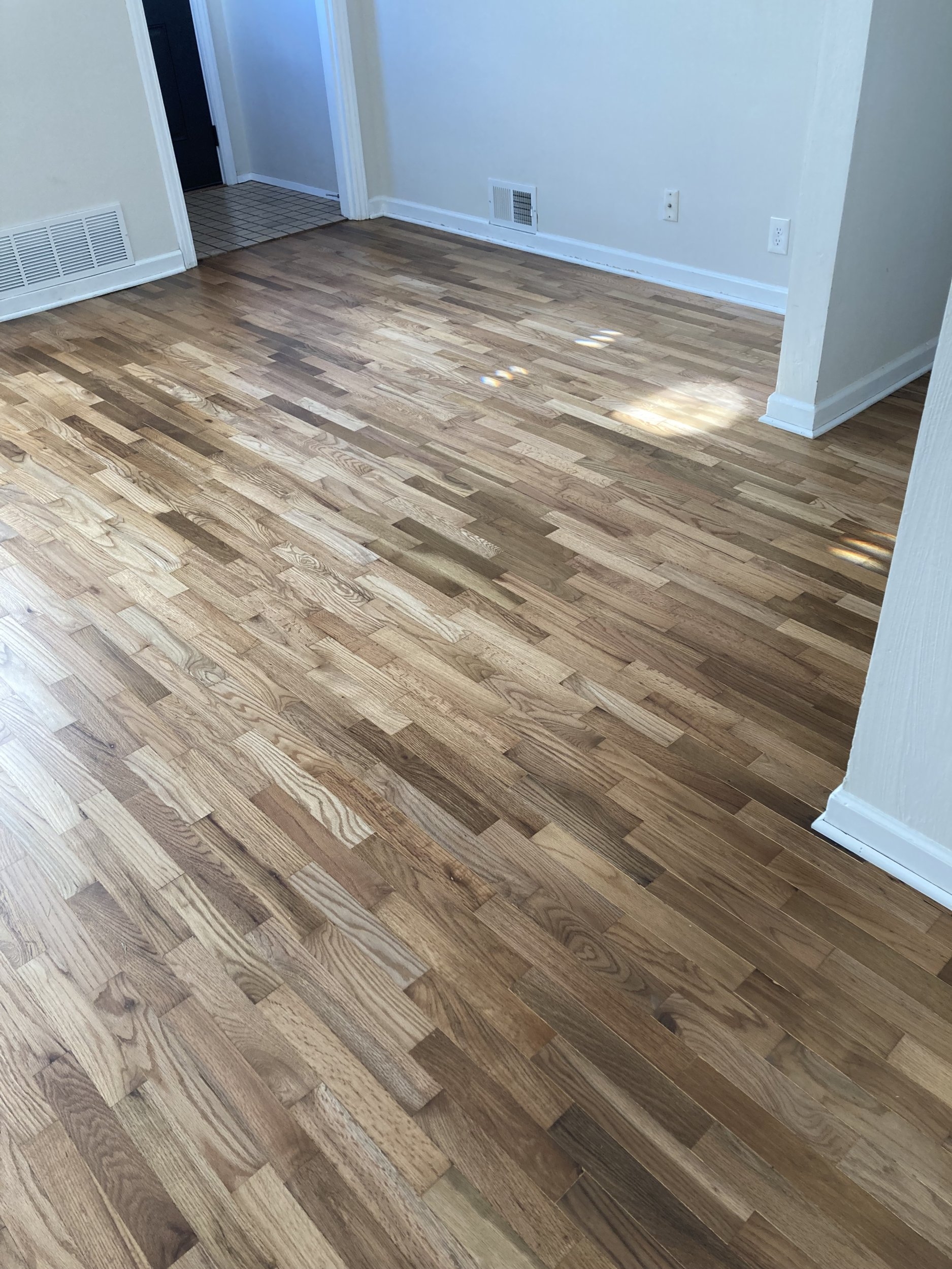

To all you back East oak guys. I have a 1950 rental that has a short board oak floor. I had the floor refinished and the floor contractor said I had a mix of red oak and white oak. He pointed to the darker pieces and said that they were white oak and the lighter pieces were red oak. I would have thought the opposite. Or maybe I have a color blind floor guy?
No matter what color you *try* to stain red oak, it will always have a reddish hue to it. White oak is like a blank canvas and can be stained any color you want, even black. Now since these are all shorts, I guess it's possible that they milled every part of the tree and got some funky dark pieces mixed in, and I have seen a few dark pieces of oak, but never heard of white colored red oak.
That's an interesting floor goe. I'm not a wood worker so can't help with the ID but if someone asked me I wouldn't say oak ????????
