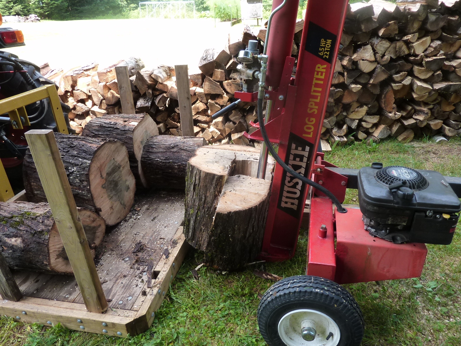

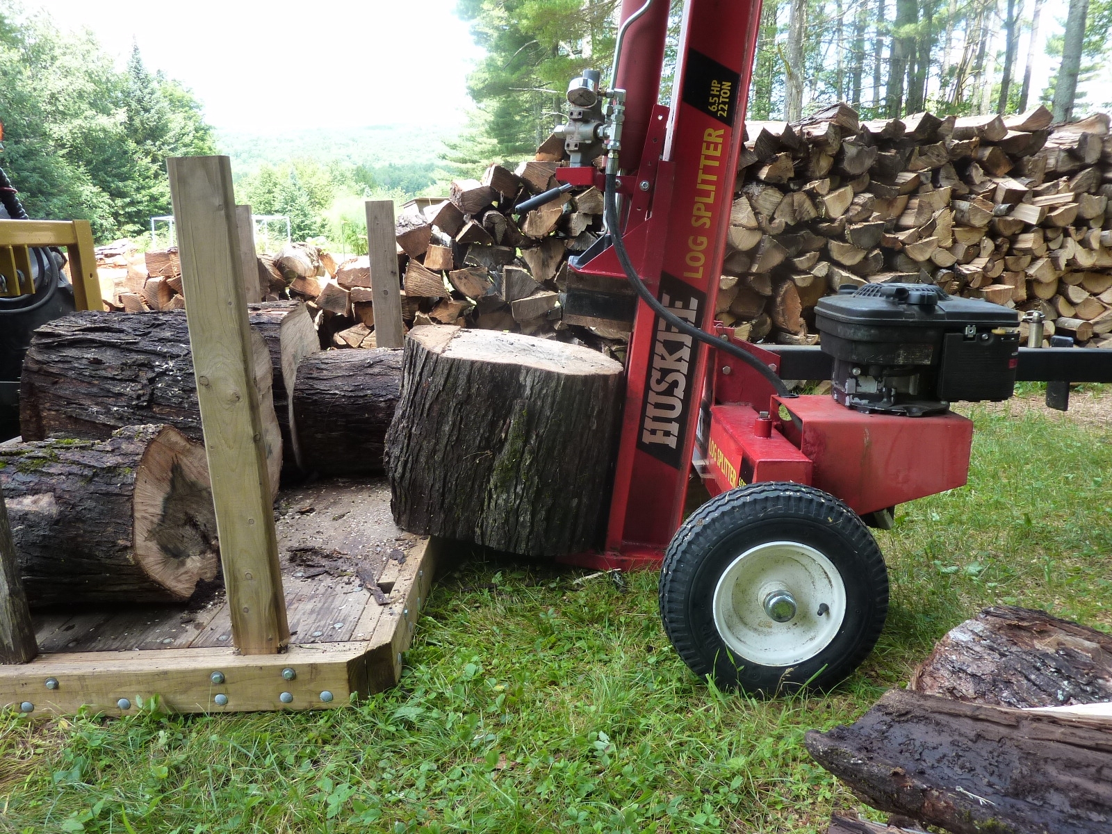

I don't do any heavy lifting of big rounds, I move the logs with my tractor and then cut them to length over a wagon,
or a trailer,
and then roll the big rounds right onto the splitters beam using a board,
It works very well, and I don't have to deal with them on the ground at all.

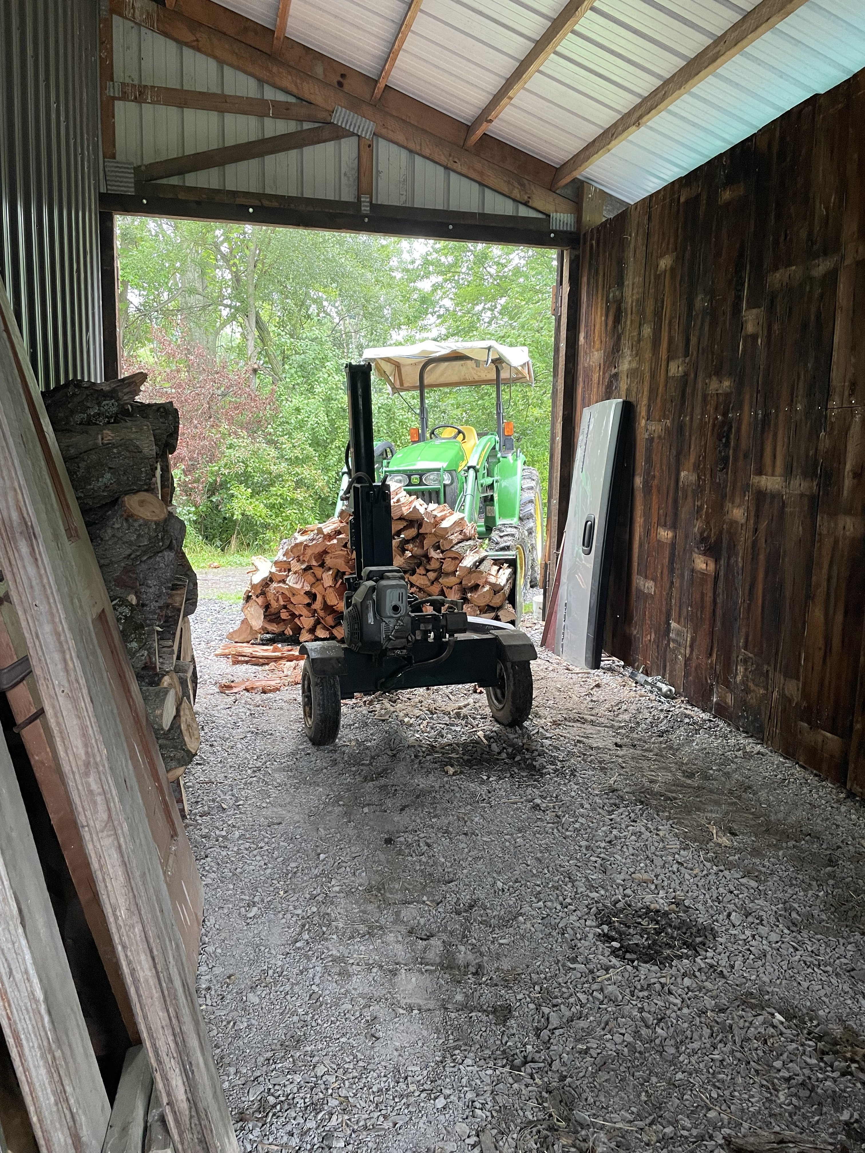

I use a bucket for a seat also. About 90% of the firewood I’ve burned, the last 15 or so years, has been ash. I split anything that’s about 22” diameter and larger with the splitter vertical, while seated on an upside down 5 gallon bucket.
I always have my tractor bucket next to me, to load the split stuff into (holds about 1/2 face cord), and I’ll roll 5 or 6 big rounds within easy reach from the “seat”. There’s no heavy lifting involved whatsoever. Smaller stuff I split while standing up (tractor bucket in same spot)and with the splitter horizontal.
I do nearly all of my splitting on rainy days in my “splitter shed”. The tractor has a canopy on it so I stay pretty dry while transferring the split stuff to my woodshed, which has a very wide overhang that also helps a lot in the rain.
I don’t have to worry so much about efficiency, while splitting on rainy days, because there’s usually not much other work to do in those conditions. I wish I had some big rounds ready to split in the shed now, but last Saturday was rainy, also and I split all that was in there then. I do have quite a bit of spring equipment maintenance to do, in the shop, and I’ve got to run for fertilizer and seed in the morning so that will kill most of tomorrows rain time.

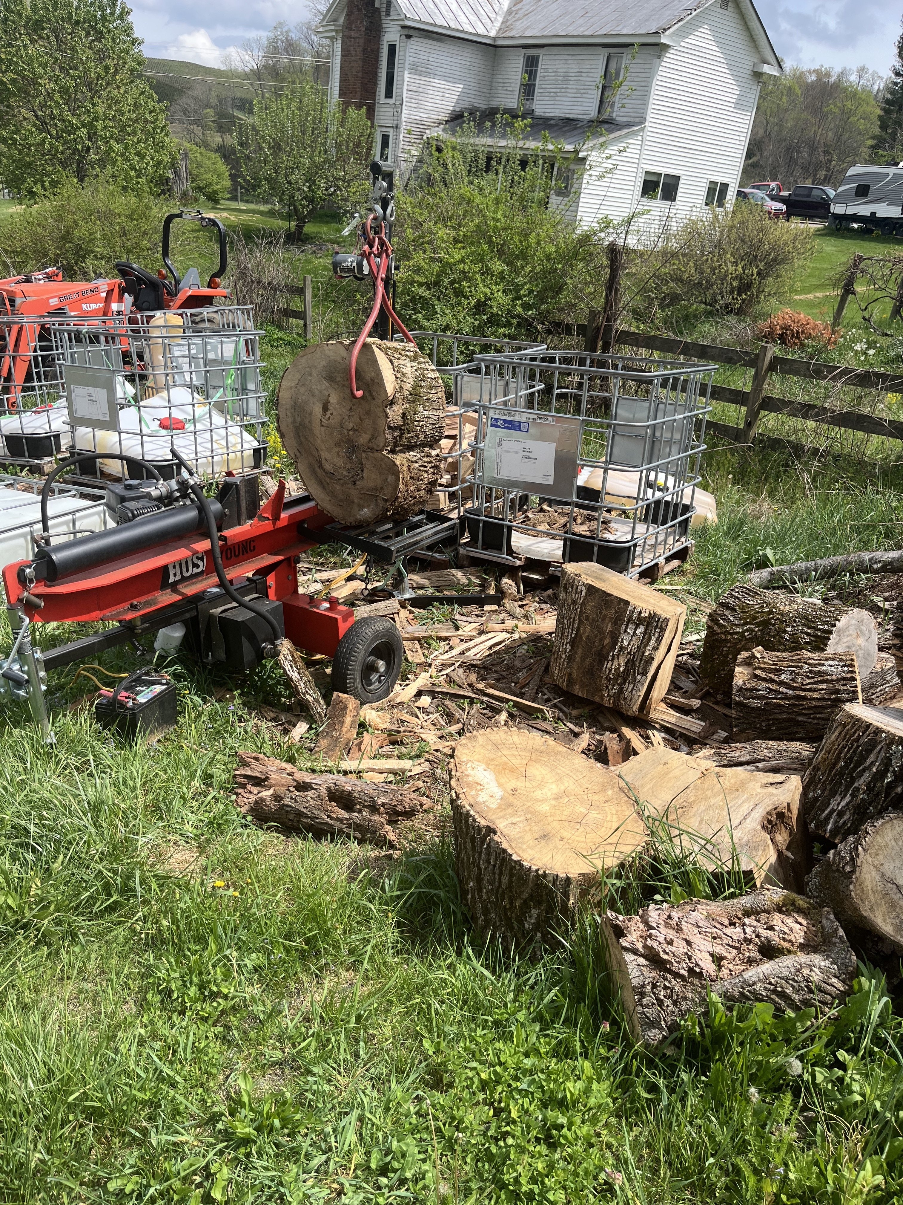

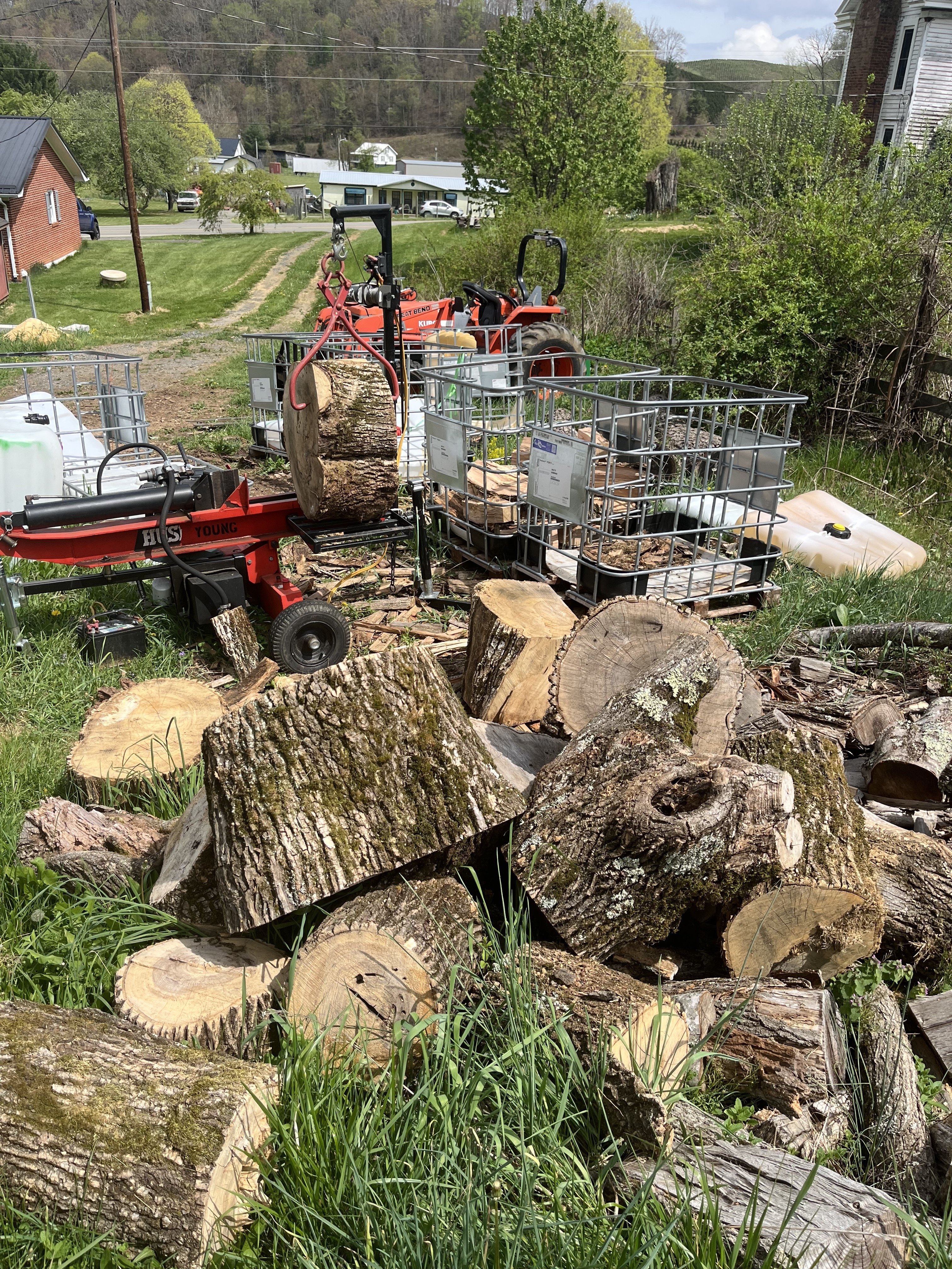

Here are a couple of shots at my firewood handling. Old Huskee rebuilt splitter with a Gorillabac log lift. The log lift is just a small crane with a small electric winch, but it is really useful on the big stuff. I am one of those that just hated to use the splitter vertically, and haven't taken the time to put a hydraulic lift on the splitter. I really like the IBC totes, just toss the wood in, don't tough it again until it goes in the outdoor water stove. I normally don't get logs this big, but they were already cut to lenght and free. 4 of them filled up a tote. I have about learned to toss the wood instead of stacking, can't get quite as much in, but my L3600 can pick it up and move it better(not as tippy). At almost 70, I am still getting ideas from this bunch(some more expensive than others)
