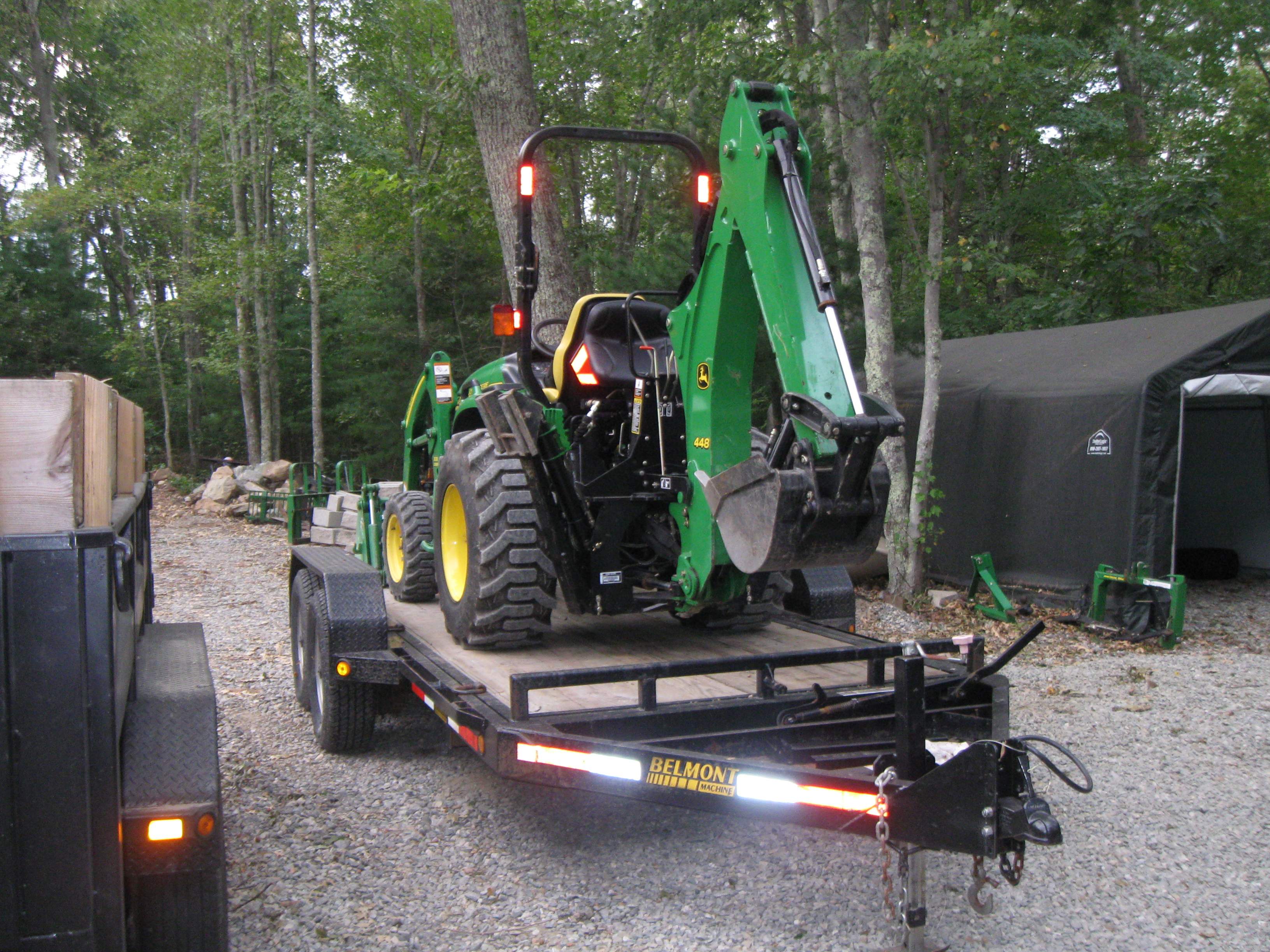

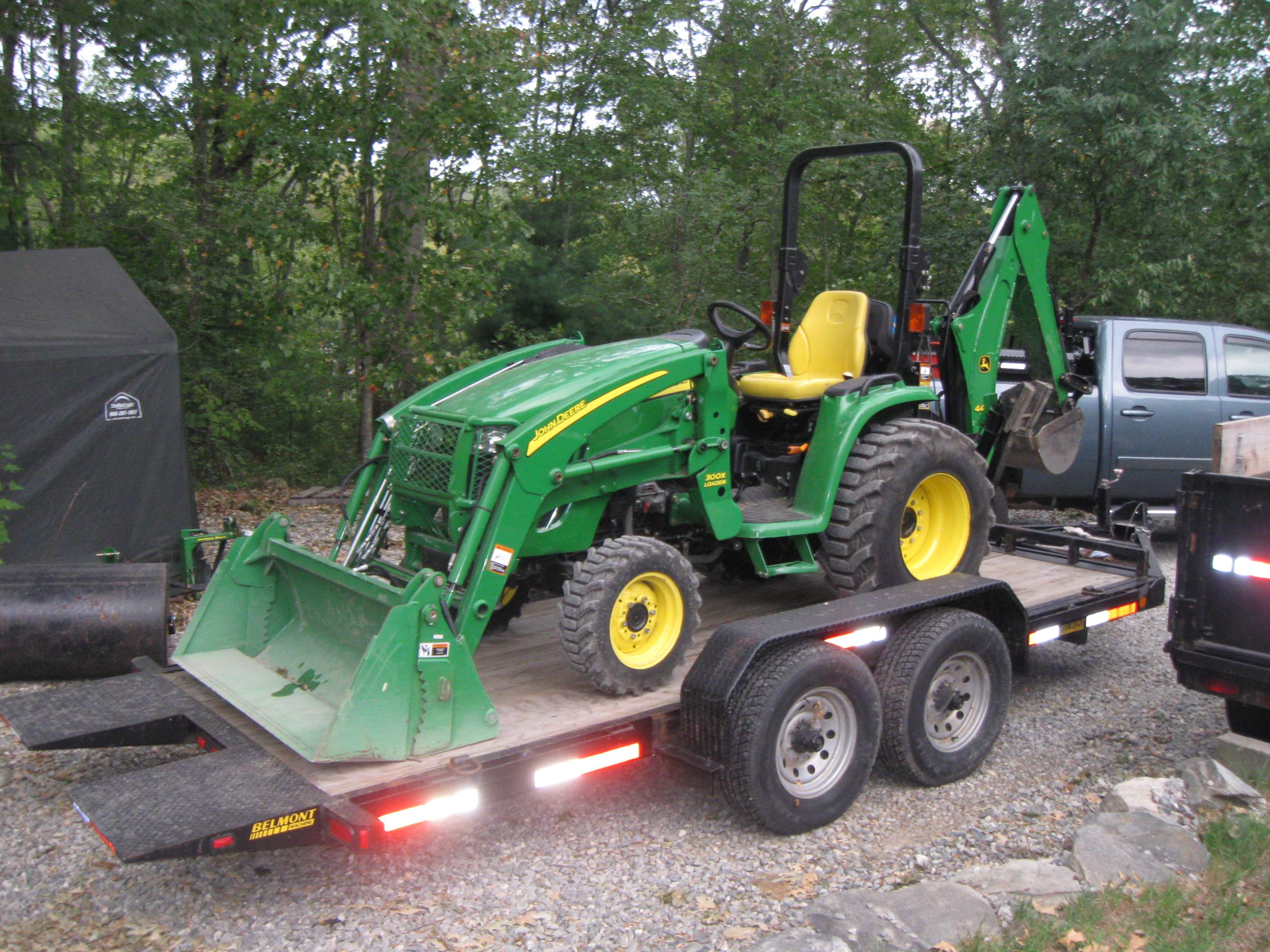

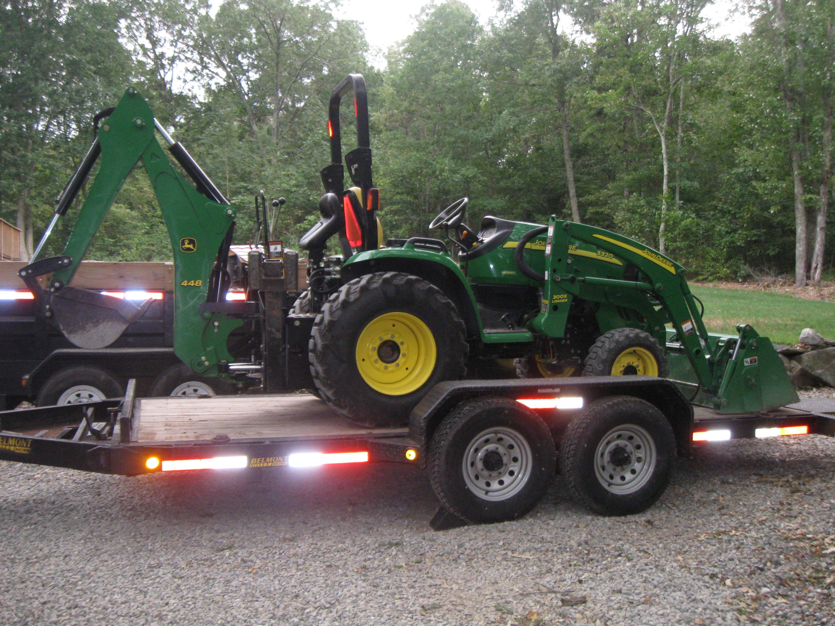

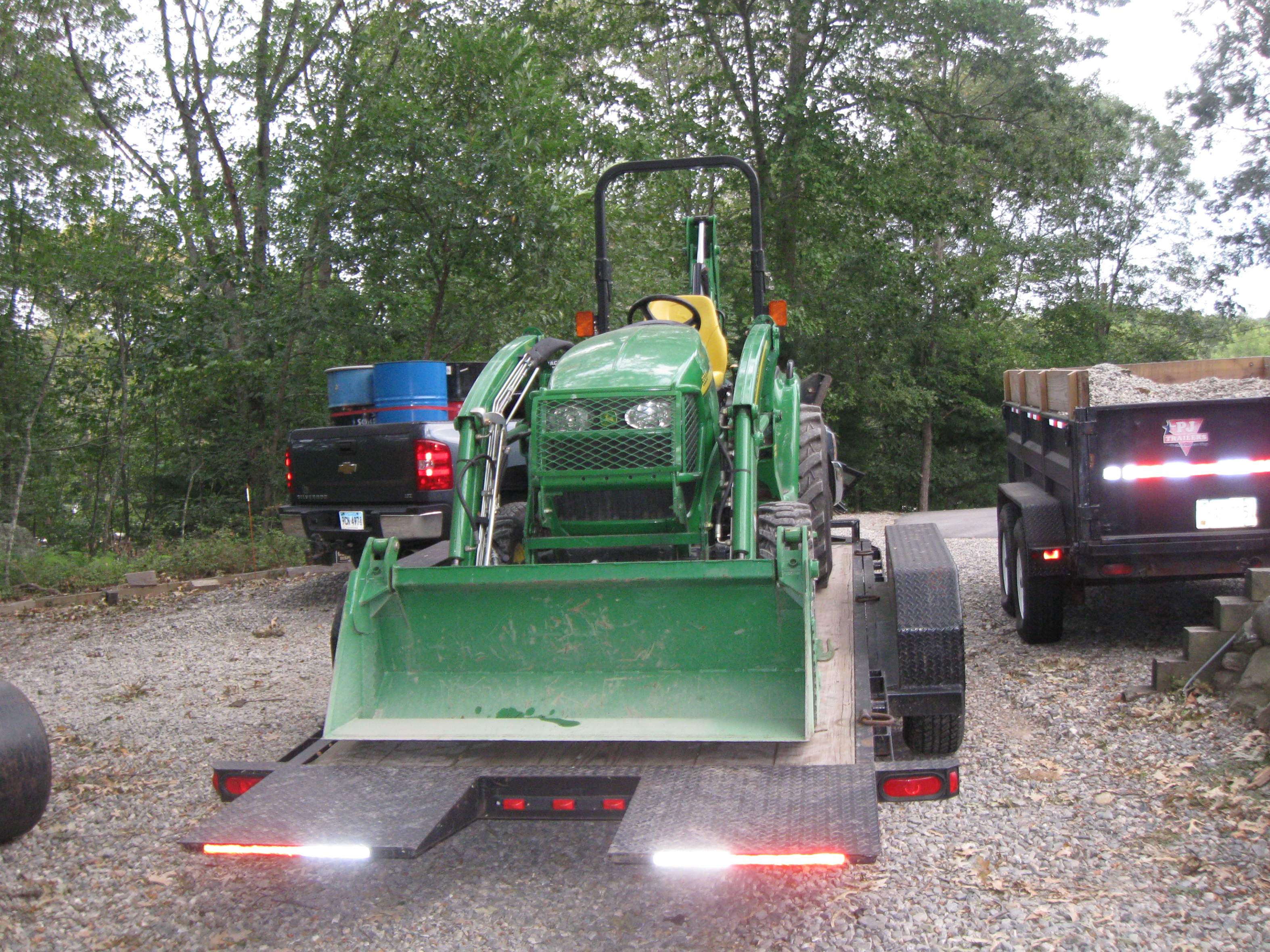

Well, I figured I owe it to the forum to update this thread. I ended up driving to PA to pickup a lightly used Belmont 18' 12k tilt. It towed pretty well on the ride home and I've yet to use it yet.
I had a few brush hogging jobs lined up that fell threw. So today I figured I'd load up the tractor to see how it fits. My first thought was how my 25' PJ GN was the cat's meow and I reget selling it. Load placement is tough with the tilt's as I've read but loading and unloading is sure slick. I guess it's a trade off.
These tilts seem to really cater to skids and mini x's with weight centered over the axles. With tractors being rather long it's a bit tricky. Here are some pics.

Is it a power tilt? Reason I ask is if you have to pull on forward with say the bush hog on the back and its gravity I am not so sure it will go down???? And if it does it may have negative tongue weight.

It isn't a power tilt, it has the cylinder with a dampner valve. It will always go down due to the pivot placement. I had the tractor turned around but with the weight of the hoe and loaded tires it was negative. I could easily add the hydro pump to make it powered I just don't see the need at this point. It still won't help with weight distribution. I think the axle placement further back a foot would be a huge improvement. But for s skid or mini I think it's good where it's at(which is it's design).
It's a very nice trailer qualitywise and if it doesn't work out for my needs I may just have to go back to a gn for the added bed length. Time will tell.

Or just get away with the tilt. When I was dealing with more utility trailers it was a issue I seen as well. Axle placement can make all the difference in the world.
I worked on a boat trailer Saturday. The tandem axles were fixed so we moved the bow stop back 4" on a 27' boat. By doing so we took the bottom of the bumper on a mid 2000s' 1/2 ton 4x4 Dodge from 17 1/4" to 20". Again this was just moving a 8,000# boat back 4" it raised the rear of the truck 3 1/4".

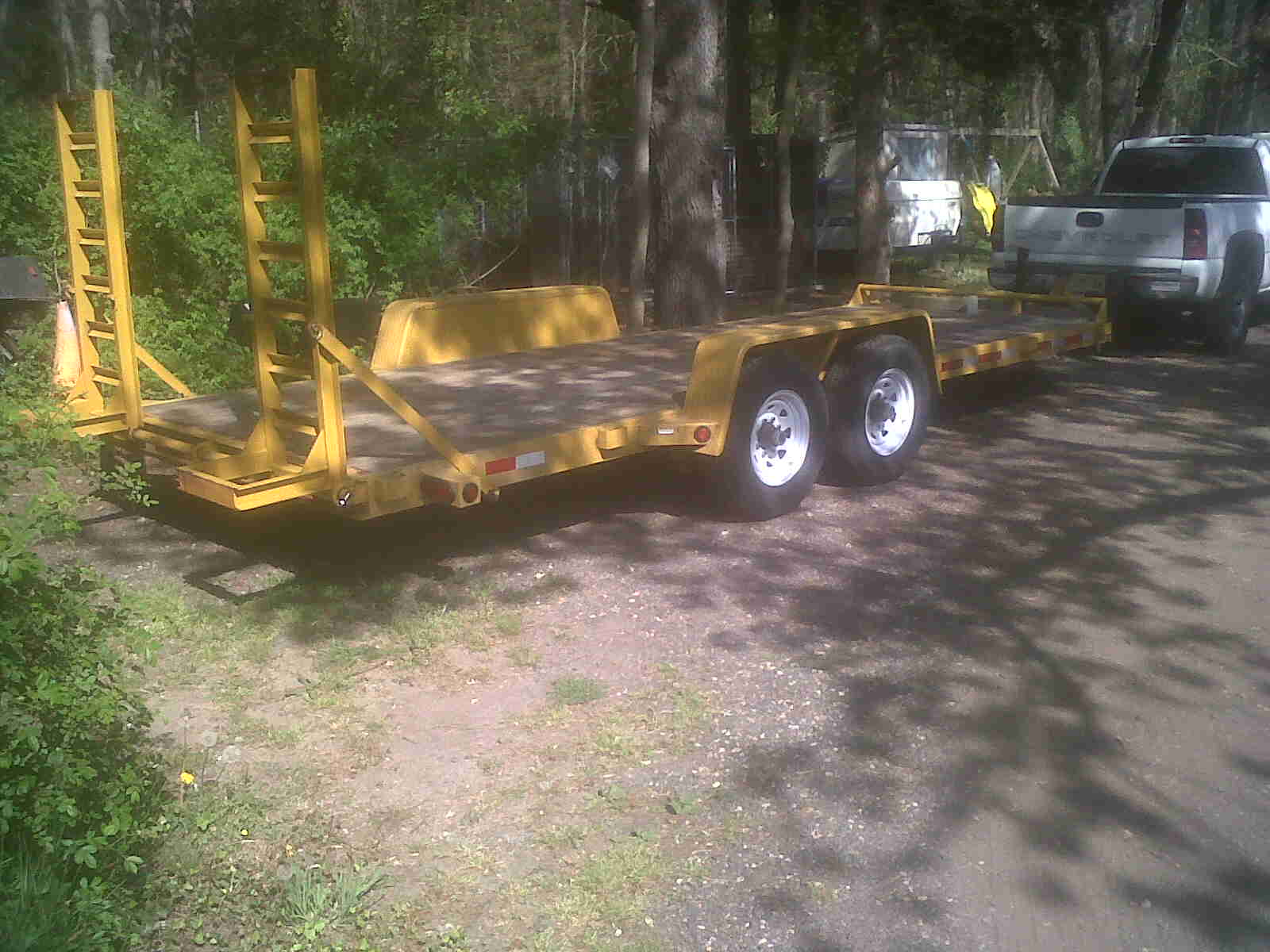

just picked up a sightly used bri mar 14000 lb, 20 ft trailer , put other trailer plates on and drove through the piney barrens of jersey .
