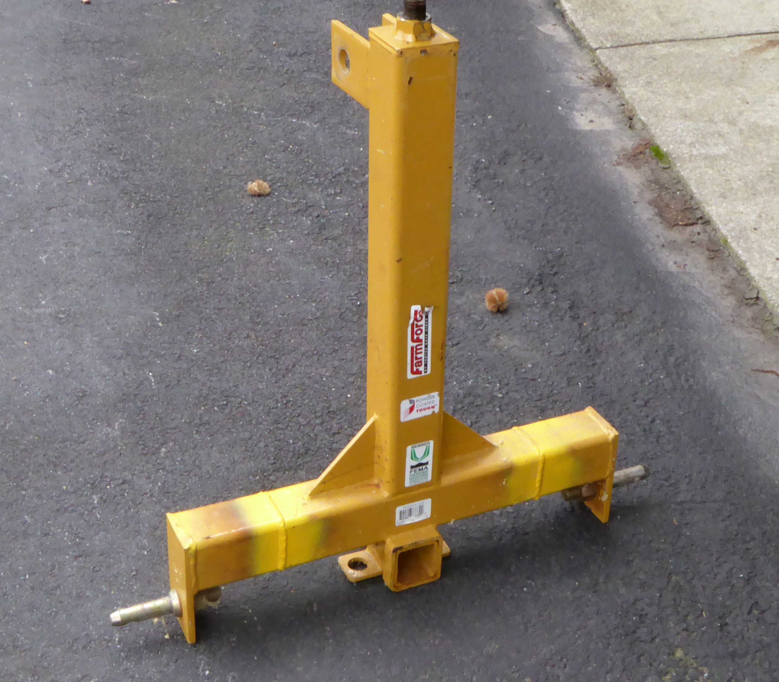

4) By the way, a gadget that is GREAT for maneuvering trailers around (even fairly large ones, using the little tractor, when trailer is not attached to the truck) is a "T" that mounts on your 3pt hitch and hosts a receiver hitch. Photo below.

1. You referred to a "t" but your picture shows a thpical after market trailer mover. They are quite common and are useful. I myself have a combination unit that serves as trsiler mover and ballast rack. The one problem I'm told . . Is that a loaded trailer can cause a trailer mover to go upward because a 3pt. Is designed to lift . . Not to hold something down.

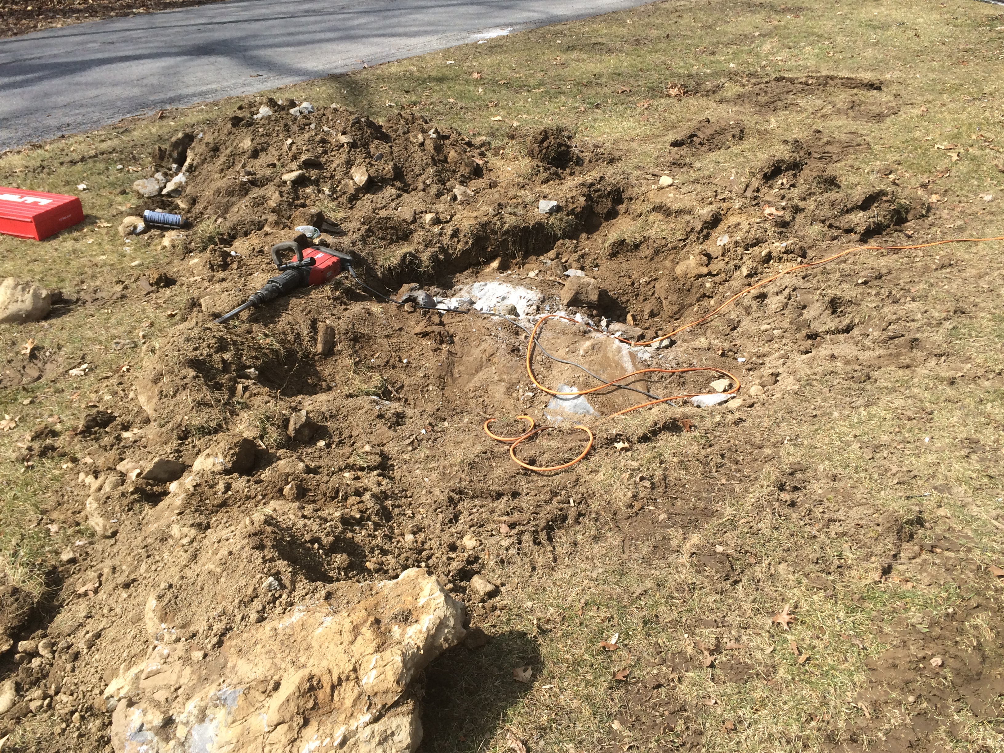

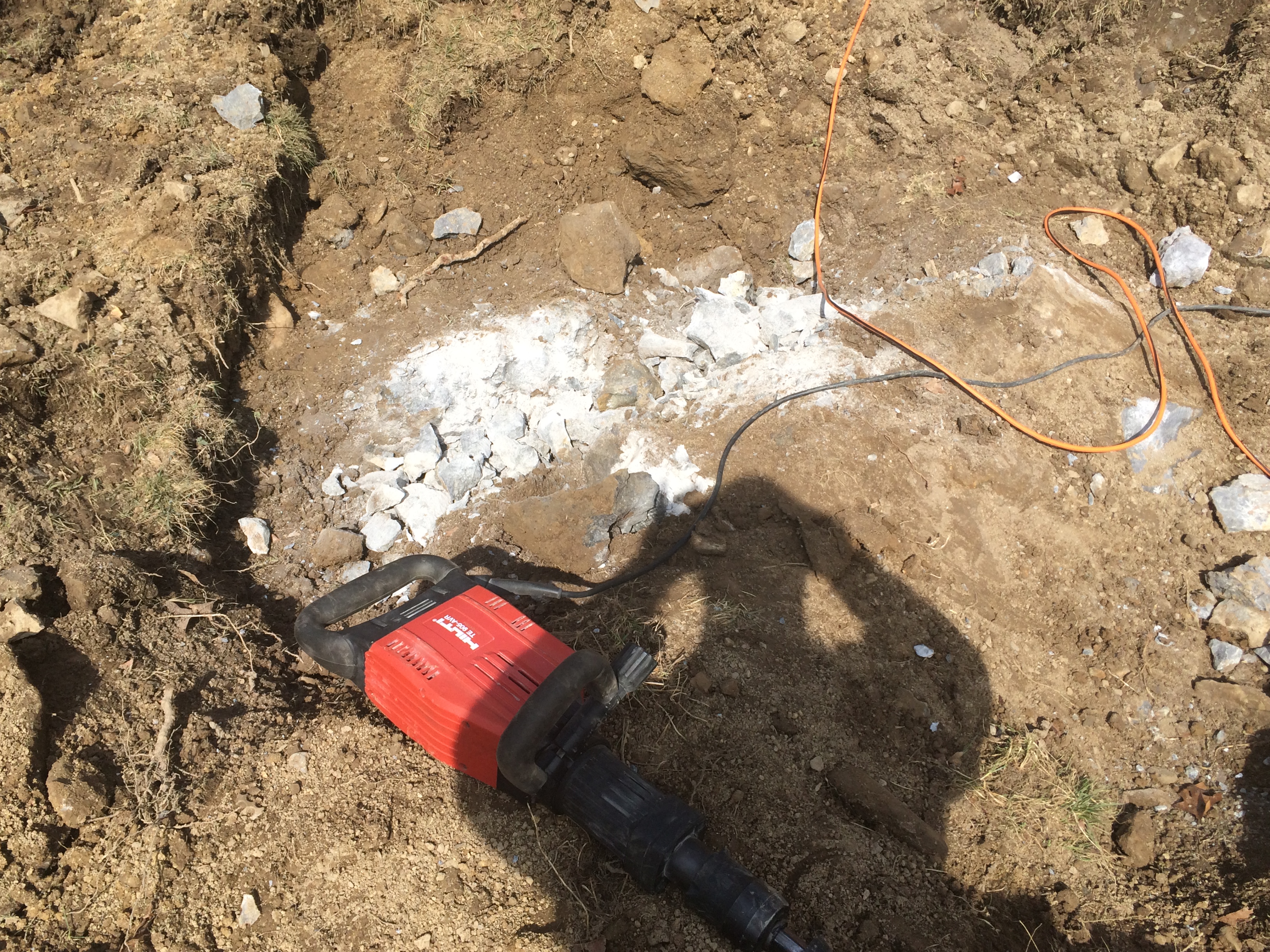

Well here are some pics of some excavating i did today. The backhoe def is way stronger then the fel, or at least i think it is. Im pretty impressed so far, but i do wish my front fel was alot stronger. Not sure what that rock weighs but I would of loved for it too pic it up.

O by the way the hole got a lot deeper.
