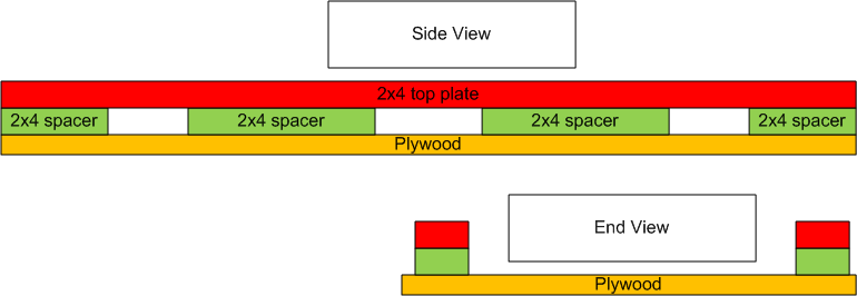

I'm sure the forklift could get something like that onto the 8' stack, but it could be difficult to remove at home. However I suspect I could come up with something more manageable to keep the straps from pinching and coming loose.
The up-side is that if I come up with a good fixture I'll be making this 2-pallet run every two months for the foreseeable future.
David

If nothing else, you could make a lid by screwing 2 2x4s to the top of the plywood with blocks to space them out and let the straps go underneath (as seen below, the 2x4s are red, the spacers are green and the plywood is orange) and use the "lid" to spread out the force of the straps.
Aaron Z
