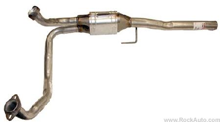

You said it doesn't have the "Tow/Haul" button but does it have the O/D Off button to stop it from shifting into overdrive?
I had an old Ford with the same lack of power feel and it turned out to be a bad torque converter. It felt like it was always in too high of a gear. If you can shut off the overdrive then it should stop locking the torque converter.
As far as the catalytic converter, just take off the tail pipe and clean out that cat with a broomstick. :thumbsup: :D

I really think the guys are on the right track with the Cat. I would start by checking it first.
