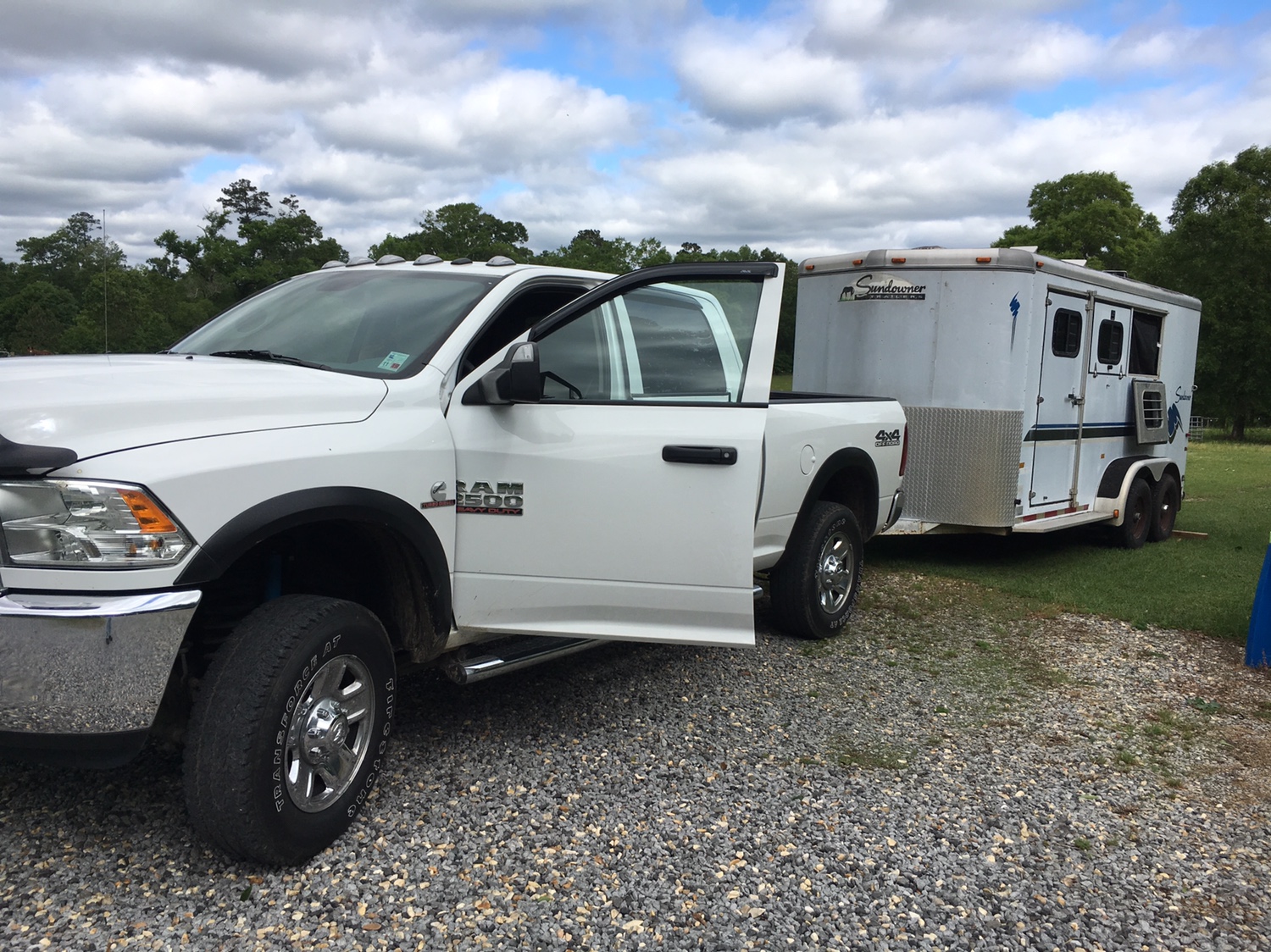

We bought this 18 Ram used for 39k with 16k miles. Leather, 4wd, Cummins. Pulls our 3 horse loaded fine. Also pulls my gooseneck with tractor and implement, which weighs around 9k lbs not counting trailer, fine. I would recommend a diesel for your weights strictly based on power and efficiency, not to mention durability. We have 48k miles on ours now, good truck, no complaints.
