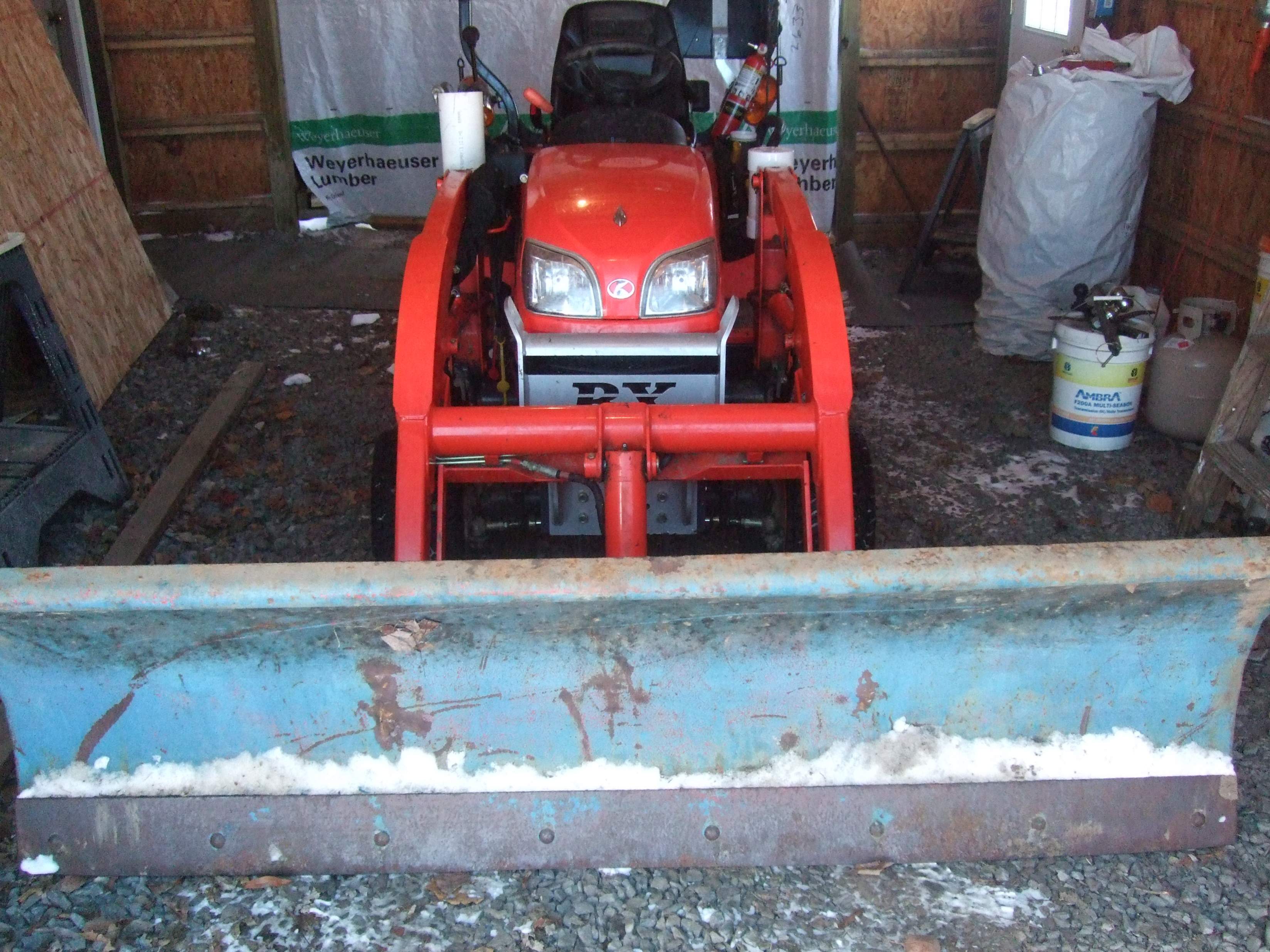

I am in a process of converting a old, beat up truck plow that needs alot of work to my BX. Last winter I was able to obtain a free truck plow from my uncle. I needed to use it right away so I made a quick modification. I took the A frame off the plow and pinned the plow straight to the fel arms after removing the bucket. This worked for the winter, but it acted like a dozer blade. I had to be extra careful with the lawn, couldn't use float over lawn area, only on blacktop. After a couple lawn scalping, I vowed I would make it better this summer. So Basically I did. First step was put the A frame back on and modify it so I could use the trip springs and angle it. These pictures are the "before" pics before modifications that is acting like a dozer blade last winter. Basically I am looking for advice here on my welding skills and metal fabrication. I do not have much to work with, just a simple hobart ez handler wire feed and a handheld grinder, sears battery operated reciprocating saw for cutting metal. I plan on using silver and deming drill bits from harbor freight for drilling my large holes for pinning.

I fabed a 84" meyer plow to the front of my JD3720. I still have the angle function. Your BX is going to have a difficult time in wet or deep snow due to the size of the blade. Give it a try. you may have to cut the blade narrower. Still beats a shovel!
   / truck plow on a BX #3
I say look at the bright side .... If your local snowfalls turn out to be too much, its not a big deal to "shorten" the blade!
   / truck plow on a BX #4
I would agree with the previous poster's,most likly will be to much to handle in wet snow.ON my Bx I made the kubota blade larger 68" and in 6" of wet snow it will push you sideways if you have the blade turned to either side. With dry snow No problem it will move plenty of snow.
   / truck plow on a BX #5
modified a truck plow for my brother in law on his bx 24 but I welded bar stock into the back of the bucket vertically and placed the pin holes high enough so he had 4'' of float on the snowblade with 2'' of clearance under the buckets front edge when lowered, he rolls the bucket back to raise and lower the plow and there is still enough room to angle the blade he has used it for one winter so far no problems (keep in mind my brother in law can destroy an anvil with a rubber mallet) if I catch him at home I will get some pictures for you

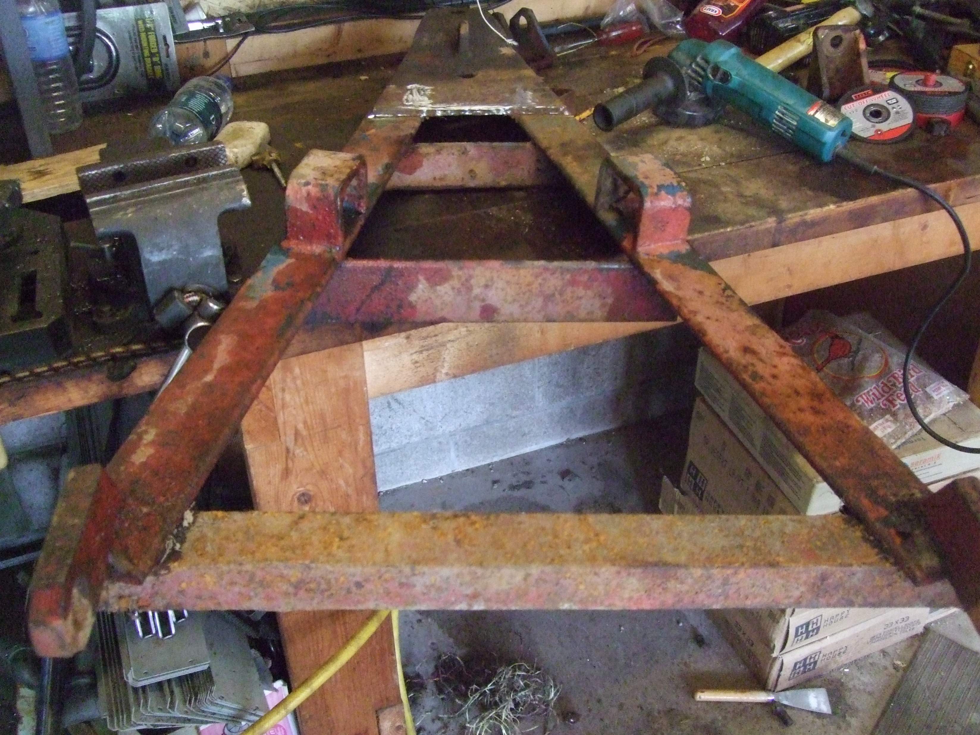

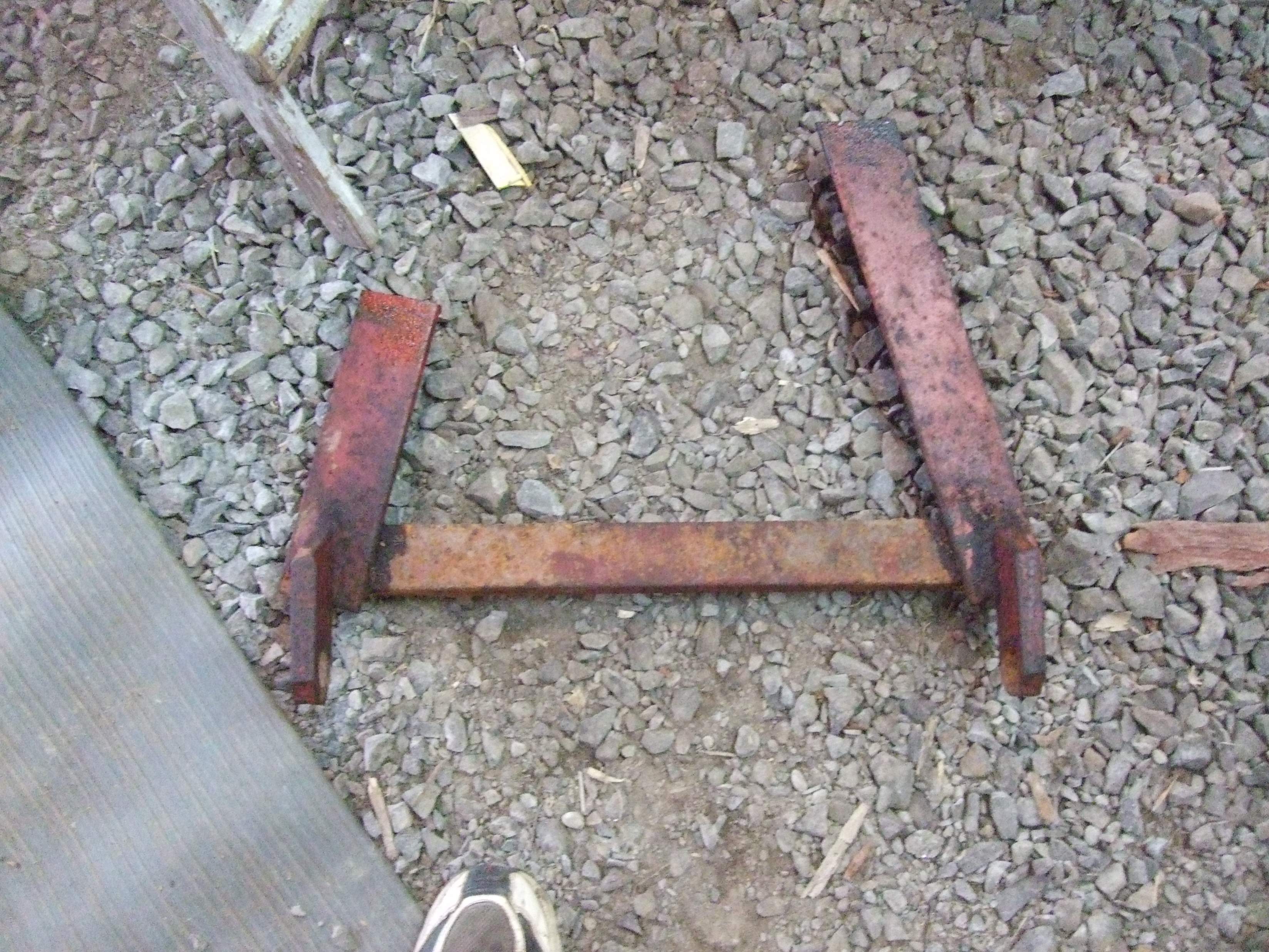

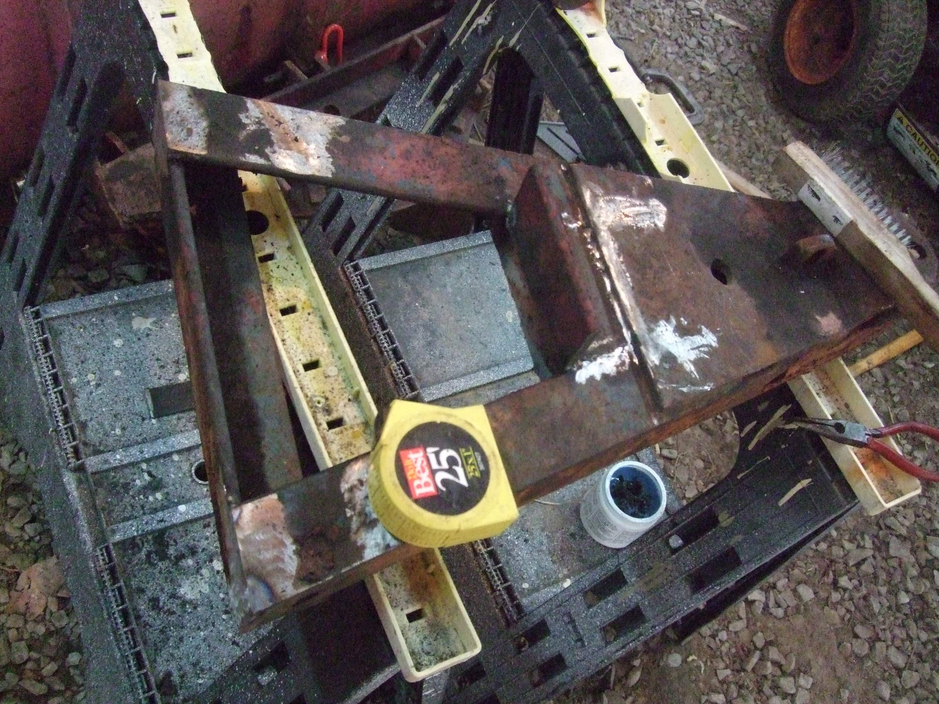

Here is what I have done so far for fabbing. Took the A frame, cut all the unnesscary parts off. I was quite surprised aboutr how much wieght i saved doing it like that. I also shorten the back of the A frame so its nearly a foot shorter. I realized due to the single acting cylinders were shot , I didnt want to cut it too short in case I can't find a shorter double acting cyclinders.
