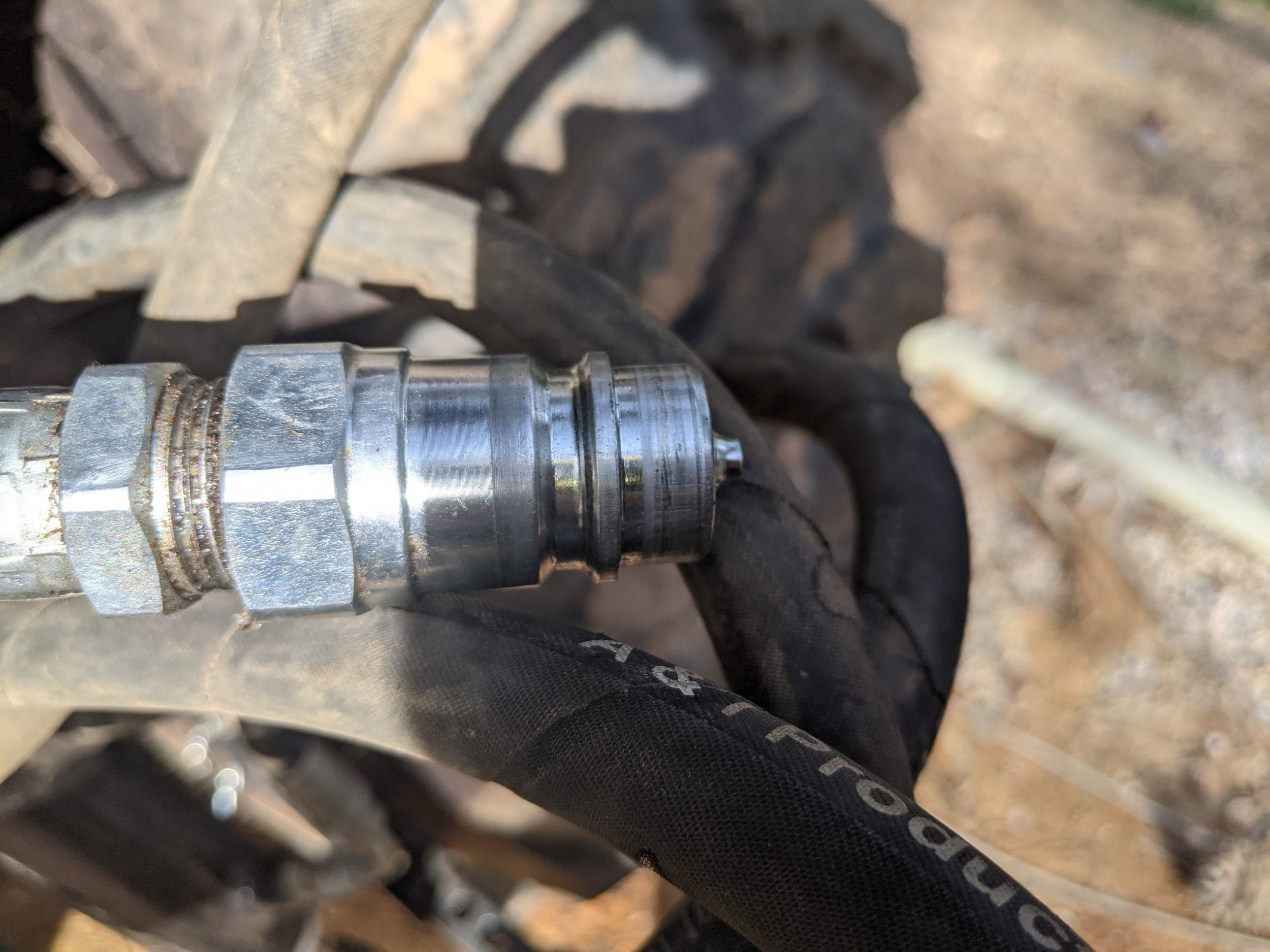

The backhoe connector looks like this (1/2" Ag 4000 type, 98% confidence):

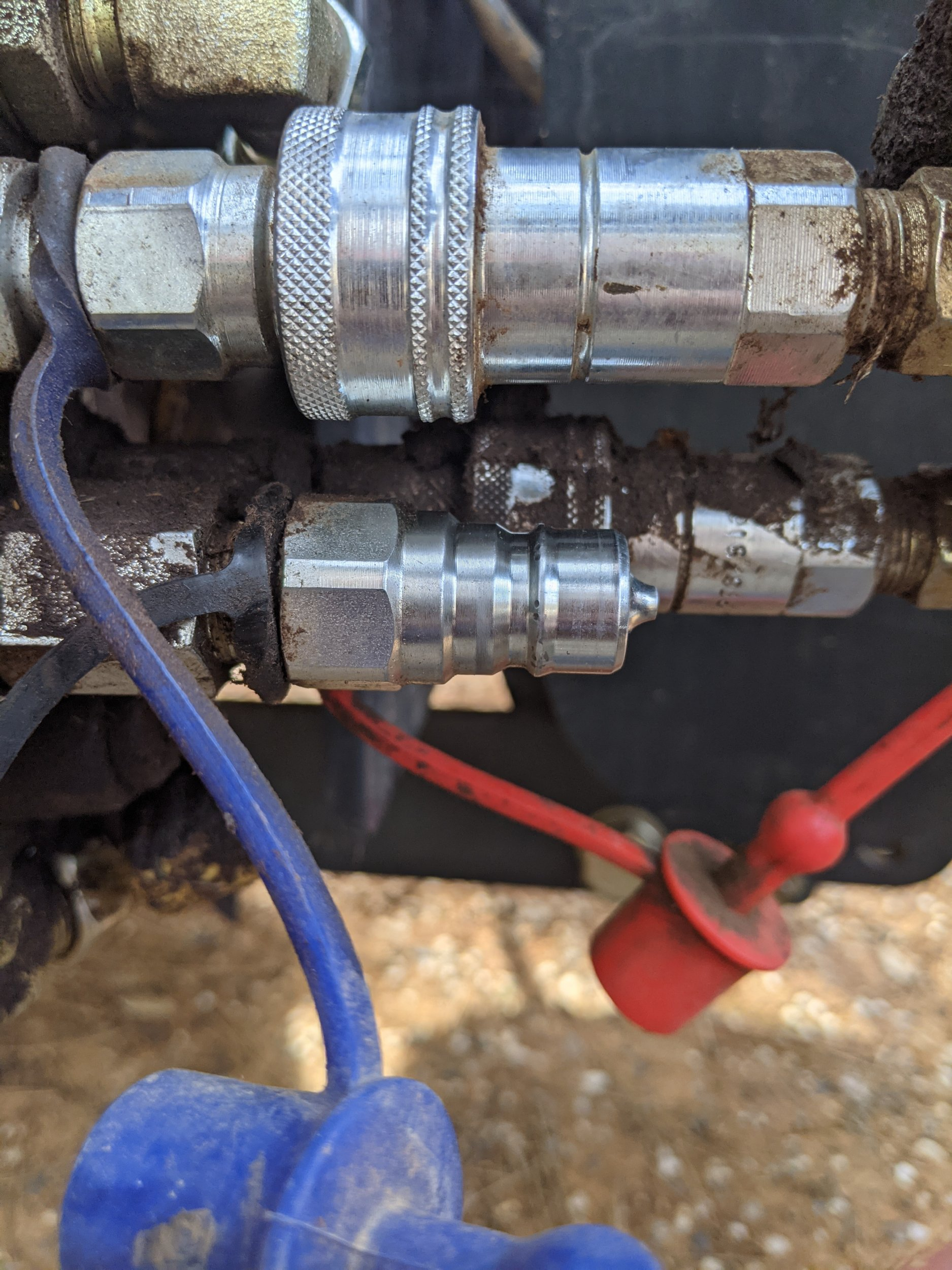

The TnT connectors have the same profile, though a ball on them (pretty sure the Ag 4000 will work):

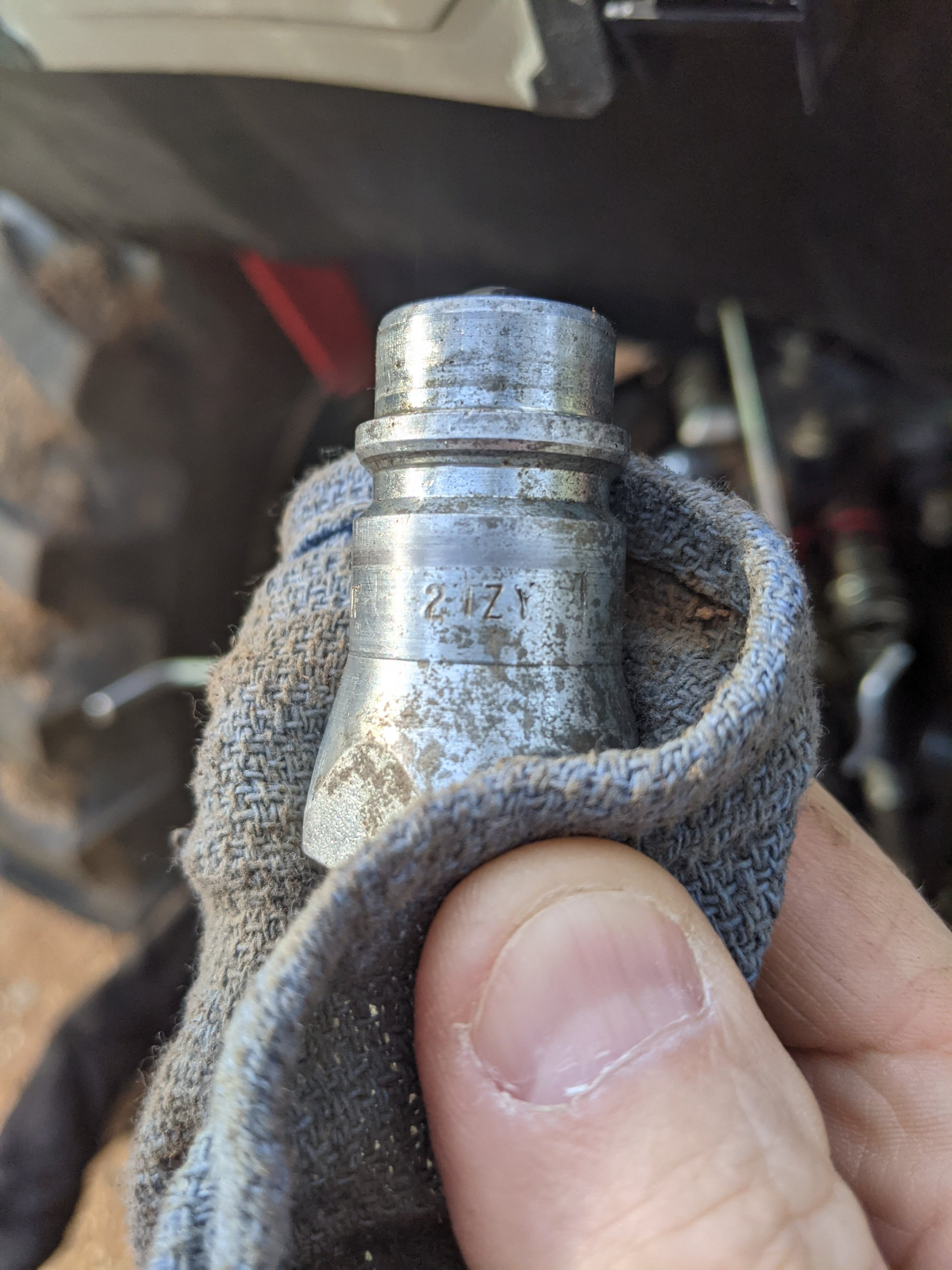

The big question is the FEL connectors:
The pipe connection looks like 3/8", and my guess (50% confidence) is that these are 3/8" '600 Series' connectors from the profile.
My 3/8" pioneer 4000 type male end didn't go into the female at all - too large of a diameter by just a bit.
Does anyone know for sure what they used here? The markings on the female connector (FEL end) don't look too useful to me, perhaps someone else will recognize - QC PT3/8 16F.

Comparing profiles and sizes it appears that the FEL connector is "ISO 7241-1 Series A" 3/8"
(parker 6600 series).
The TnT connector profile is that of the "Ag 4000", while the backhoe has the same profile as the above ISO (parker 6600).
Both of those have the same diameter and front part (other than ball vs pointer) in the 1/2" and I'm told they're interchangeable (?) - but those two styles are 1.5mm diameter different in the 3/8 so definitely not in that size.
