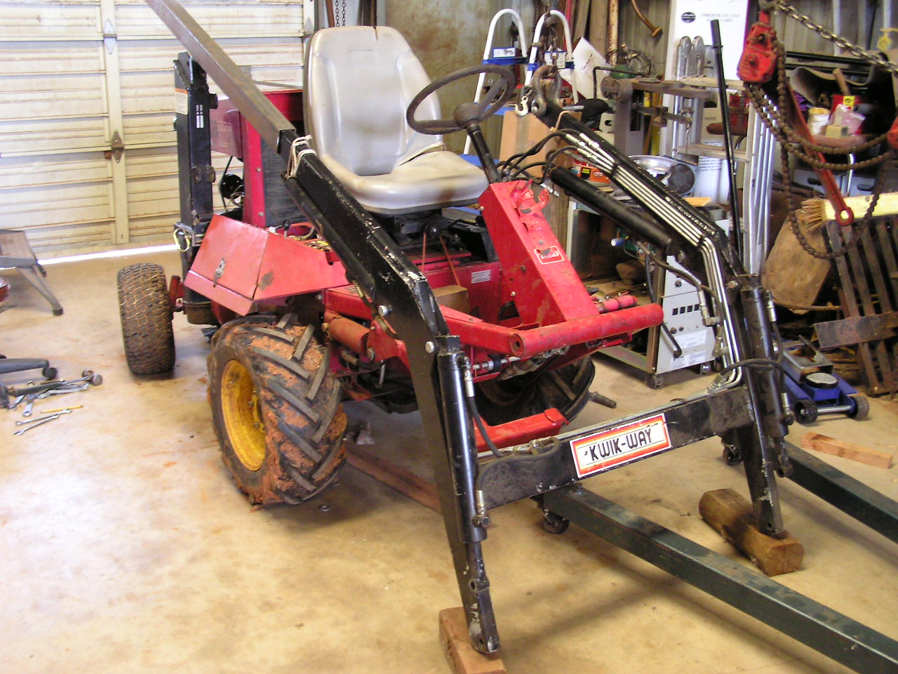

I'm in the process of building a front end loader for my cub cadet. Got the plans from P.F. Engineering. Their plans call for hoses all down the boom for the cylinders, but I would like to use a tubing along the boom and branch off with the hoses for the cylinders. Does anyone know what type tubing I should use and a good place to purchase it. Thankful for any info. Jeff.

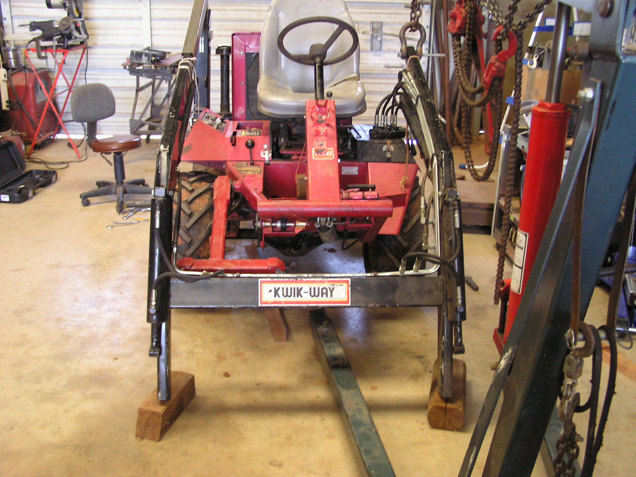

I am guessing that you don't have the special tools to bend and flare hydraulic tubing and crimp connectors to hoses.
My loader came with the tubing, so when I finished the put-together, I took it to a hydraulic shop and they made the hoses that hook to the tubing.
I recommend that you make some type of quick connect system for the attachments. Look at my thread and you will see why I wish that I had done it before I made my pin on attachments. http://www.tractorbynet.com/forums/customization/272163-fel-toro-groundsmaster-put-together.html
